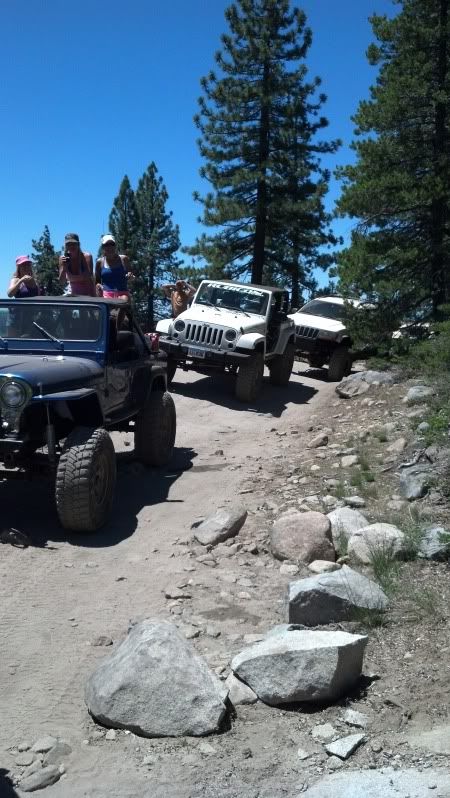

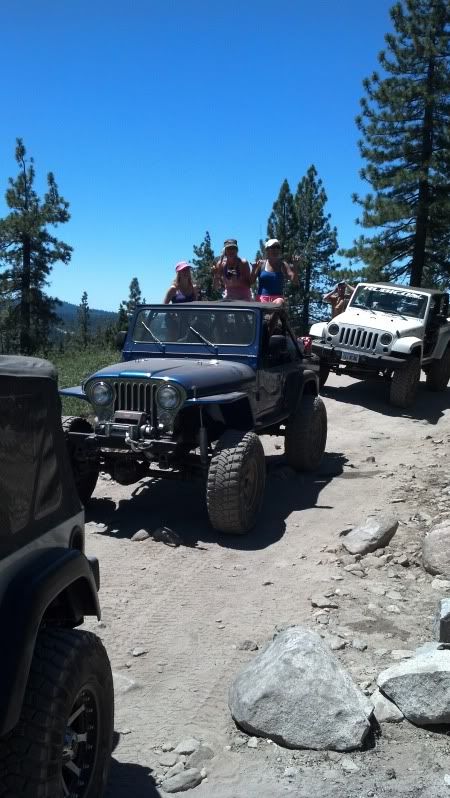

Just past Cadillac hill, some tj bent a tie rod and held up the line for about a half hour. Girls were partying on the scrambler. High lift handle later, guy was on his way.
Out look to the left of little sluice.

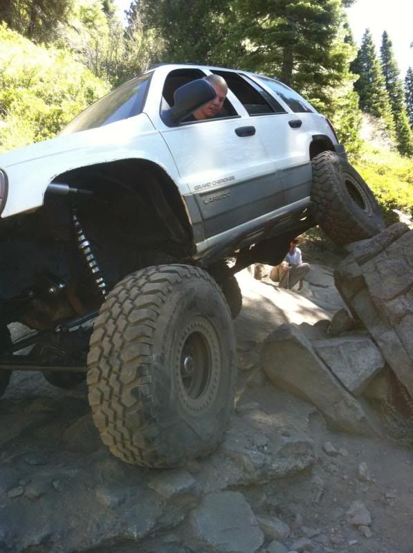

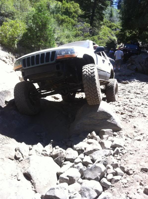

99 WJ hp44, 3 link, Eaton e locker, 14" foa coilovers in the front. 14 bolt, 4 link, grizzly locker, 12" foa coilovers in the rear. 5.38s and 37s

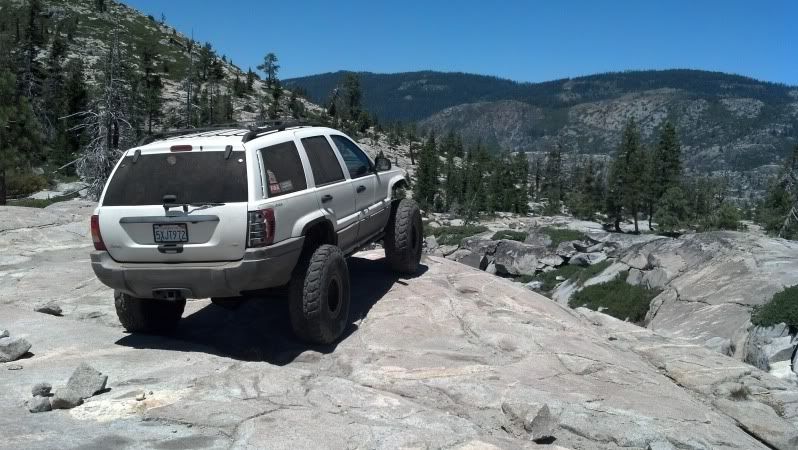

Posts: 1,541

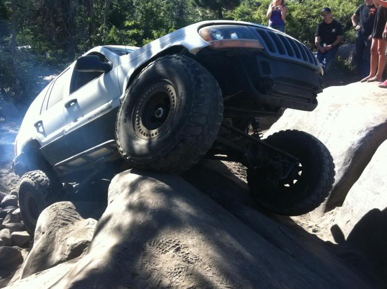

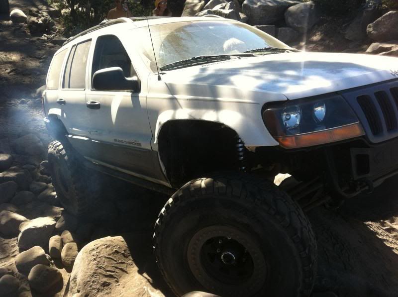

From soup bowl. Got denied.
This picture should look pretty familiar to Greg. Hahah.

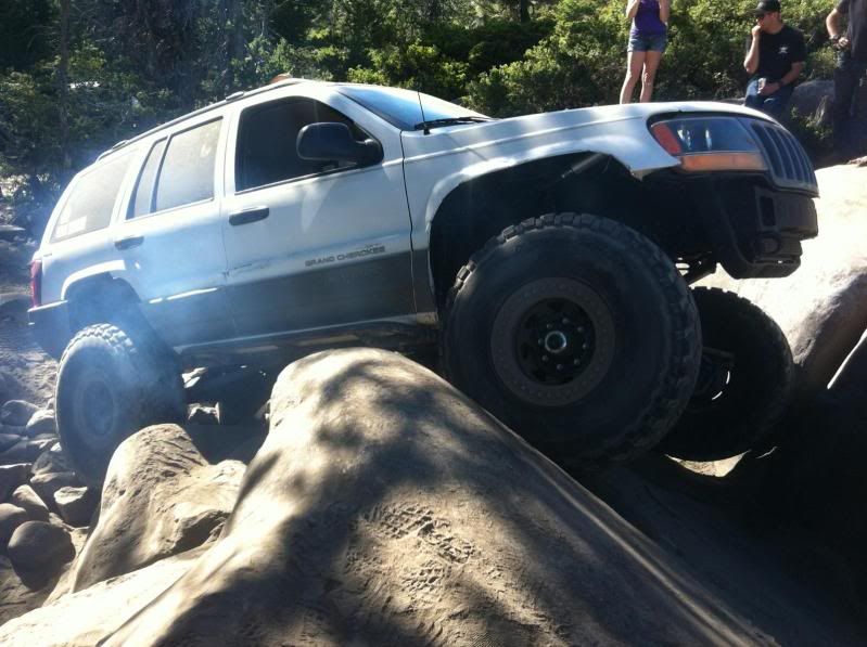

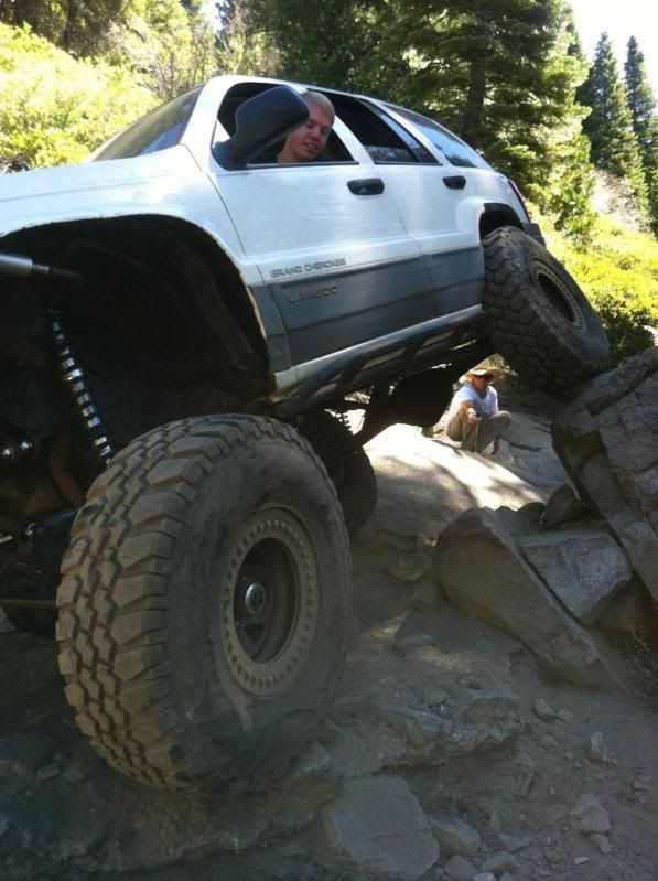

On the first obstacle on post 685, did you come down on your sliders at all? Awesome pics, you have some serious travel with those coilovers.

I don't think I did.
Soup bowl I was slamming on them pretty hard. And used them to slide around some rocks. But the kick out on the didn't save me around one tight turn. Tree hit drivers rear door and rear quarter panel. Not bad at all.
I only rubbed at the very bottom front of my front fenders and a little on the coilover reservoir hoses. And in the back I was somehow grabbing the right rear door cladding and pulling it off. I may just need to adjust that side out a few turns.
