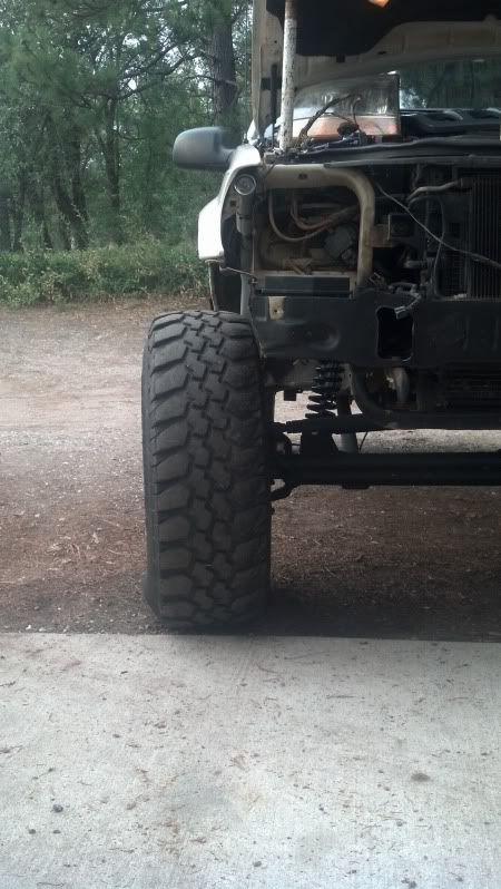

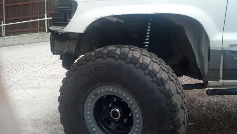

I've got some updates. Been working on the jeep after work the past 2 days.
Replaced both o2 sensors. Front and rear gear oil. Rear might have to get flushed again soon. Front looked good. Adjusted the rest upper control arms to fix my pinion angle. Might have extended them and inch or so. And I've been cutting the front under the head lights. Drivers side mostly done. Gunna have to rework an evap thing under the drivers head light.
It looks close. There is 6 inches of shock showing, and there is almost 7 inches from the tire to the head light bucket at full lock right. I'll have to cut the passenger side and flex it to see if I need to cut more, or ditch the stock head lights and get some hid driving lights and have Greg fab up some lights mounts with the factory grill.
OK, enough talk, pictures...
Drivers side cut
Drivers side without the plastic front clip.
Passenger side not cut too much.

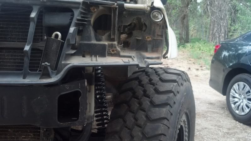

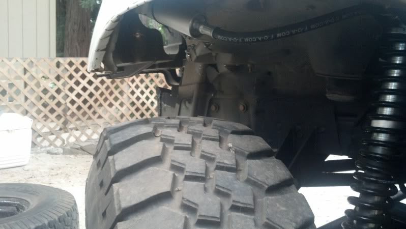

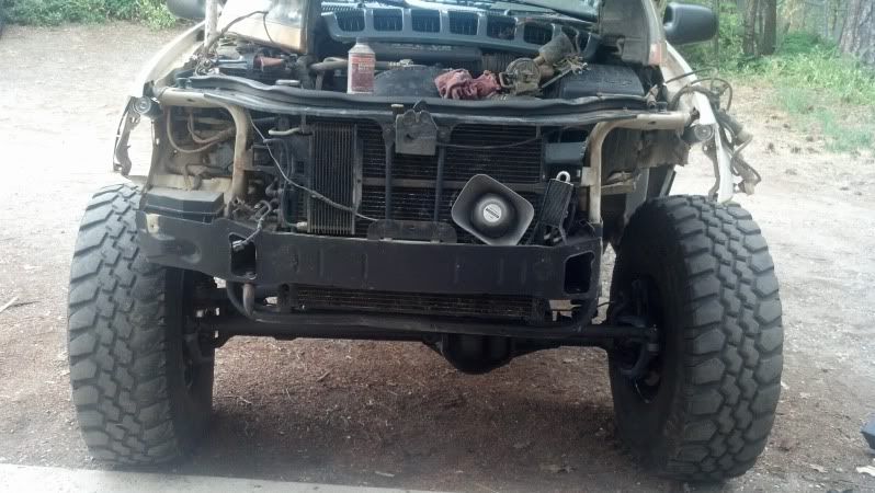

Clearance from the backside.
From the front
From the side
