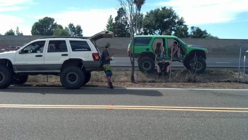

Hahah. I have had since Saturday, but.....
And this time its not my Jeep! We took my buddies 4runner Saturday to get my jeep. On the way back, the rear pinion bearing seized and locked up the tires at freeway speed on highway 80. I was behind him and saw the whole thing. Managed to get on the shoulder and slid sideways for about 200 feet. It could have been REALLY bad, especially with no doors, a dog, and a ton of snap on tools in the back.
We were on the side of the freeway for about 2 hours. And got towed by a ford :-( but it all worked out.
