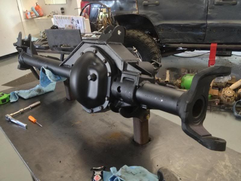

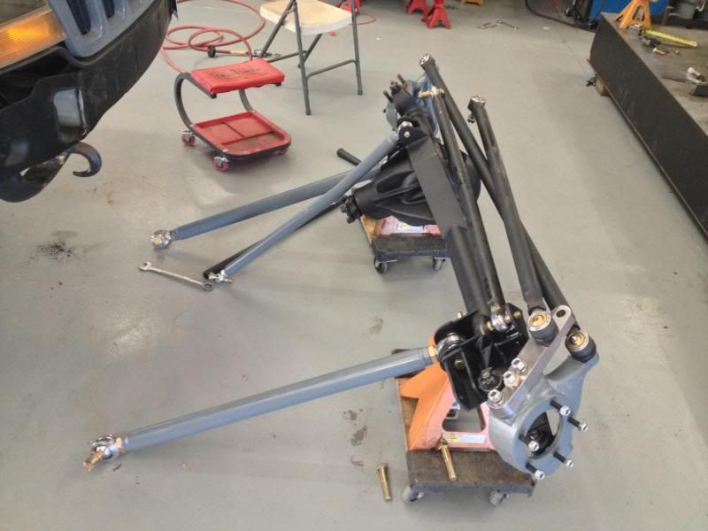

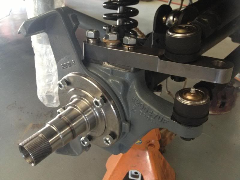

Fronts built.
Axle painted.
No more frame jack stands. On its weight. Front end needs to be finished up with the outers. 7 up and 7 down.
Brand new spindles.

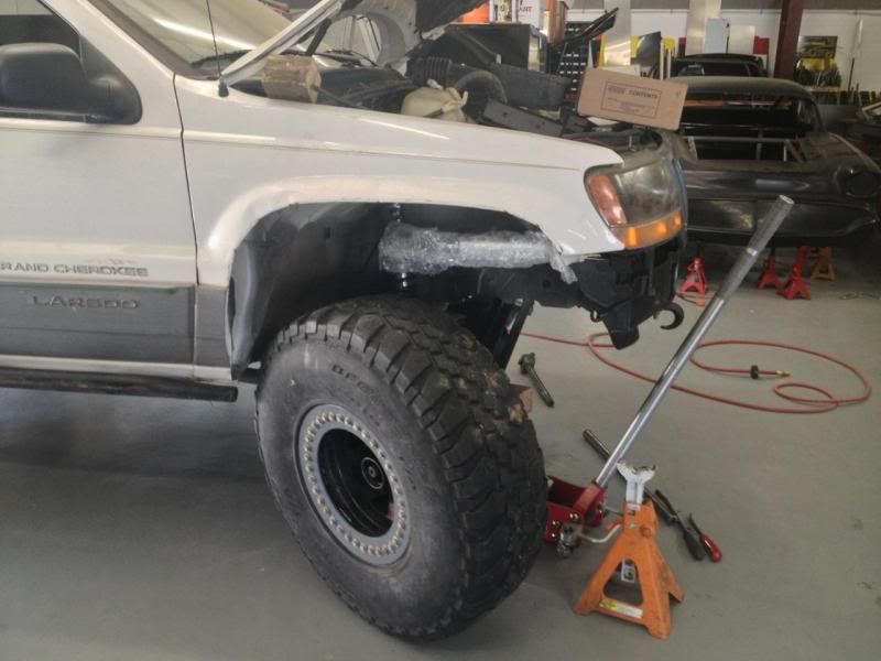

It's really not that tall the tires measure 36.5" and there is about 6.5" from the top of the tire to rear fender. Haven't had the front tire on to measure yet.
All new parts look pretty not, but I really really want to wheel it.

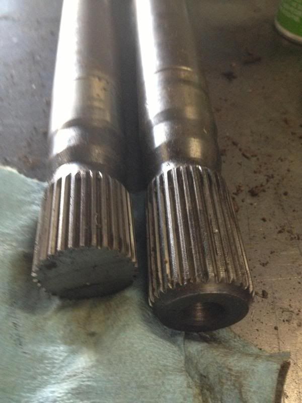

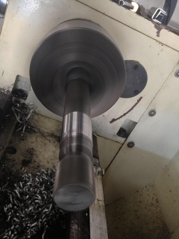

Had another slip up with the front axle. Apparently the long side axle shaft Had broken at one time, and they replaced it with a shaft that was too long and cut the end of the splines to make it work. Well the new inner seal wasn't allowing the shaft to slide into the carrier. Greg worked his magic and extended the sealing surface to make it work. Looks like I'll need chromos sooner than later.

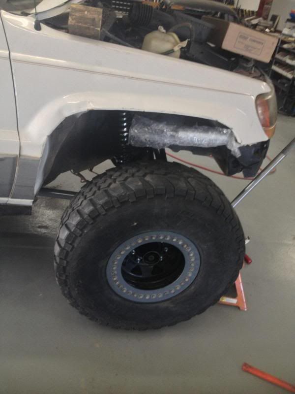

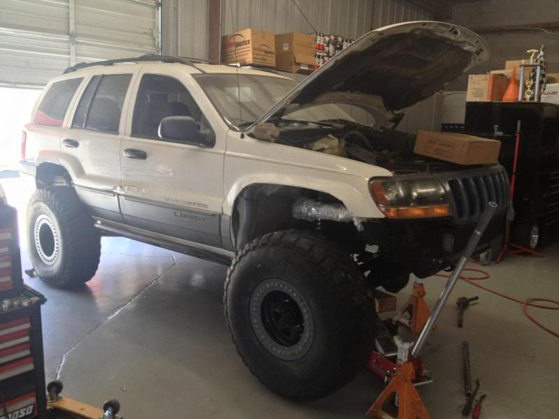

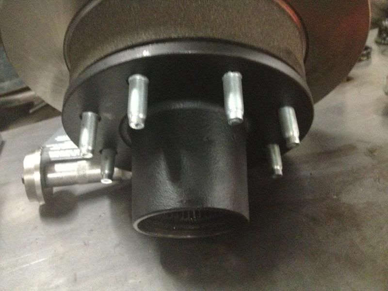

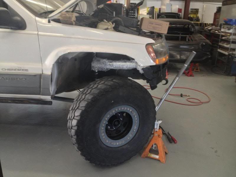

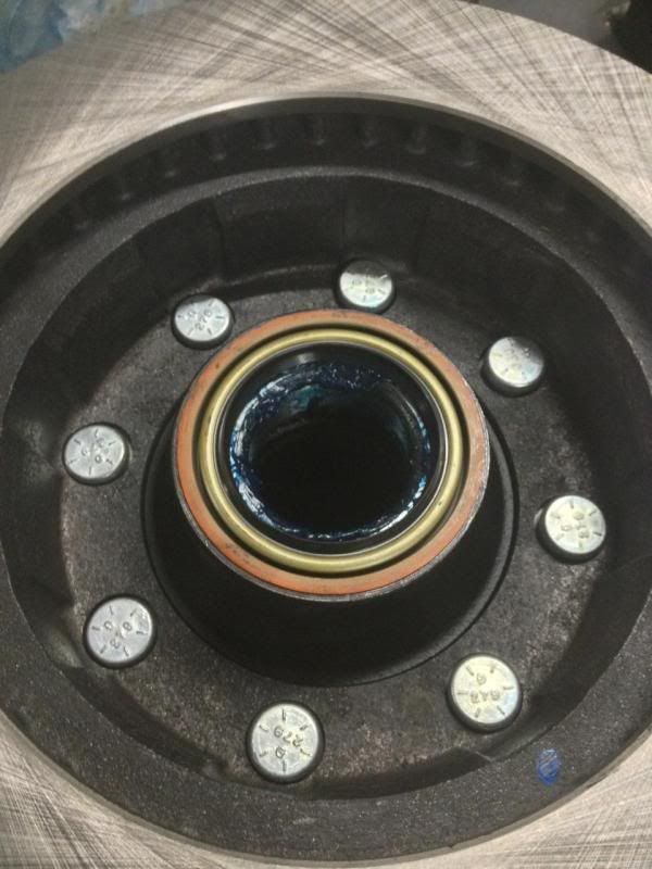

Studs installed
Full lock right.
Full lock left.
Money shot!!!
