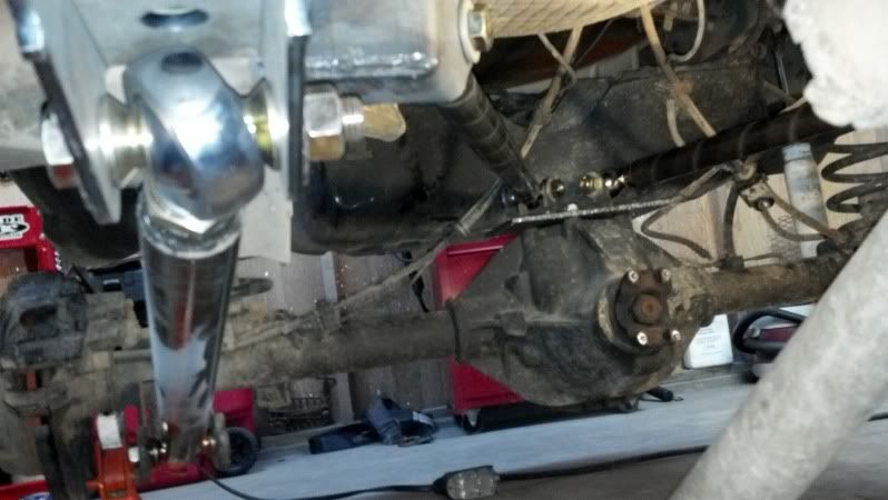

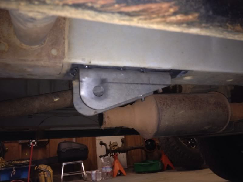

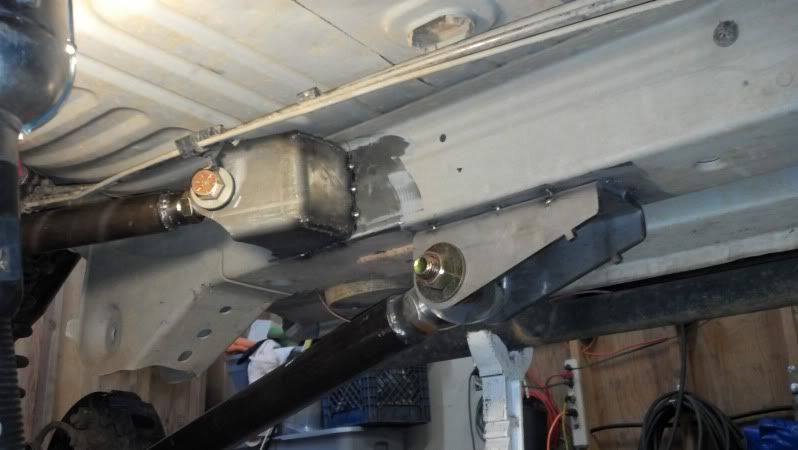

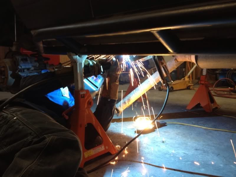

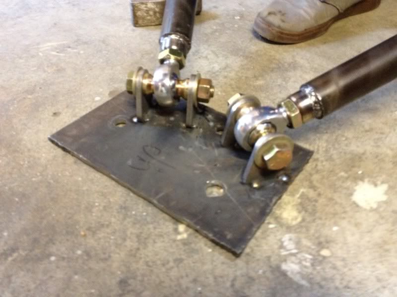

So we spent 12 hours yesterday building and install long arms in the rear. It's a triangulated 4 link. Marc can add more pictures if he wants.

Lower arms build and welded. Lower arms are ruff stuff 1/14" heims. Lower I think are the 3/4".
Upper mount tack welded. Bracket from Balistic Fab.
D44 link mounts with plate.
Just some welding.
Upper and lower mounts fully welded.
The final result.

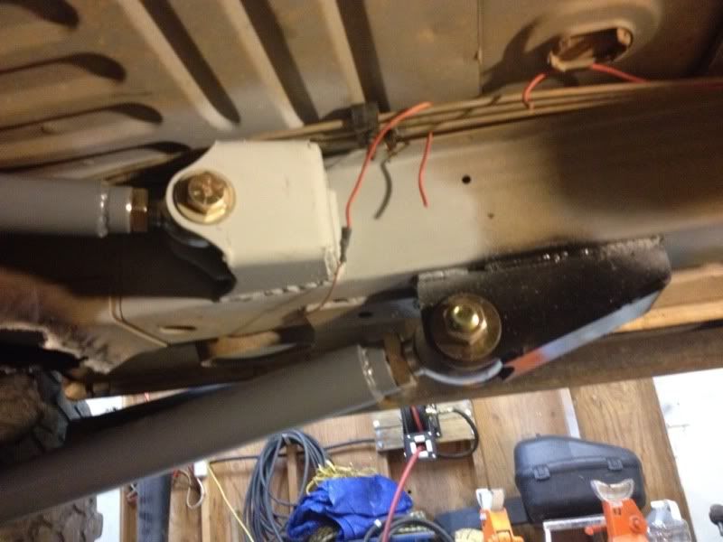

Just went out and snapped these pictures....

I saw these pics last night . Lookin awesome man! One thing I highly recommend, do something to plate the frame rail and connect the two mounts to each other. It'll help keep the unibody strong for years to come haha. Feel the wrath of my paint skills!

Greg cut us that plate and I'll weld her in! Marx your gonna have to make a template

Ill make a template and get it to you asap. Heading to the Rubicon in like 2 weeks so strong is always better.
That's one thing I really wanted to do, is plate the unibody.
The road noise definitely increased with hard joints on all ends. I think im getting a little noise from the drive shaft, luckily the uppers make it easy to mess with the linking angle.
