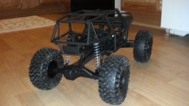

so i caved last week... and bought this for myself. axial wraith kit...
15 hours later and i get this, everything minus the body panels and electronics

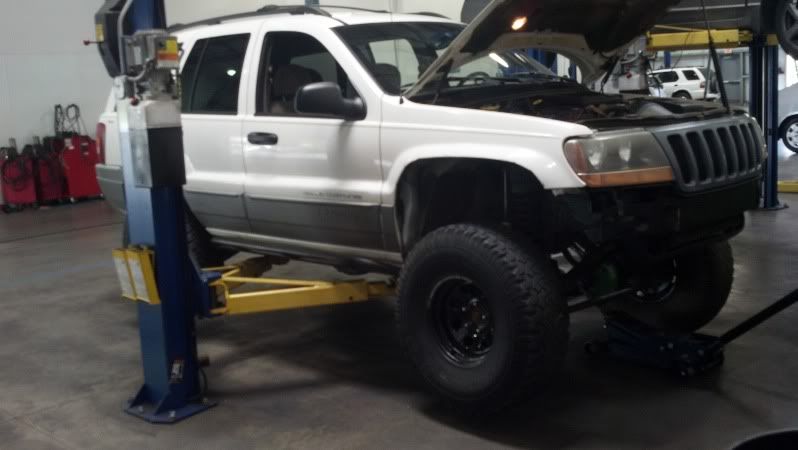

and then at work today, i measured everything up for the coilover and long arm build. pictures of maybe projected ride height..
at this height, it looks like 40s are gunna do the trick. this is with 5 inches of down travel and 9 inches up travel in the front. the front drivers tire was mostly on the ground. rear tires not even close. ha. ill have to post up the numbers ive come up with within the next few days. its my birthday tomorrow so i see myself babying a hang over. hahahah
and the heims fit nice and snug on the axle side with the iro brass spacers on both sides. just in case anyone is going to build long arms with ruffstuff 1.25 inch heims anytime soon.

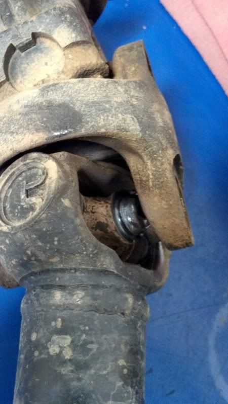

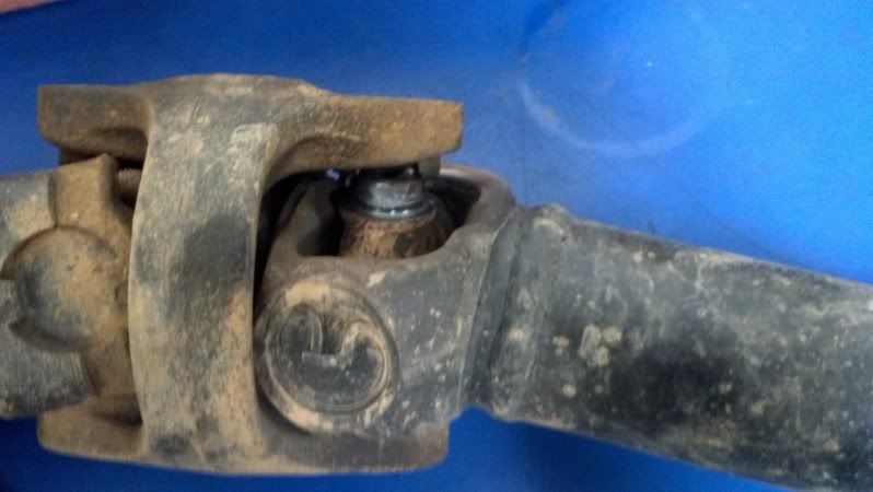

Found this...
2 ears destroyed. It caused some nasty drive line vibes. I really don't know how it happened, that's the worst part. I have wheeled in a few months.
