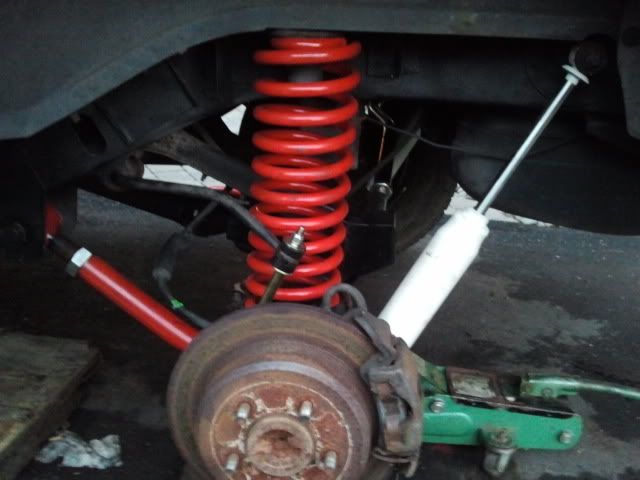

Did some work after rain. I installed my jks quick disco and did my drive side lca and sway link. So it.looks kinda funny as my axle is cockeyed. Pics

Finished it up.
I set my rear lca to 17.5 still looks like it needs to.go longer or is that fine. Im on.stock.rear uppers.

And from reading the lowers sets the tire in the wheel well and the uppers set you pinion angle for the diff, I would imagine at that height without the correct adjustment your rear seal will last 5 days before leaking. Mines doing it a 3.25. I was not leaking before i lifted mine.

So I need rear uppers.

My rear is sagging because I have 3 tires and rim and a bull bar in the back lol.

unless that crap weighs 200 pounds (which i highly doubt) u need some pucks for the rear.
