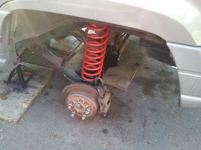

post #19 of 416 Old 08-02-2011, 07:58 PM Thread Starter
MStaffin
Location: Kendall Park
Posts: 2,187
Just to see how high the zj is compared to the WJ. The back of the zj is level on jack stands in the back. so heres a pic. Wj has a 2.25 spacer and UC. With 31s

MStaffin
Posts: 2,187
Thats the V8 F>R swap
