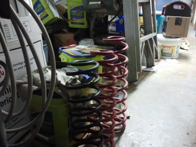

The V6 MJ coils will give you same height. Didnt know. They looked about same maybe little taller but they are rated for more than the I6 ones. "Just a note for anyone."
Here Stock I6. XJ 2.5in then MJ V6 4in.

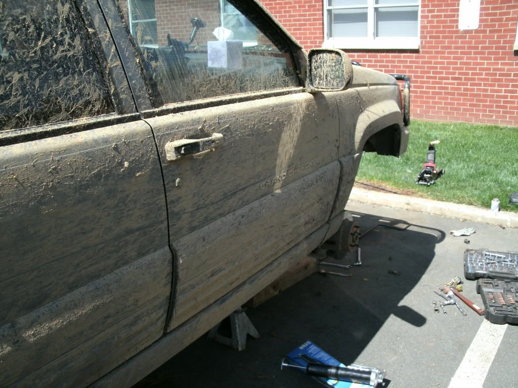

it looks too clean.......needs to look like this

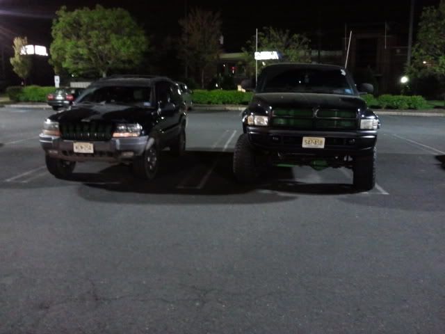

Hell ya. Muddy. Ok come to my house with a dump truck and throw some mud on it haha. Oh just bought this trailer.
