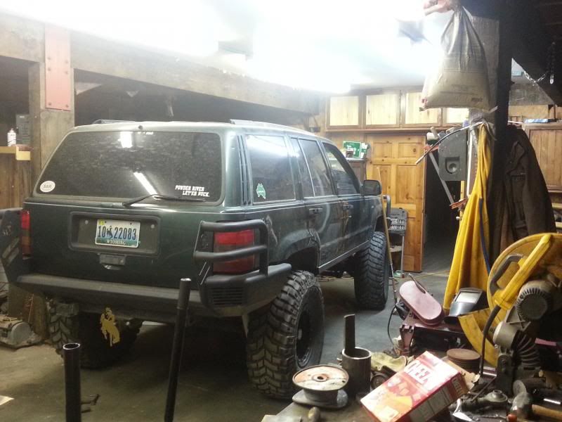

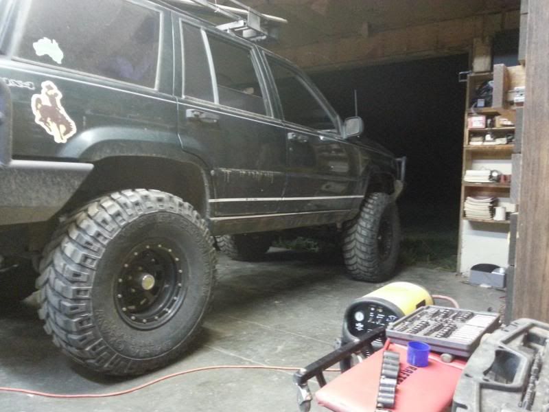

Current picture, not a very good one. Ordering steel today for boatsides and rear 4 link and x-member

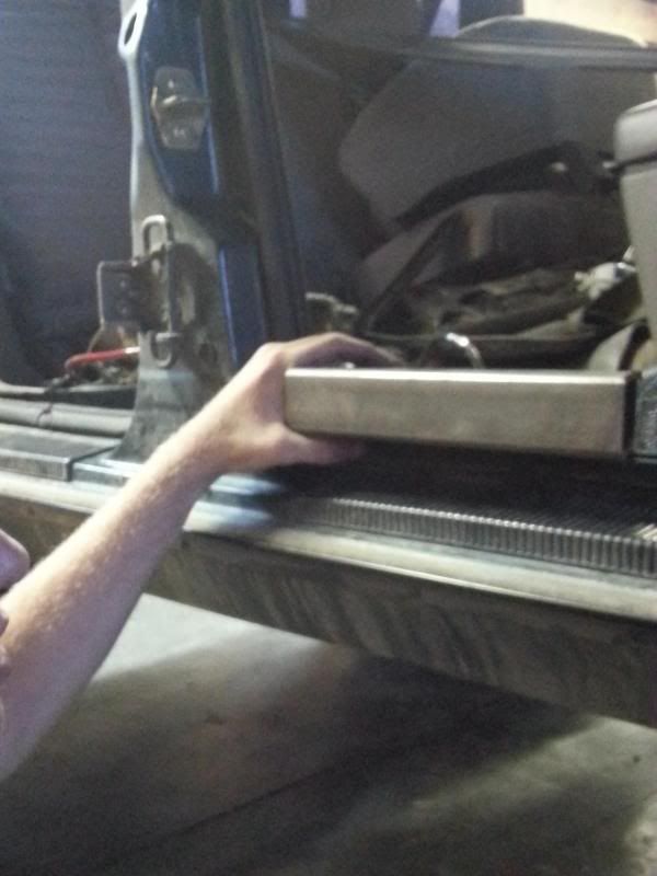

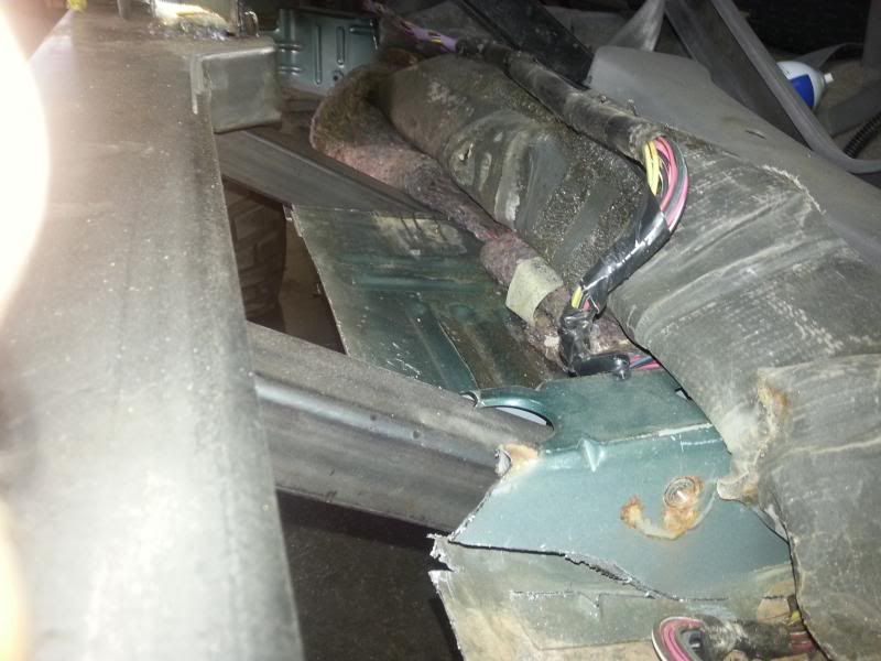

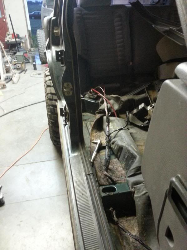

Got started on the boatsides last night. Figured I would start there on the list since it will be the most time consuming and cheapest material wise. Then I can knock out some of the other stuff once I sell off my bumpers, roof rack, long arms, and track bar.
Stripped the interior on the passenger side (dirty as heck I know, been sitting outside all summer with no doors on). Also started a rear seat mod that will come into play later. I'm excited about it

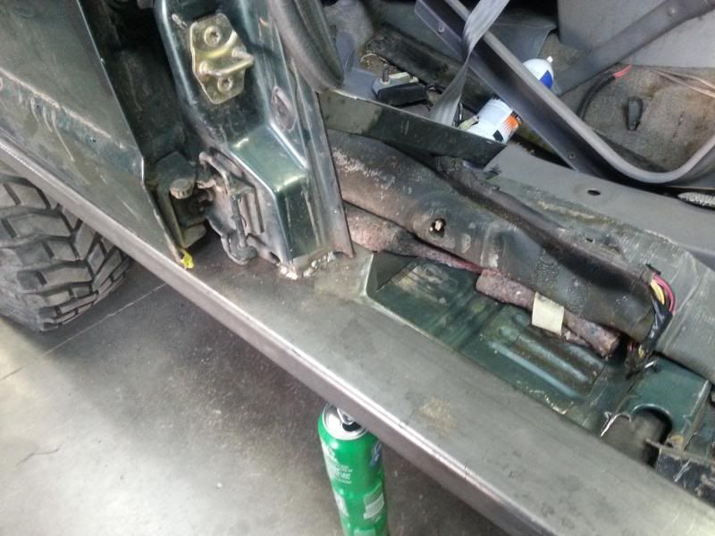

here is where the new rocker will sit
Put the doors back on and found the cut line. Think I'm going to keep the doors on while I cut to make the cut same on everything

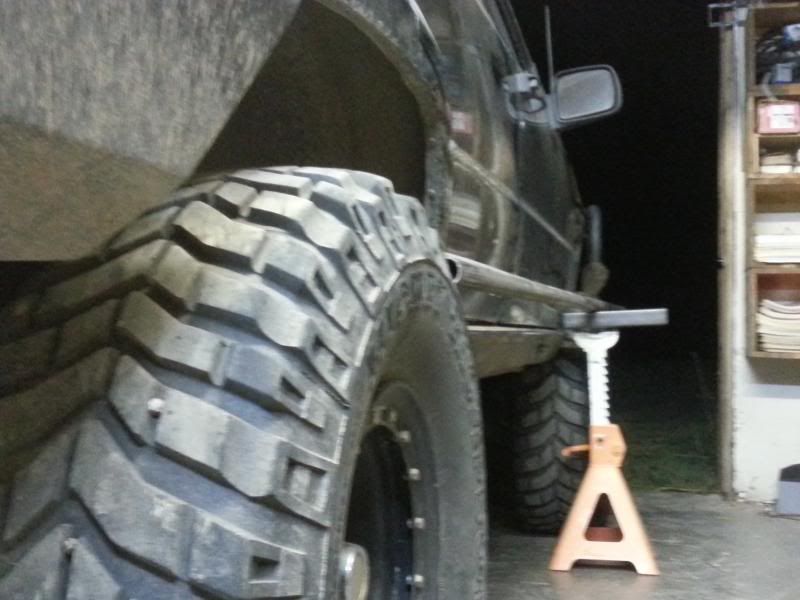

A tube propped up about where it will sit off the rocker.
Where I'll be cutting does take off some of where the seat belt mounts. Either going to move it up, or install a set of harnesses. Haven't quite decided yet but leaning towards getting my B-pillar done at the same time and attaching harnesses to it

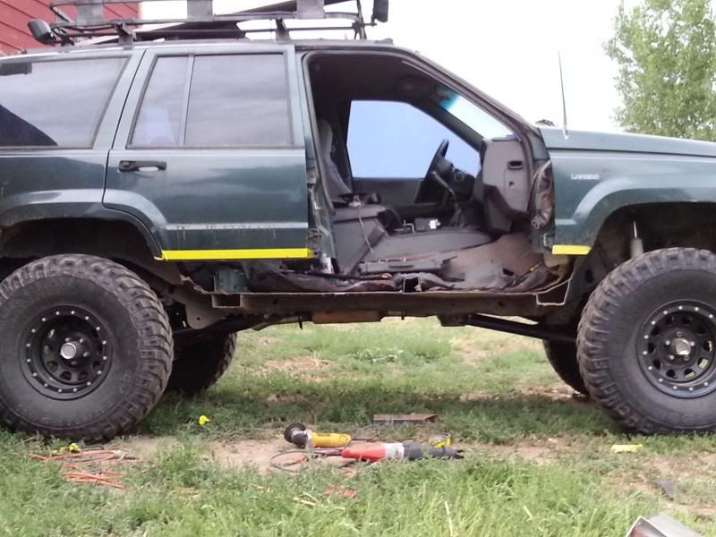

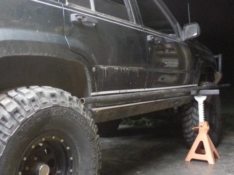

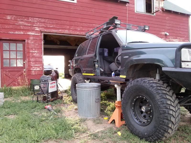

Chopped the passenger side last night:
Pretty big hole
box tube mocked up with a trash can for reference. Will have over 31" of clearance at the rocker when it's all said and done
Hard to tell the scale completely but they are gonna be HIGH

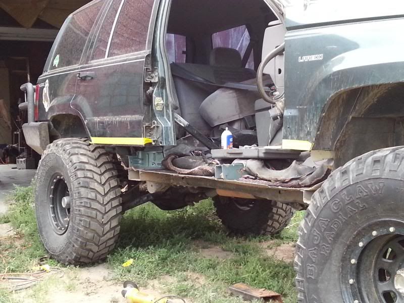

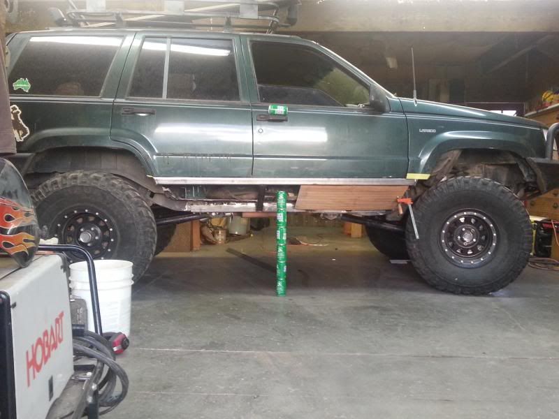

Little more progress last week
Have about 6.5 beers of clearance at the rocker
with a piece of wood clamped on to get an idea of the slope when the UHMW gets on

FINALLY got to do some work on the jeep for the first time in a couple weeks. Got the boatside about 95% done. Just need to cap the ends with some plate, make a few more welds on the floor, and add plastic. And yes, the cage will get tied into the b-pillar stanchion.
nuts welded to the plate
painted up
looks a bit like a Subaru outback from this angle
I didnt take pictures of it, but I did have to weld a small piece of angle and a nut to the b-pillar stanchion to keep use of the stock seatbelt, which will eventually get replaced by harnesses
