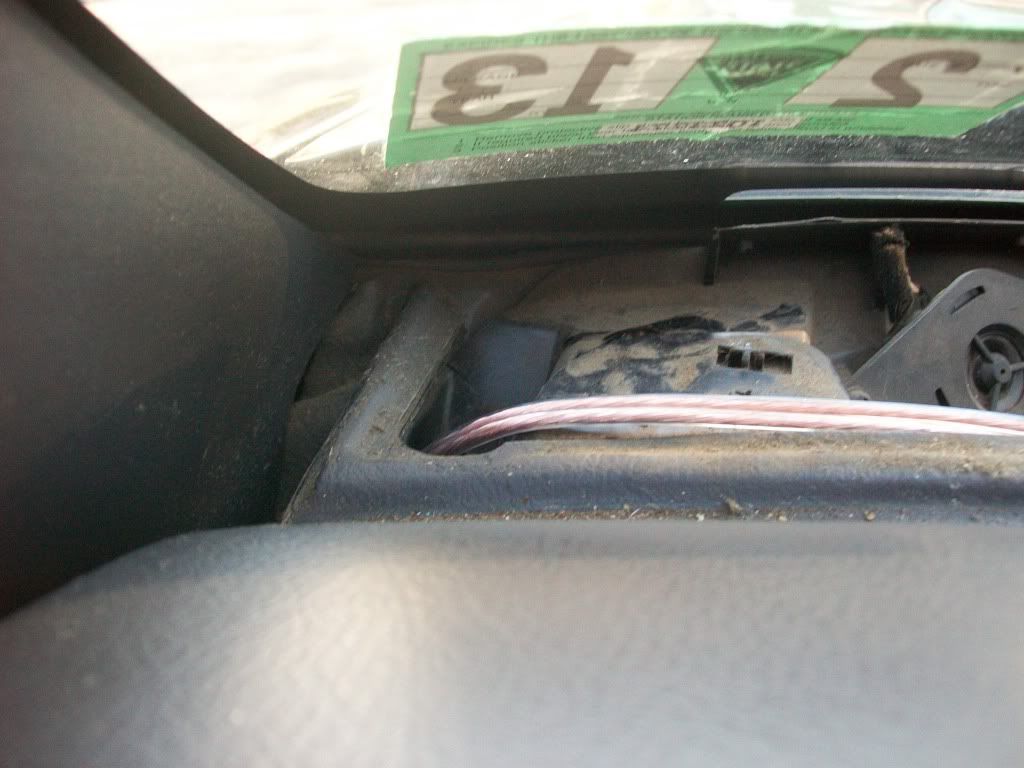

I also started running the wires for the Infinity Bypass.
I decided running the wires up through the dash was the least painful route. Forgive the road salt all over the windshield.

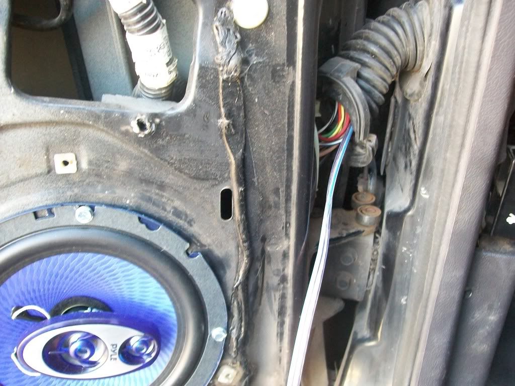

Down the little hole...

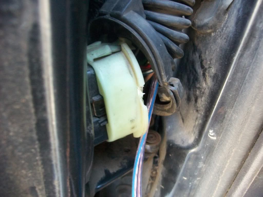

Through the boot.
I cut a little notch in the plastic insert that goes into the door for the wire to run through. Not my prettiest work, but the boot covers it up and still seals the hole.
