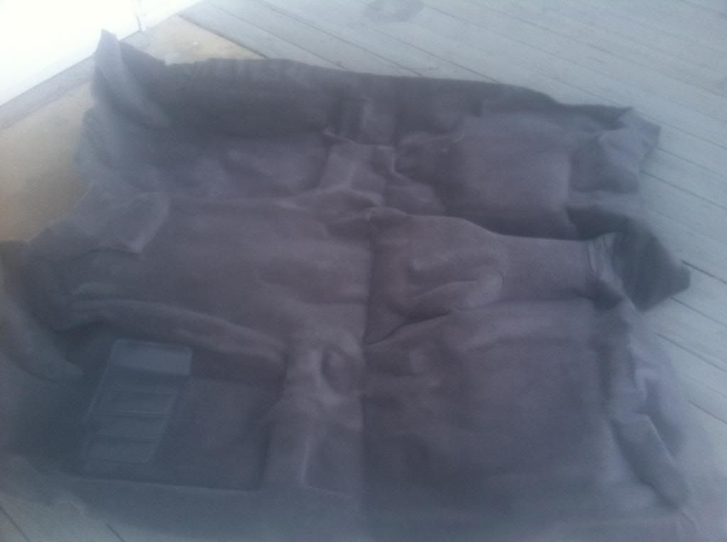

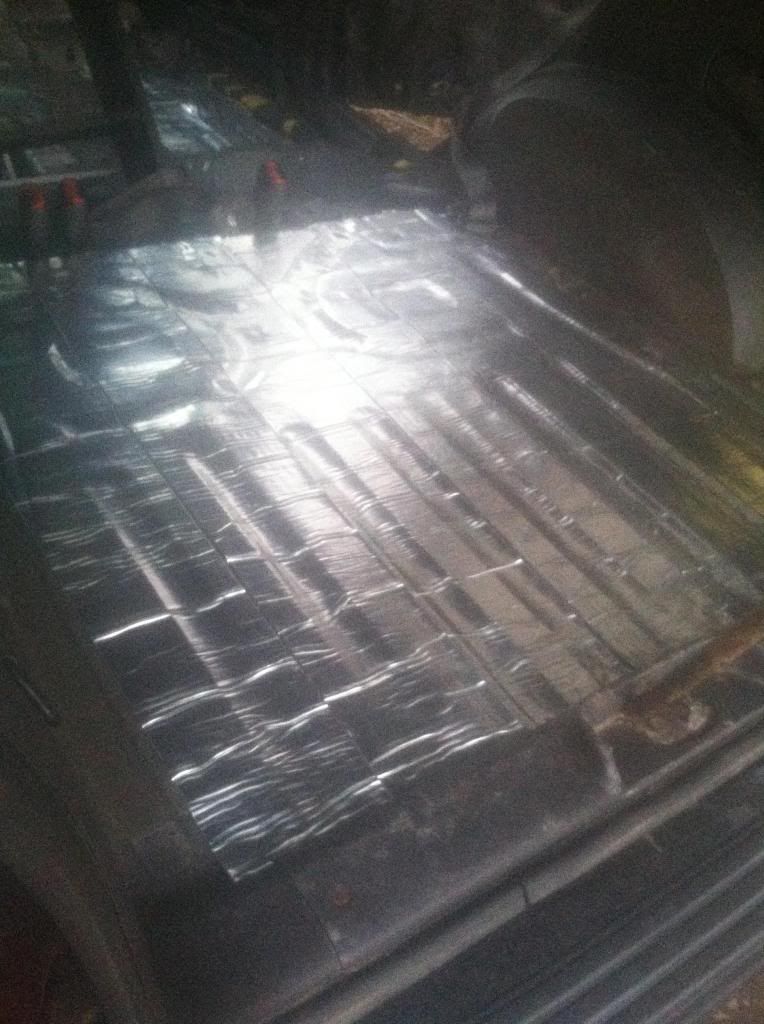

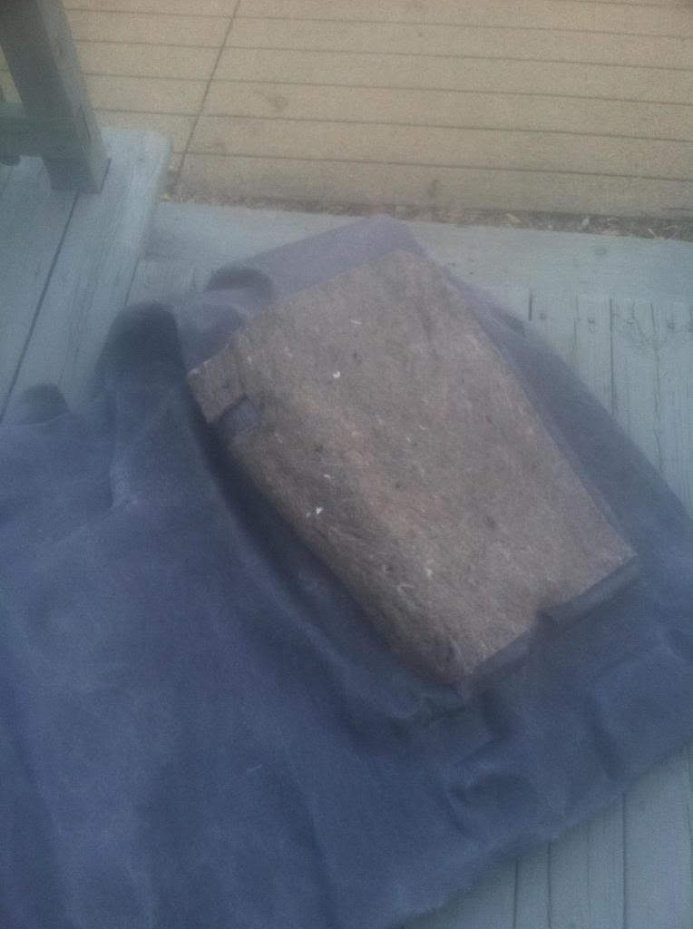

Gauge covers have been ordered. New carpet is being stitched right now. All of the wood trim has been wrapped in the aluminum. Got a gift card for new tires for Christmas.
Picture of the gauge covers:
Anybody ever used Peel and Seal as opposed to Dynamat for insulating the interior? The carpet I ordered does not include the fiberglass insulation as per my request. I've used strips of Dynamat for sound insulation and to stop rattles but never to do an entire interior. This Peel and Seal stuff is 1/10th the price and chemically similar. It's cheap enough I'm considering doing everything. Thoughts?

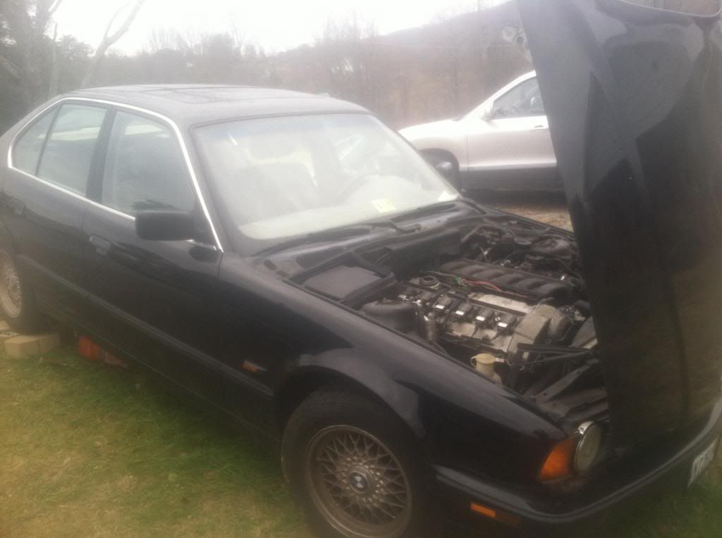

Picked up a new toy. Fo' free. PO said it was having spark issues. I think it has a cracked head or a blown head gasket at the very least. We'll see... It's a story for another forum.
This is what made me think it had something other than spark issues... Cylinder #2 is totally full of coolant...

Now I just need to finish insulating the inside.

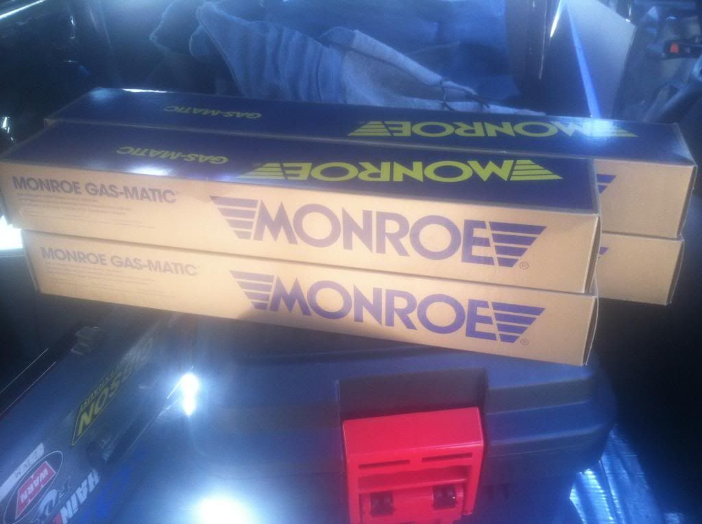

Advance Auto is running a sale right now. You order shocks online and get 25% off and $25. All said and done, I made it out the door for $70.

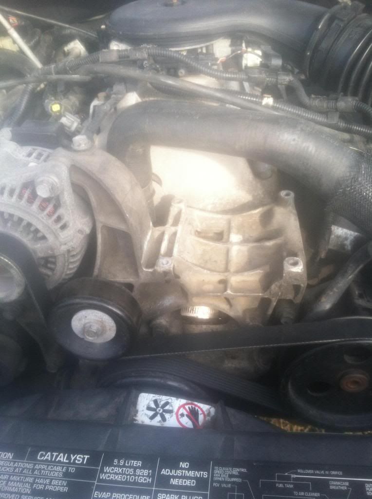

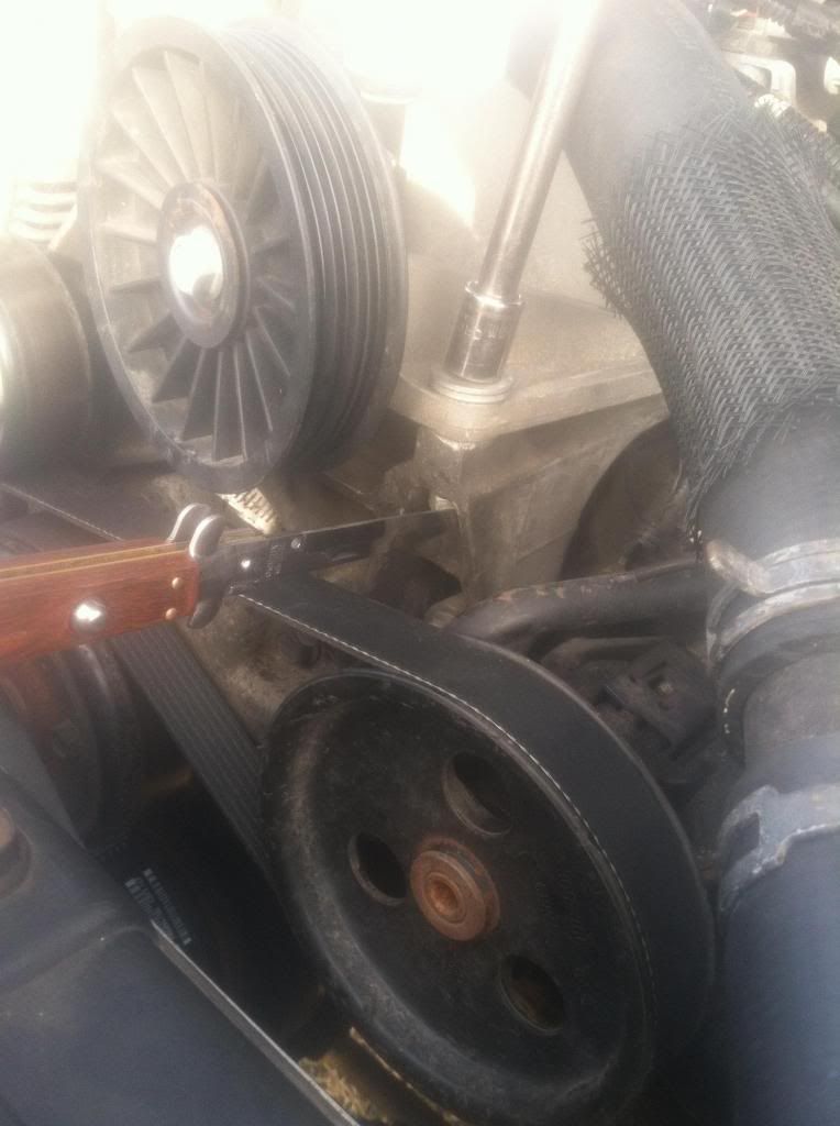

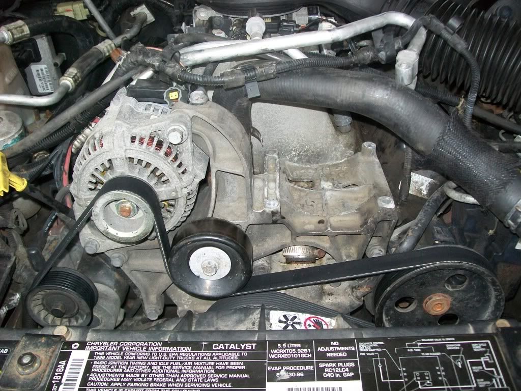

They're low quality shocks for sure, but they fixed the clunk from the rear shock bushings. It's worth the money just for that. I also finally did away with the AC Compressor pulley substitute. They were out of the Gates variety, but this will work for now. 7 rib, 82.5" belt for those of you that want to run with no AC.
The PO had cross threaded a little nut that held the useless pulley on. It was way to tight to get a socket or a box wrench on it, so I improvised. I used the knife to hold the nut still while I turned the bolt head.
Finished product:

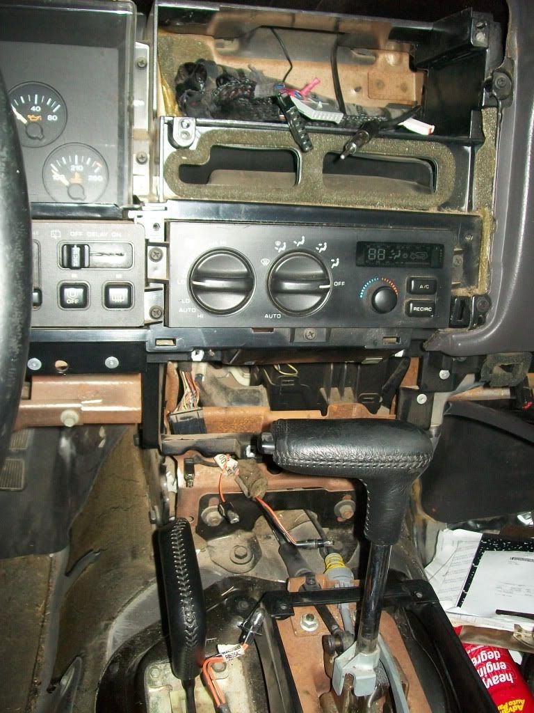

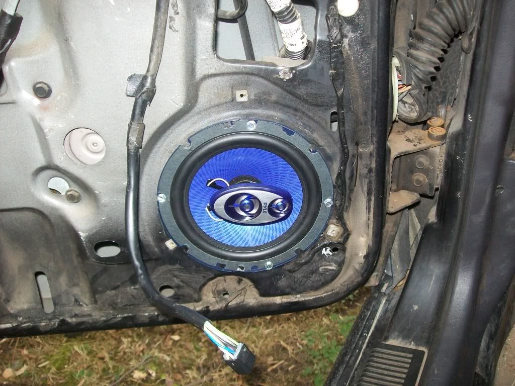

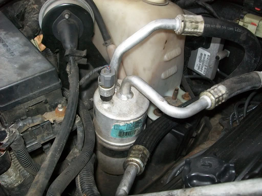

New wiring harness I soldered up for the Infinity Bypass.
Got all of these guys mounted properly. No sound proofing on the doors, yet...
New serp belt routing.
A better picture of my oddball drier.
New shocks=no clunking!

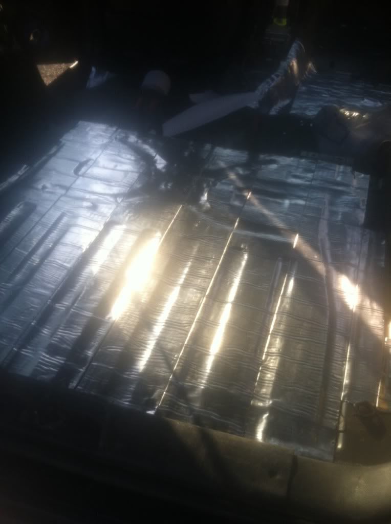

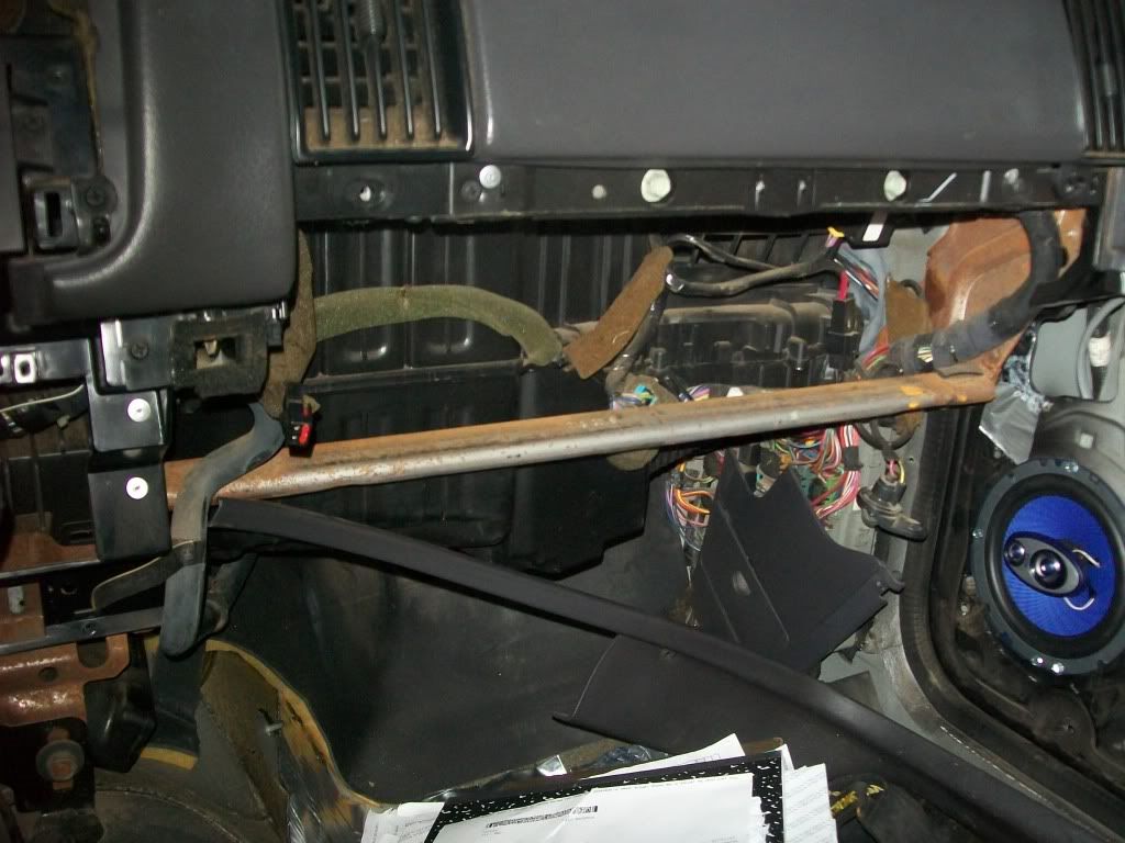

More gutted interior--testing the camera in low light situations.
Same as above.
