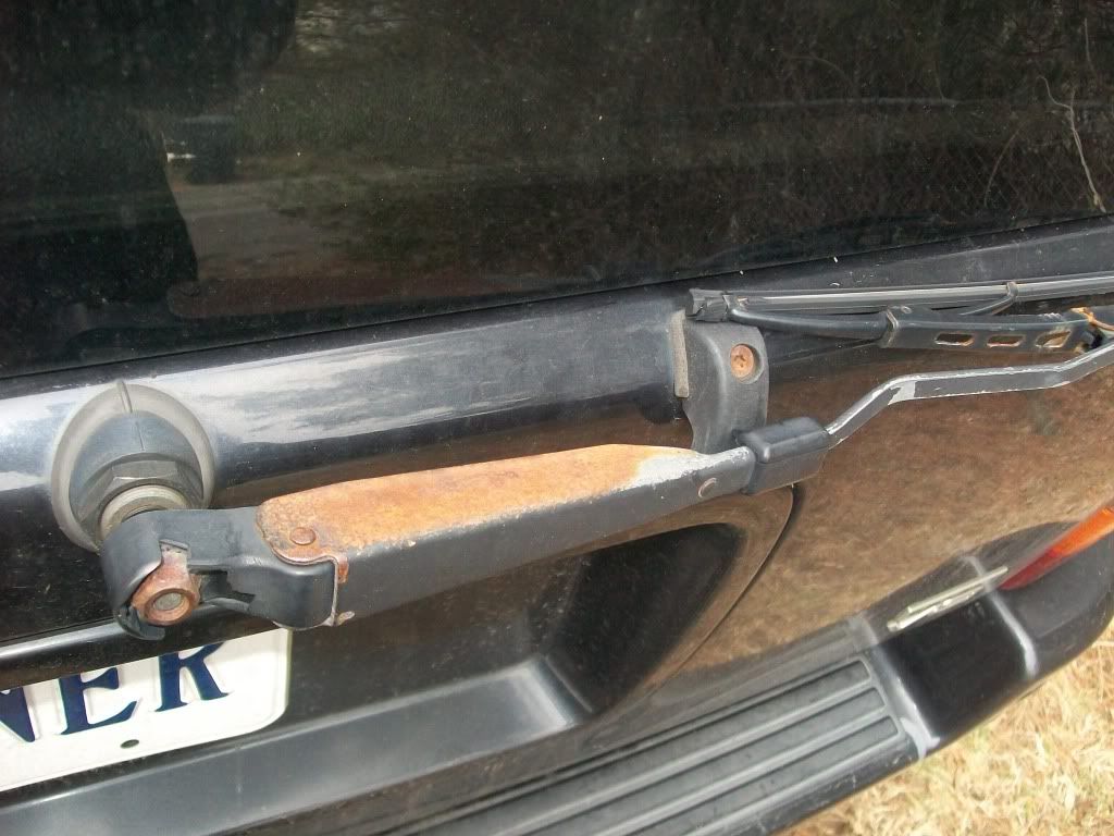

Haha. Is the arm nice and black? Or is the paint fading in it like mine? I'll buy if its in GC.
Isnt that what a can of flat black spray paint is for?
No... No it's not...
Yes... Yes it is...

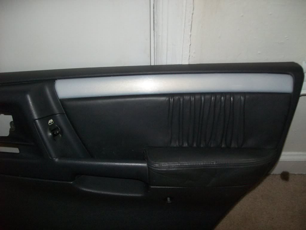

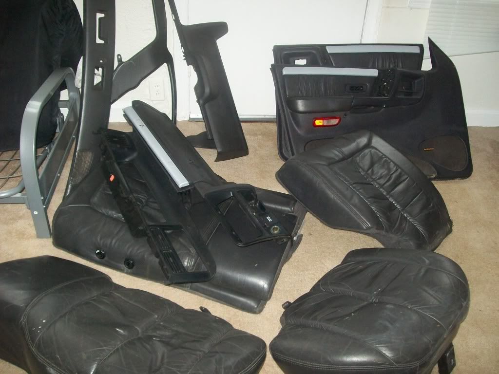

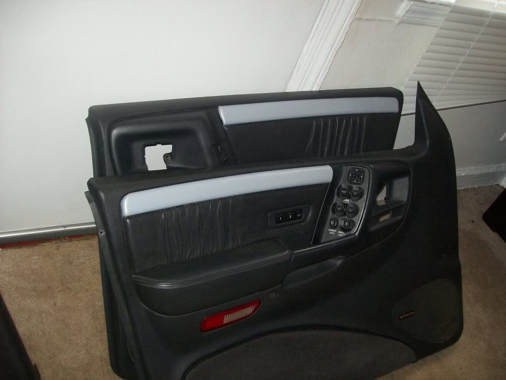

Remember that brushed aluminum vinyl wrap? Yeah? It's on all the door trim, too
This was my "**** that needs to go back in the Jeep today!" pile.
Coming from a military upbringing/military college/military career, I'm used to the Spartan lifestyle. But fo' real... This **** was getting old.

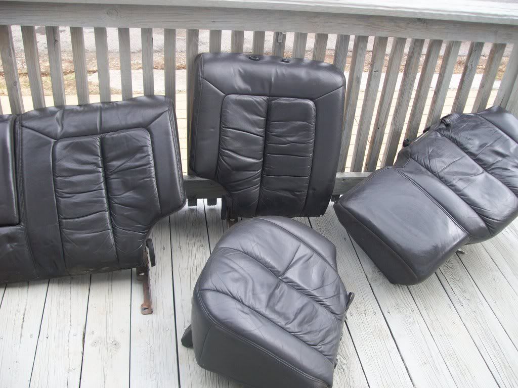

I used these guys...
To make these guys...
...As clean, and as soft, and as supple as the day that baby calf was beheaded, skinned, and gutted so my *** would have somewhere soft to sit.

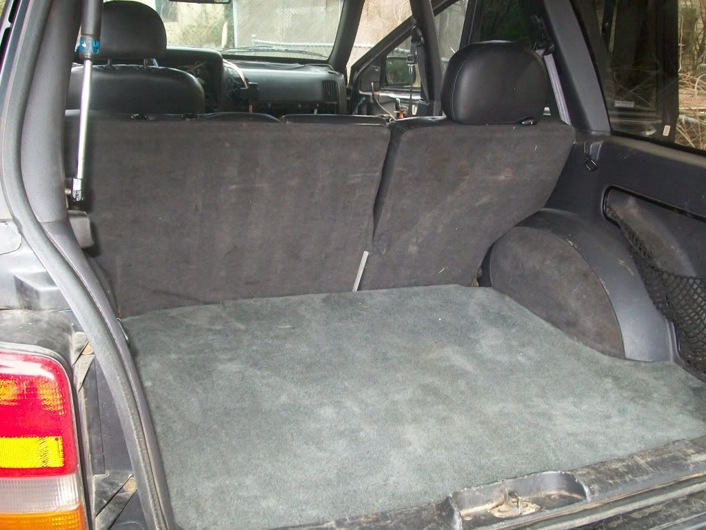

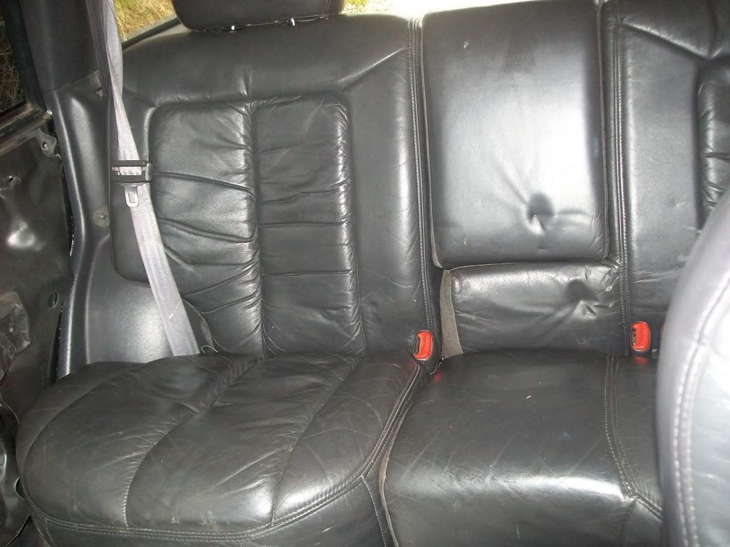

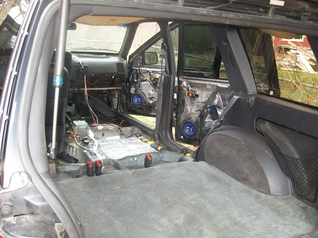

The back carpet is all glued in and the seats re-installed. The color of the new carpet is still a little off.
Thought about taking this ****er off. Its days are numbered.

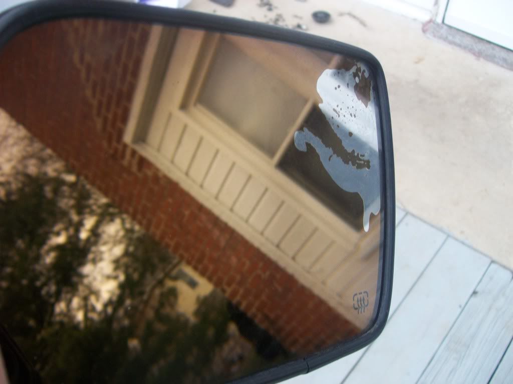

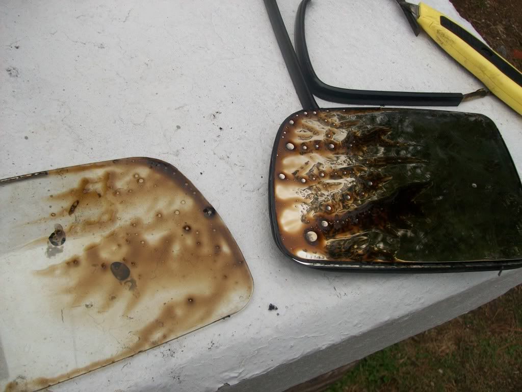

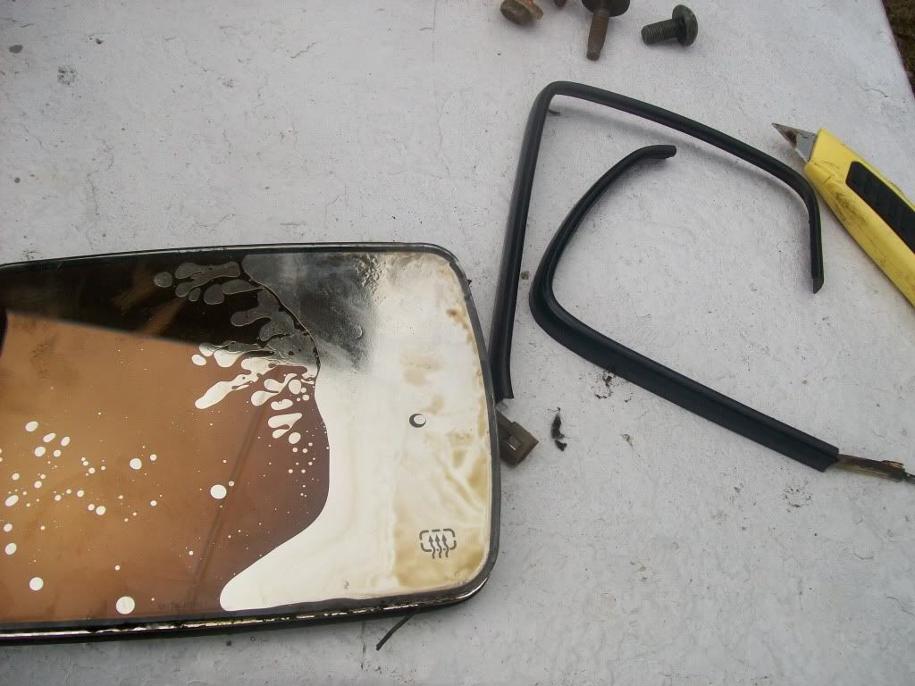

The last thing I did before I got a call from the bank was drain the fluid from my mirror. I can see again! No pictures of the final thing, but it looks like, you know, a mirror...

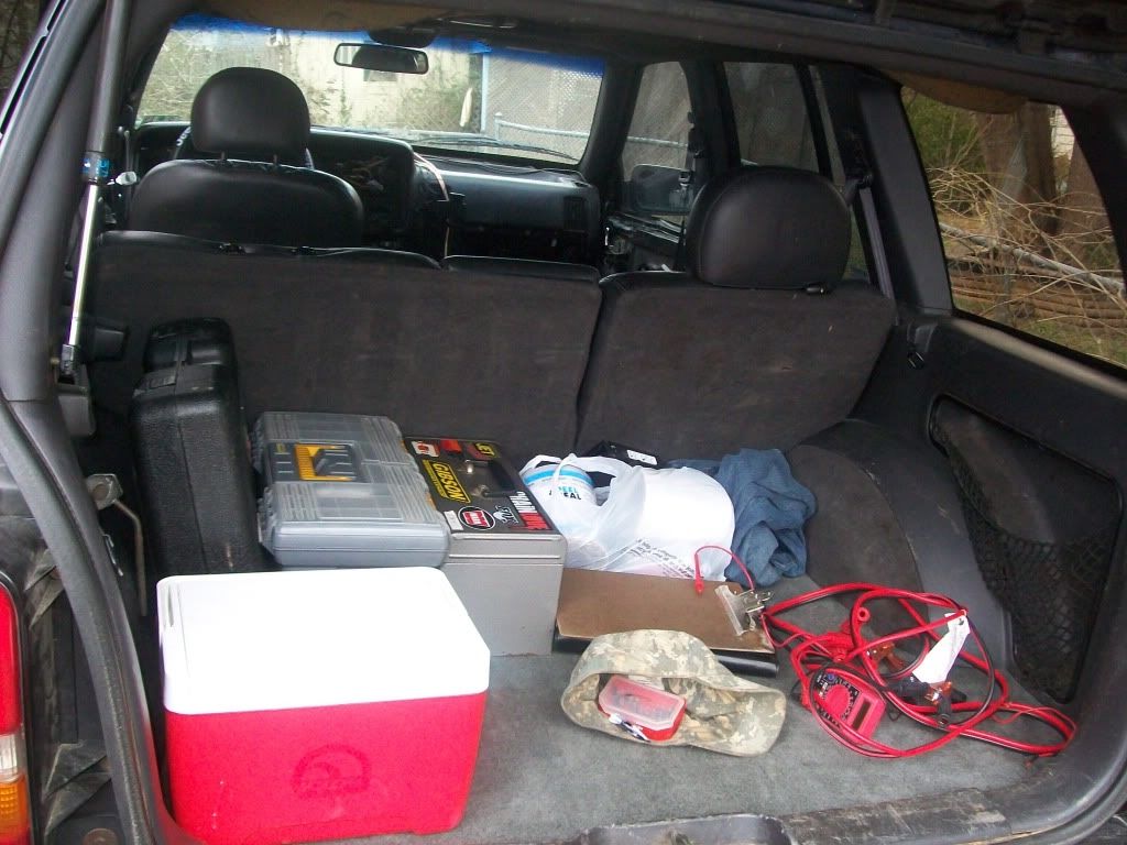

Aaaand filled back up with all my stuff for work. Notice the hatch holding itself up??? No broomstick???

How did you get your mirror glass off to drain the fluid? I NEED to do it in mine but I'm scared im gonna f*** up and break the damn thing, which I really wanna avoid. Does it slide up and out? I don't wanna go yankin on it and have it shatter in my hands
-Evan
The mirror (on a 98) lifts straight up, not straight out like on older models. That gets you the pile of stuff you see in my picture. Take a razor blade and run it around the edge of the rubber, like I did in the picture. The rubber comes off and you can separate the two panes of glass. The EL fluid is a pain to clean off, but it's doable.
