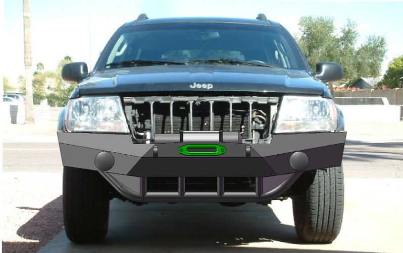

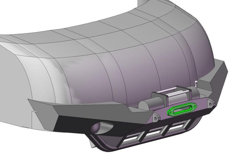

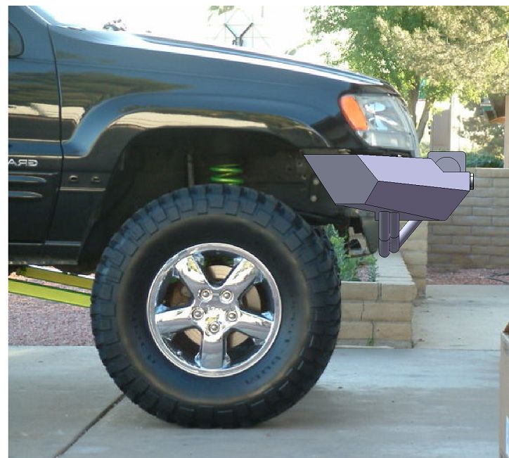

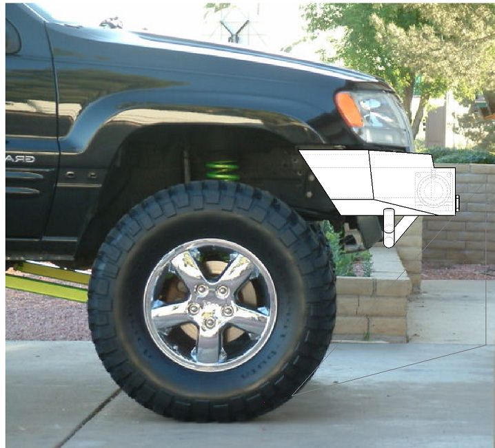

Here is what i have so far.. i have 3 concepts.. each with the winch in a different spot:
Here is #1: winch up top
Here is #2 winch below, and cut into factory sheet metal to move as far back as possible
And #3.. has winch low, but forward, and doesn't require any cutting of factory sheet metal
the lower mounted winch ones are able to keep the front of the bumper closer to body, but they loose approach angle, and can't really put a skid underneath without blocking all the air flow to lower part of radiator.. my favorite is #1.. here are some more shots:

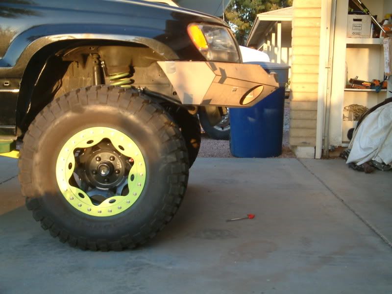

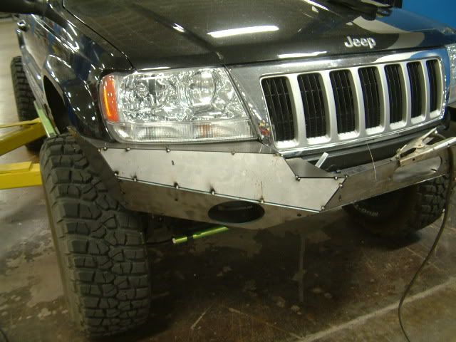

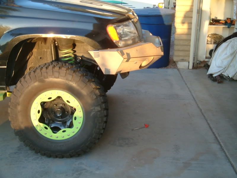

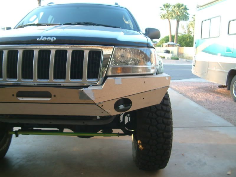

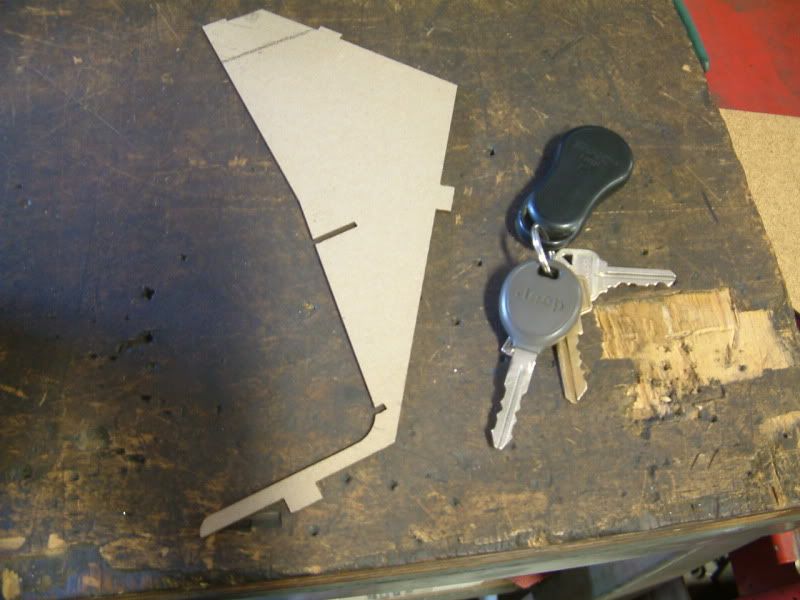

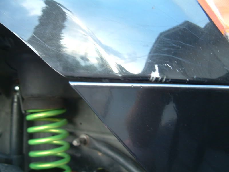

Got the prototype bumper cut today. made it from chip board from an art store, and hard board from home depot.. here are some pics, and a link to the video of the winch mounting plate getting cut out..
support joint:
I will be putting an angle on the end plates so they don't look so buldgey. I will bring in the front edge about 1" to 1.5"... to eliminate this weird looking corner:

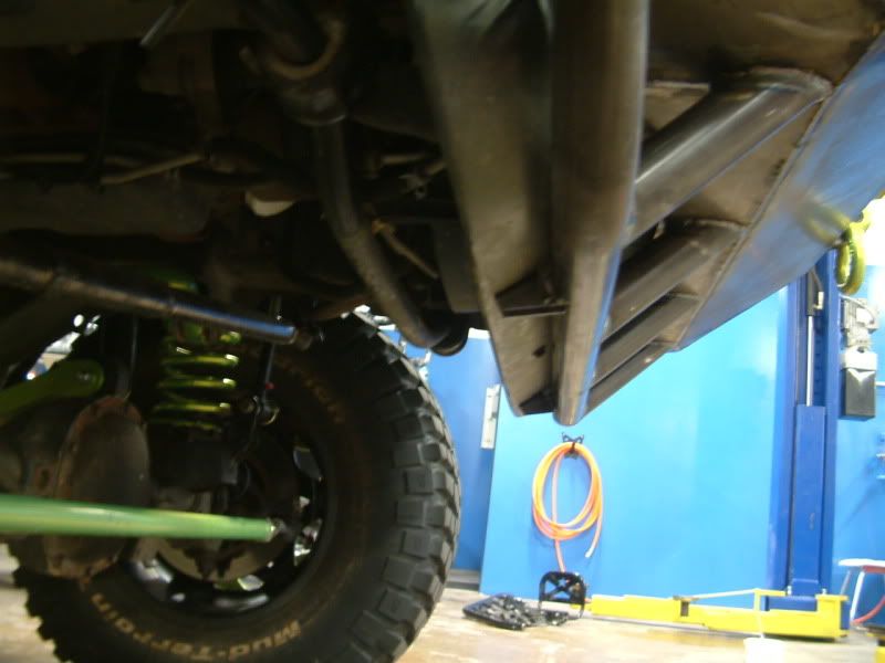

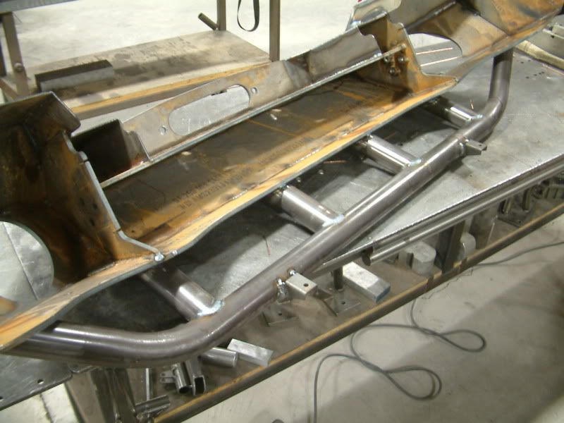

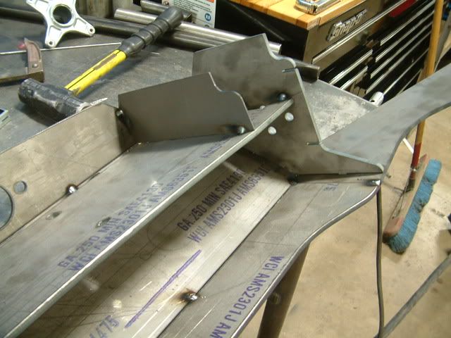

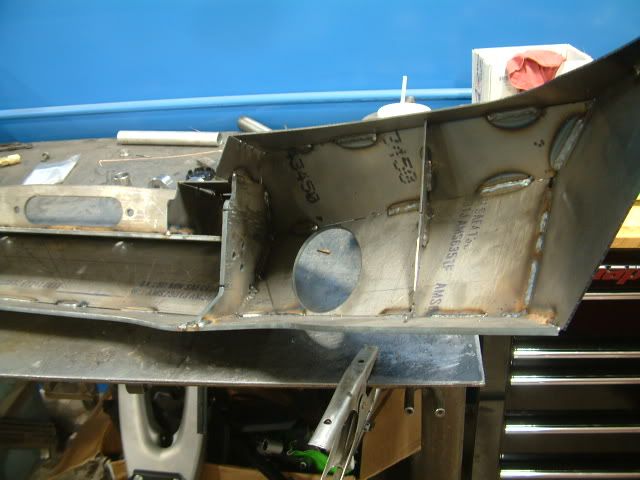

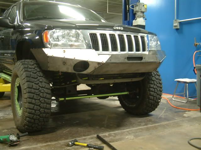

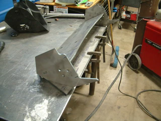

Here is the start of the fabrication i did today:
got the main parts tacked on the bench, then mounted it up to do the rest:

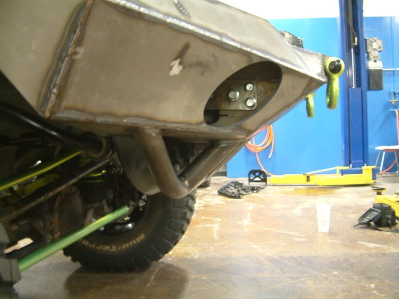

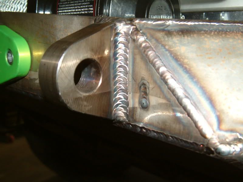

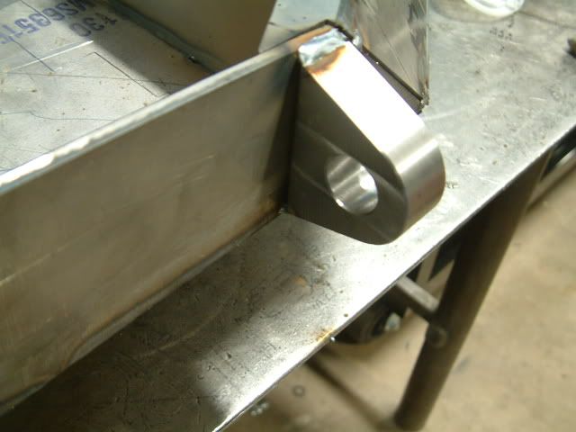

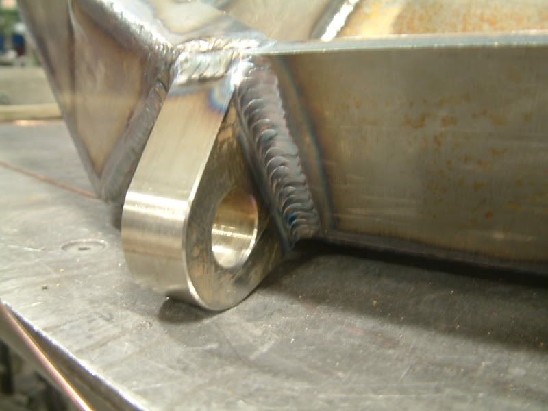

here are the tow hooks partially welded:
Mounts:
I will have one of the guys TIG weld all of outside seams, and important welds. I suck with the TIG, and not quite good enough with a MIG welder.

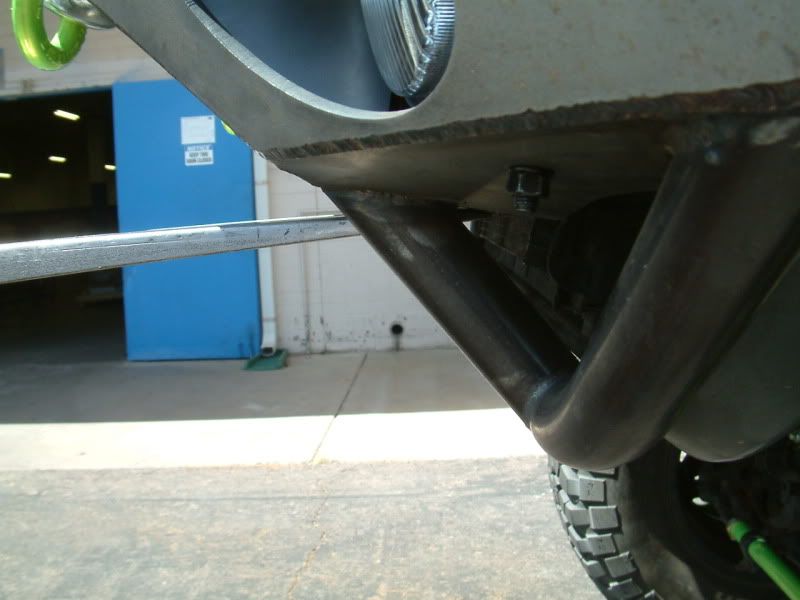

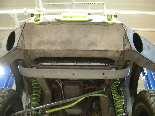

Got the last of the fabrication done today, and got it all mounted back on there for some testing. Also got the winch wired up. I am going to try to make it to GSW next weekend.
These tow hook welds are over 1/2" wide done with a TIG.. they are going anywhere!

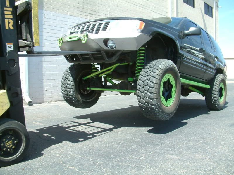

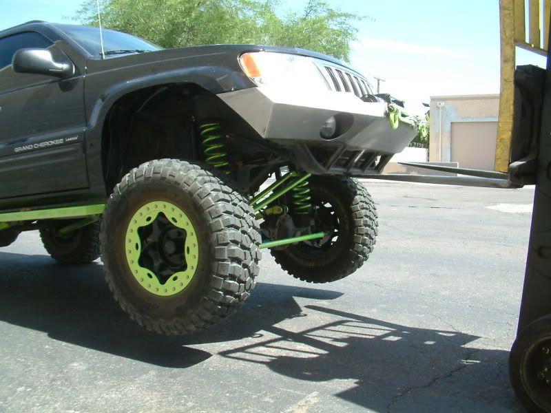

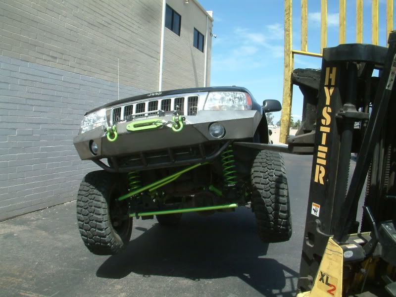

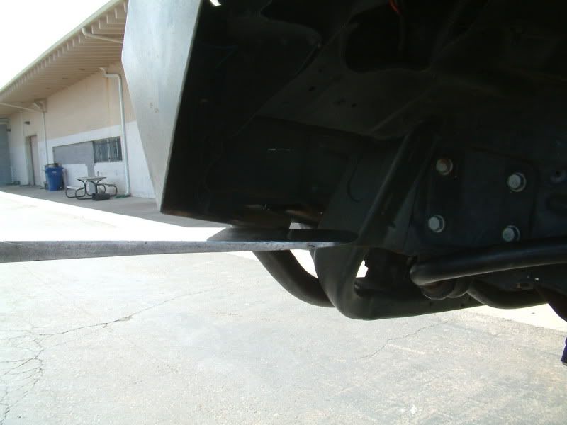

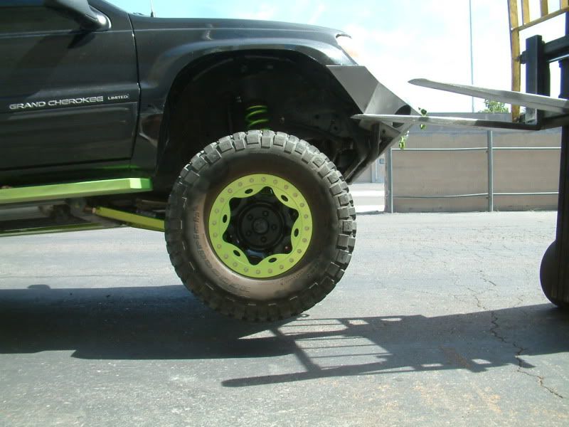

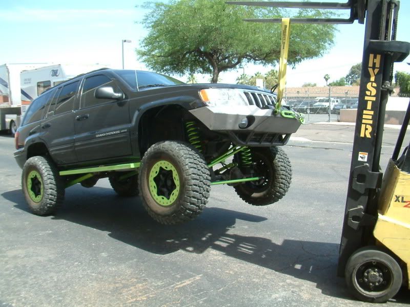

I was able to do some testing with the new bumper using a forklift yesterday.. results are perfect..
this one is just one fork right in the middle of the lower radiator support:
Pass side lift:
Driver side lift:
zero deflection with fork lifting on back edge:
D-ring test with my tree saver:

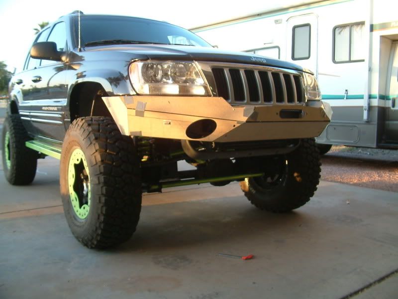

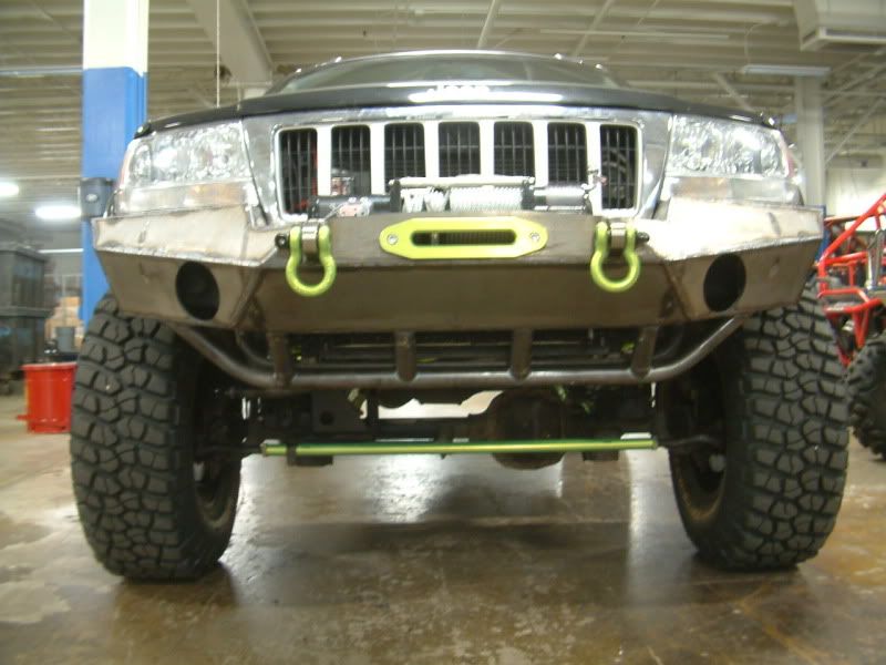

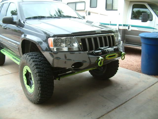

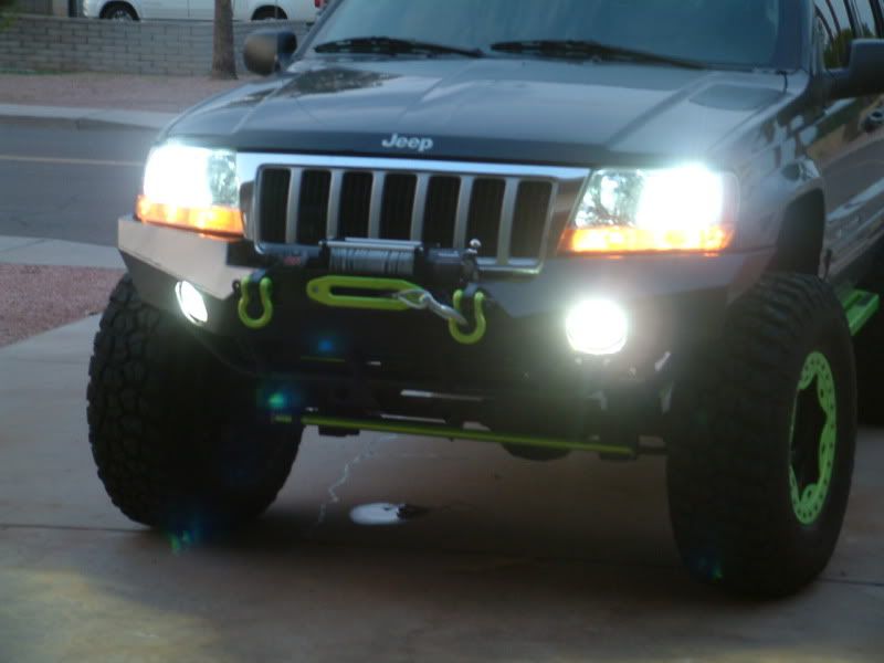

Mine is finally finished.. im very happy with how this sucker turned out!
the HID fogs lit up:

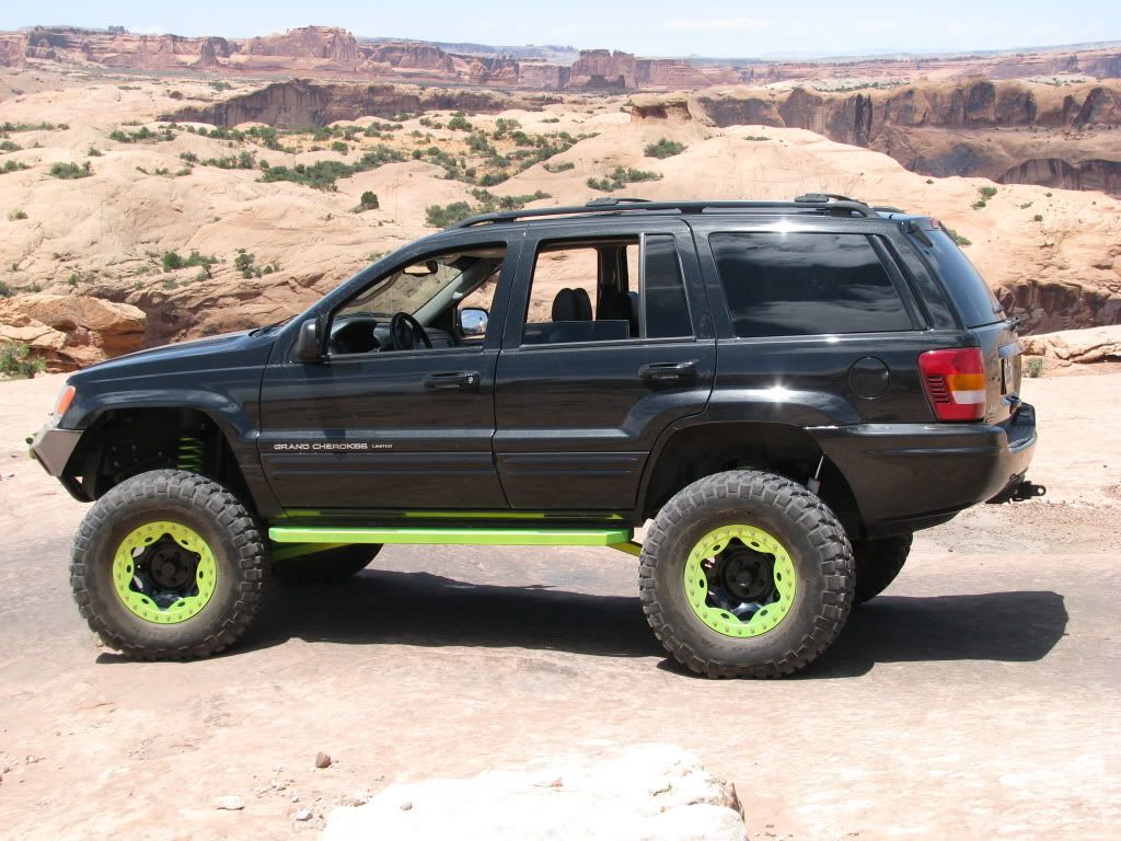

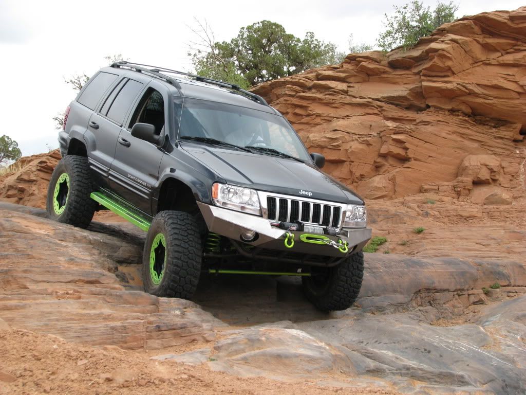

Here are a couple pics from Moab:
