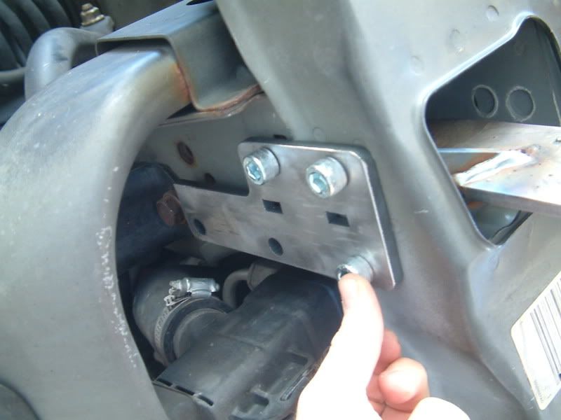

Here is the bumper build:
Here are the mounts.. almost finished.. just need to weld on some nuts, and spray paint..
Fits like a glove..
sandwich plate..
