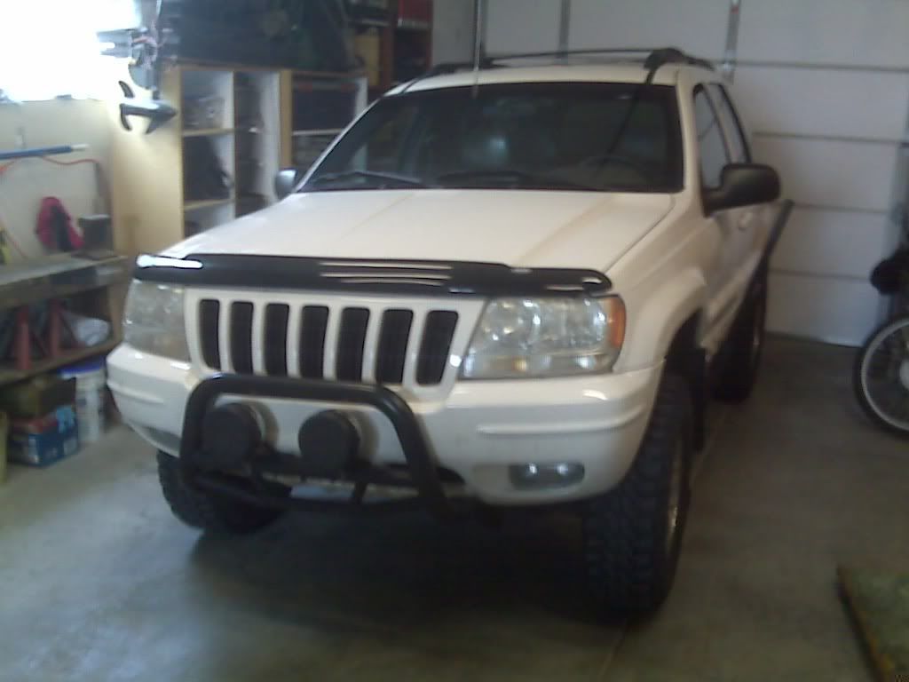

We (me and my now wife) bought this Jeep May-June of '08 with 52K miles on her. I thought that was pretty darn good for being a 2000.
The Jeep was originally my wife's vehicle and this was mine:
Yep, that's my baby and I've had a lot of fun with that thing. Well once we got married, it seemed my wife opted to start driving my car everywhere and I was left with her Jeep. She also never refers to it as her Jeep, but "our" Jeep. So whatever, that just means I get to play around with it and mod it.

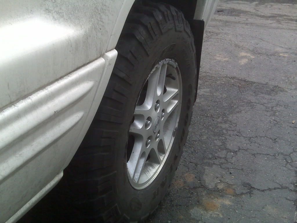

Then May of 2009, we got new tires! Wranger MT/R's 245/75/16 which, as far as I'm concerned, is considered a lift because it had 235/70/16's on it when we bought it!
Pics of the tires are forthcoming...

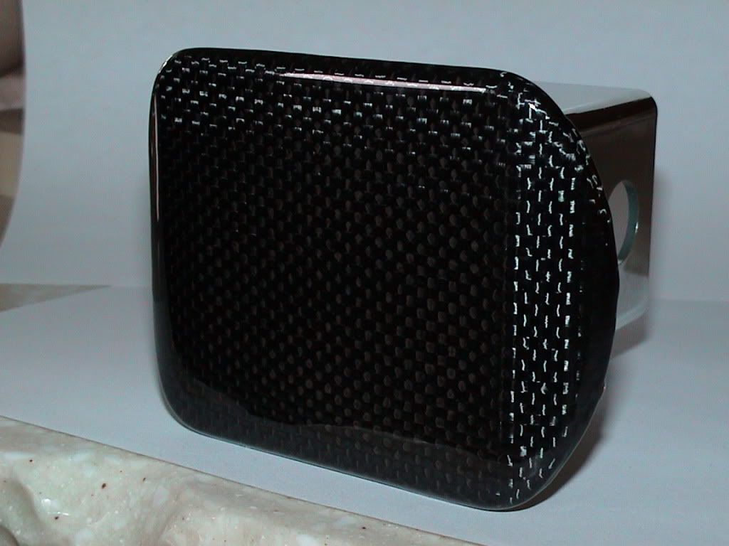

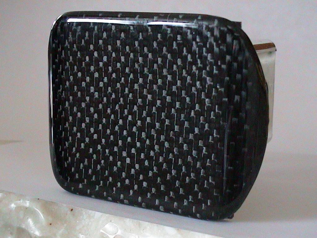

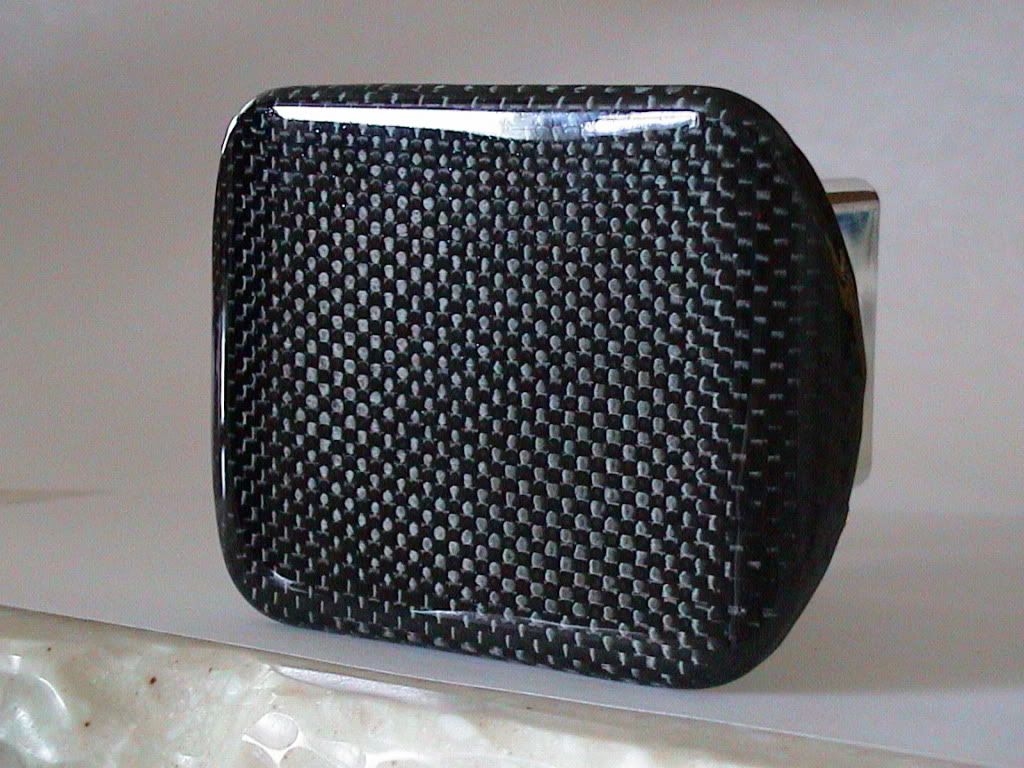

So I decided to see if a carbon fiber hitch cover was out there. I could not find one in the entire universe that was actually real. They were all imitation carbon fiber appearance. No good. So I made my own!
Here's one I did with plain weave:
And here's another one I tried with 2x2 twill:
I'm pretty pleased with how those turned out. I made a few to sell on ebay and sold one, but it never went anywhere so I pretty much stopped. I want to make one with 4x4 twill black and white carbon fiber because I think that would look sick! It'd match too.

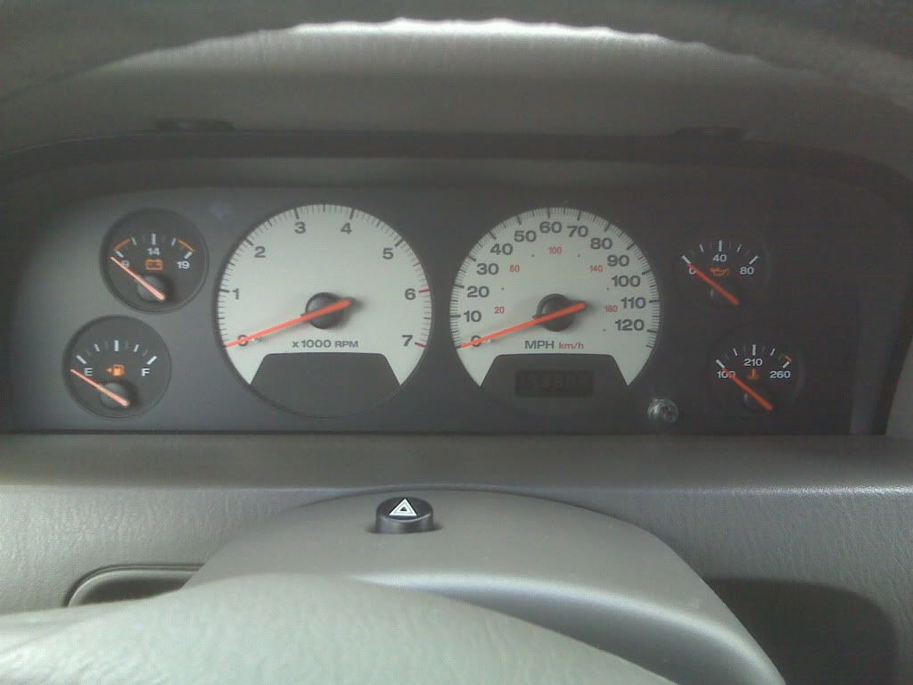

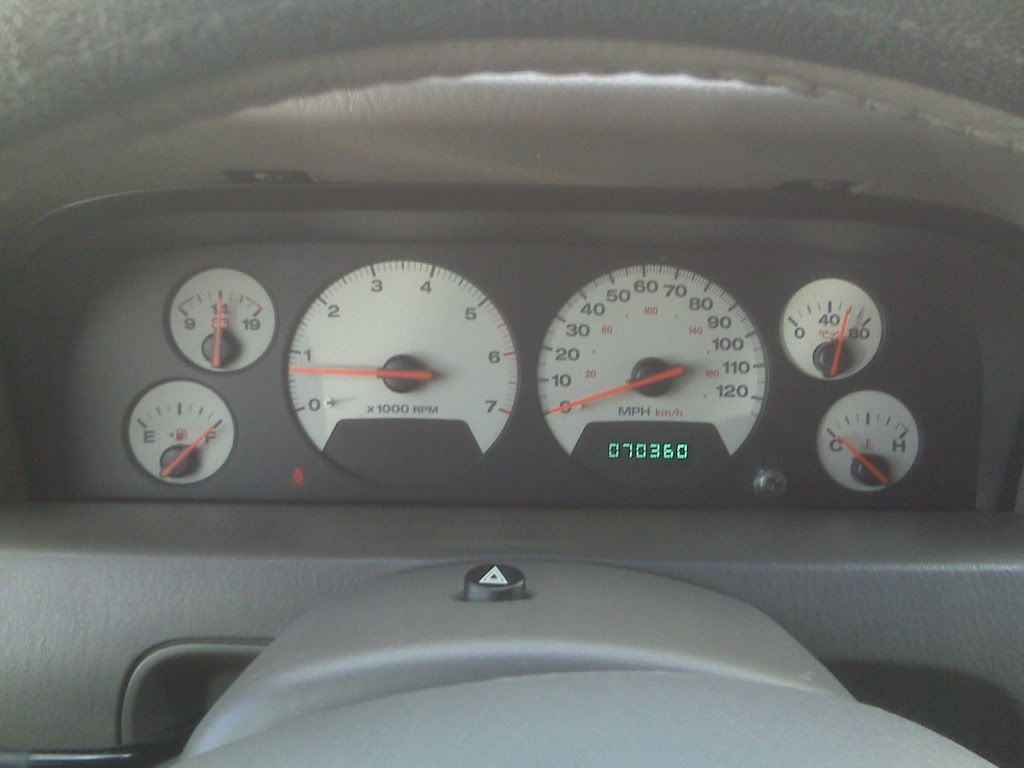

Right now I'm working on getting some '01 white-faced gauges! They should be here today!
Well, that's pretty much good for now.
Well right as soon as I posted that, the doorbell rang!
I got a set of these from another JF member who practically gave them to me for free. (Thanks again Jerry!) Well when I got them the fuel gauge wasn't working. So I improvised:
I finally found another JF member who had some (thanks again Kenny!) and now the circle is complete:
So now I have two spare instrument cluster assemblies, a full set of black gauges and a spare 3/4 set of white gauges!

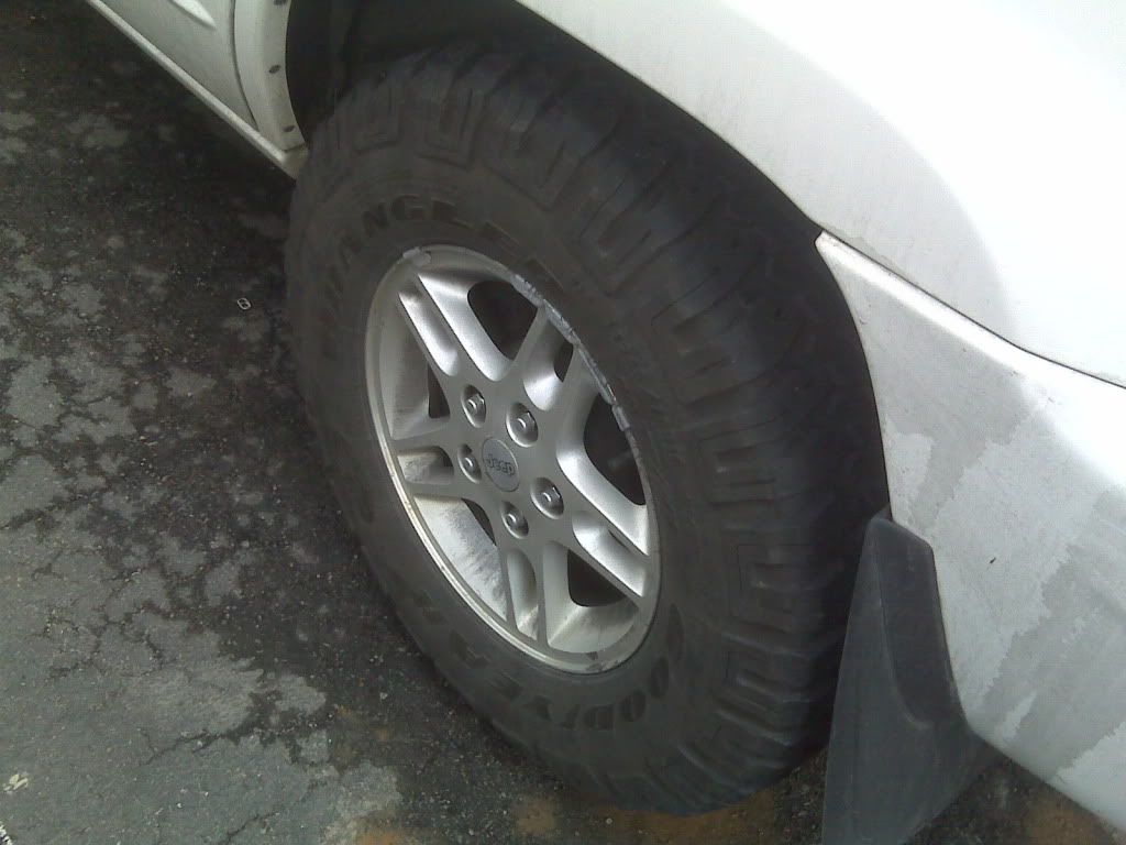

Oh, and while I was out there putting the gauges in, I snapped pics of the tires. Nothing spectacular, but you get the idea. Once it warms up I'll clean it up real nice and have a sexy photo-shoot.

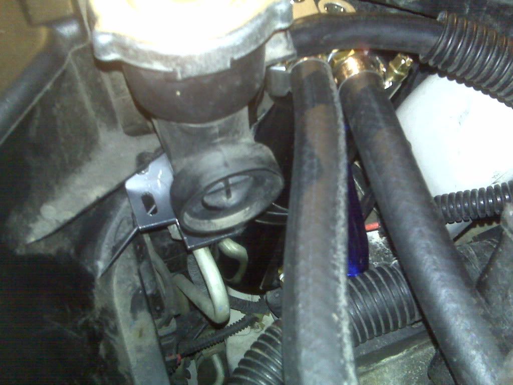

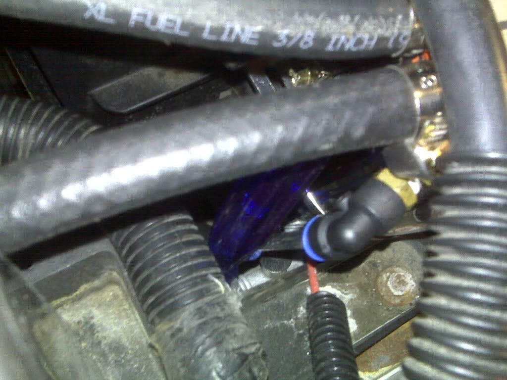

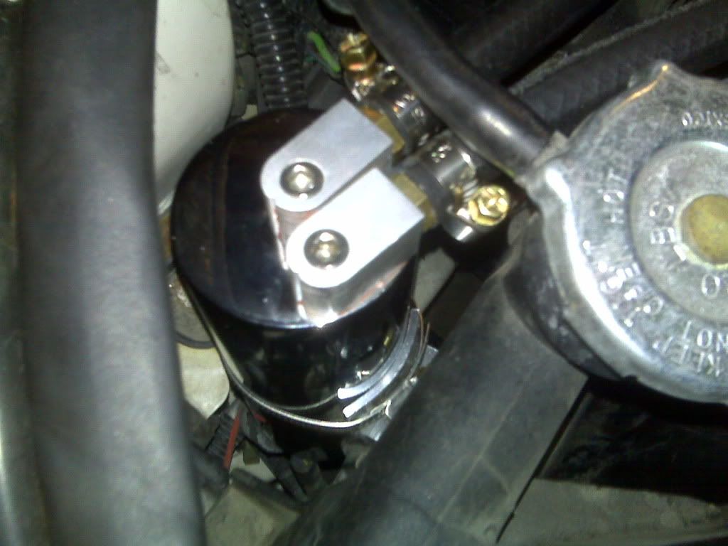

Here's some pics from my "Dual Catch Can Mod." I posted these in some other's threads, but here they are anyway. I'm surprised at how well they work!

And good work with the hitch covers, very cool! I have no idea what's involved with working with that stuff, but could you wrap some interior parts in it for accents? Like the bezels around the door handles and vents, things like that?

Yeah, the CF isn't easy to deal with. I think I made about six or seven covers with two different molds before one actually came out decent. It is a lot of work and I have new respect for anyone who can make CF parts look nice. That's another reason why I gave up on selling them. No one wanted to pay for the time, effort, and materials (especially) that went in to one of those things. I don't really blame anyone though; I would've never guessed until I actually made something myself.
You can do the wrap method, but it's just not as clean, nice, and it makes the parts bigger. The best way is to make a mold of the part you want and then just make a whole new part out of CF. It is A LOT of work, but it's the best way to do it I think. So for the interior accents, I would ideally like to get the woodgrain pieces from a junk yard, make molds, and then go that route. Reason being is the parts you use to make the molds usually get a little roughed up.

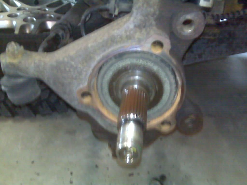

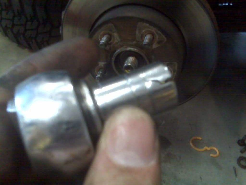

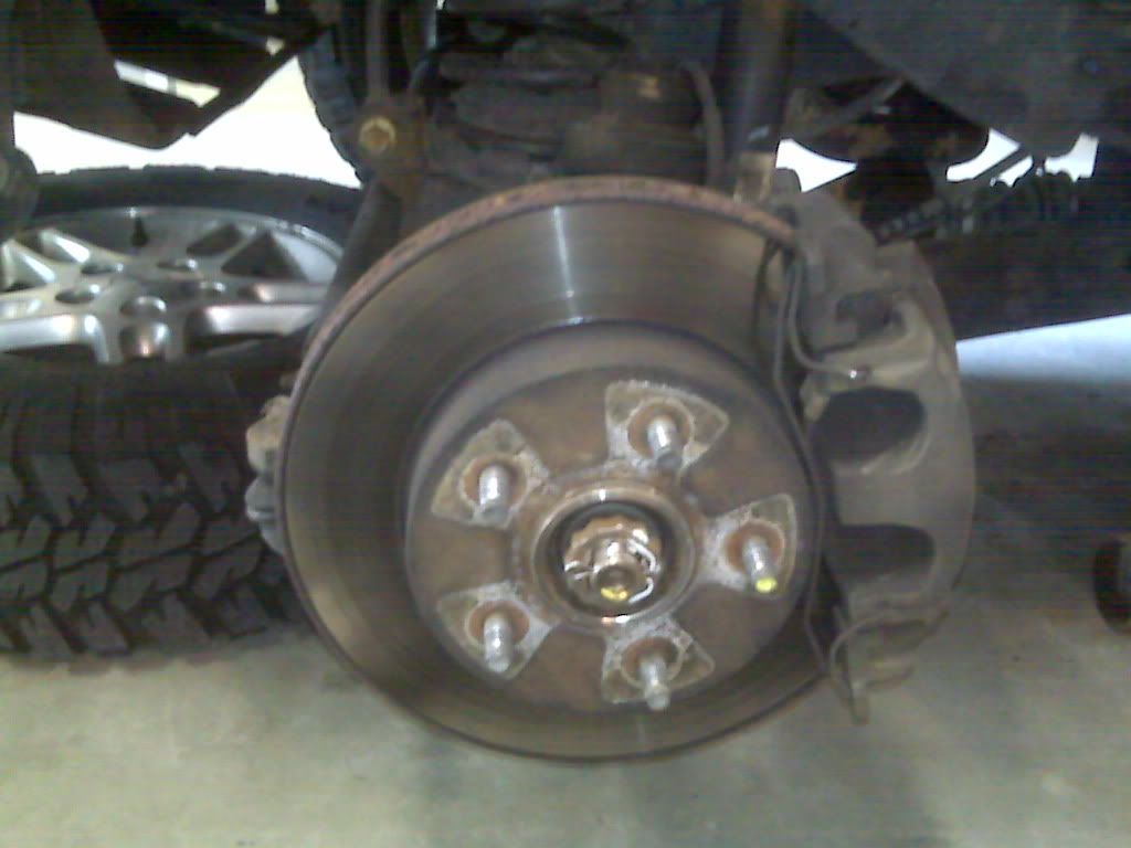

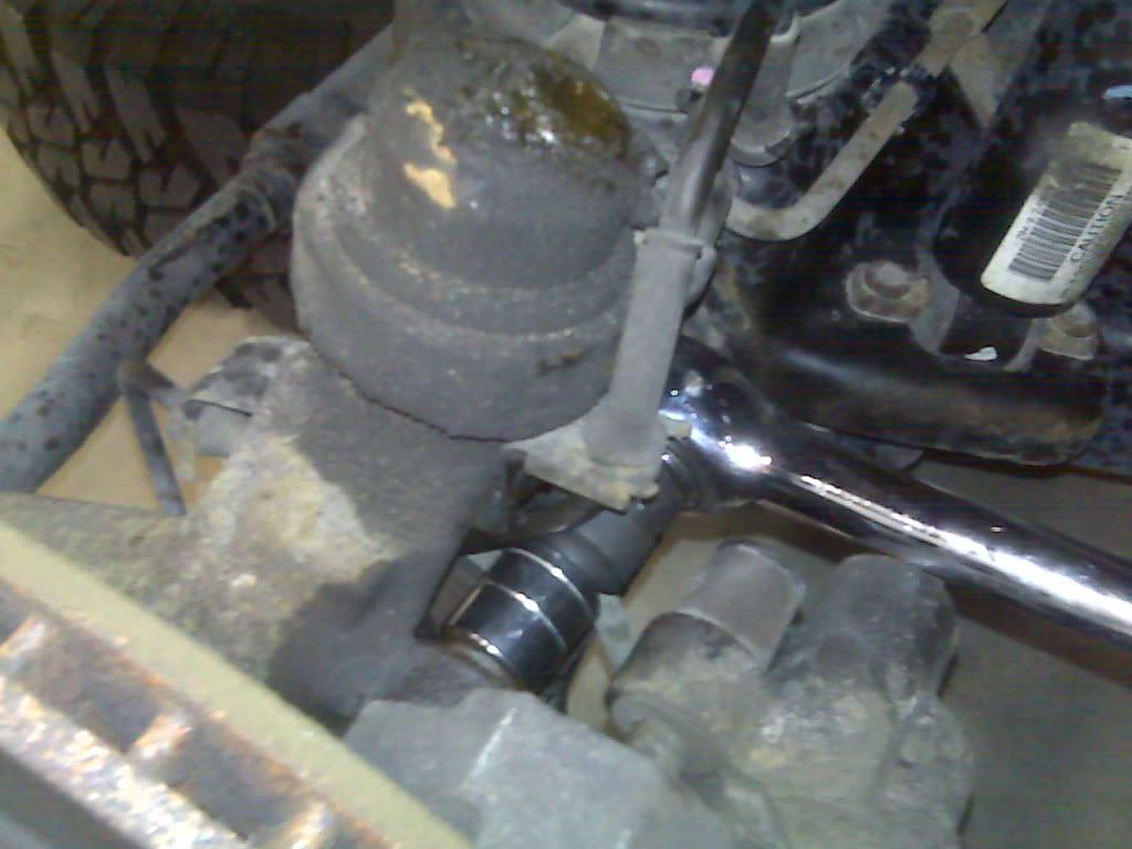

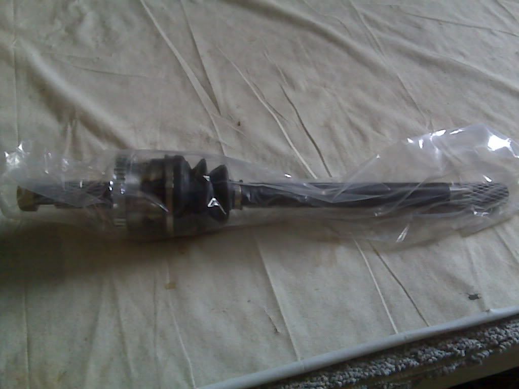

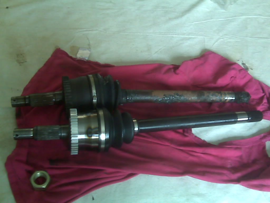

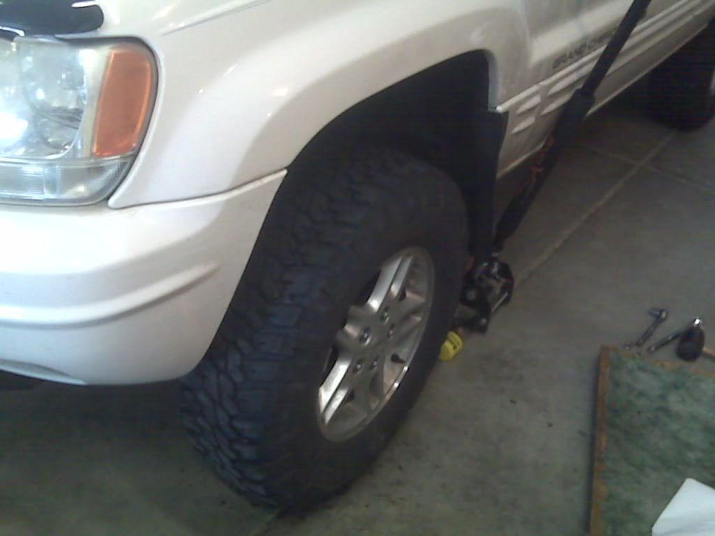

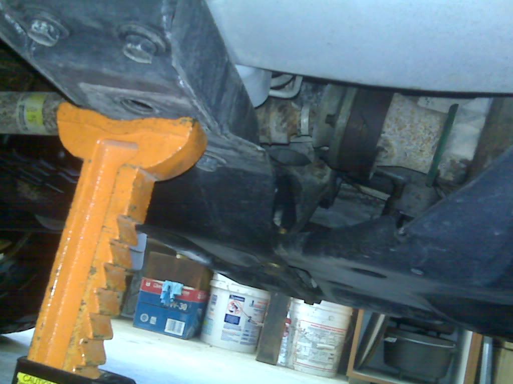

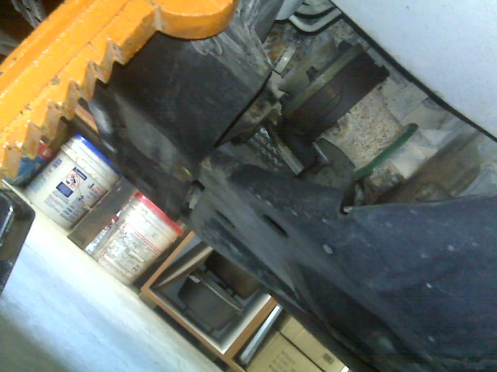

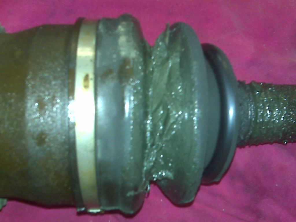

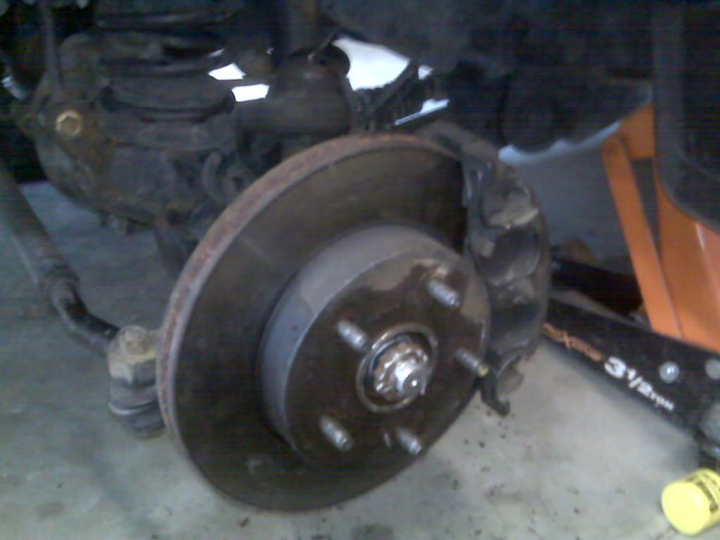

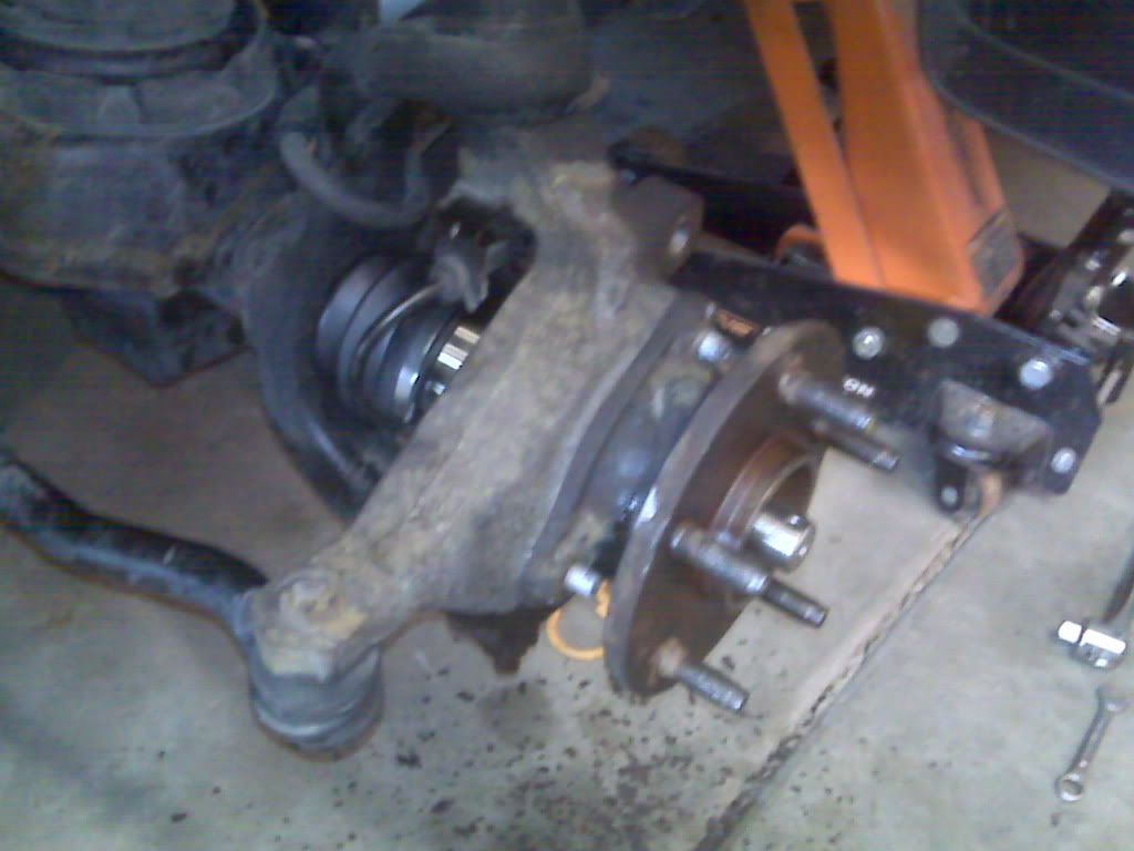

Finally replaced the CV axle
I finally got all the tools together and tackled the CV axle. Last fall I was changing the oil and saw that the boot had a leak in it. Thanks to this thread I was able to replace it on my own:
http://www.jeepforum.com/forum/f13/how-replace-axle-shaft-wheel-hub-bearing-assembly-w-pics-377208/
Thanks again for the write-up Arlo!
These were taken with my phone, so sorry they're not the best:
Here's the new axle:

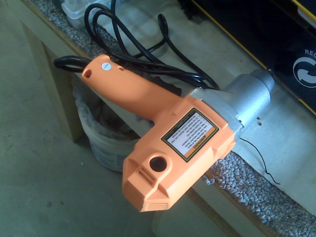

I went an got an impact wrench and it zipped the hub nut right off no prob!:
Taking the caliper off:

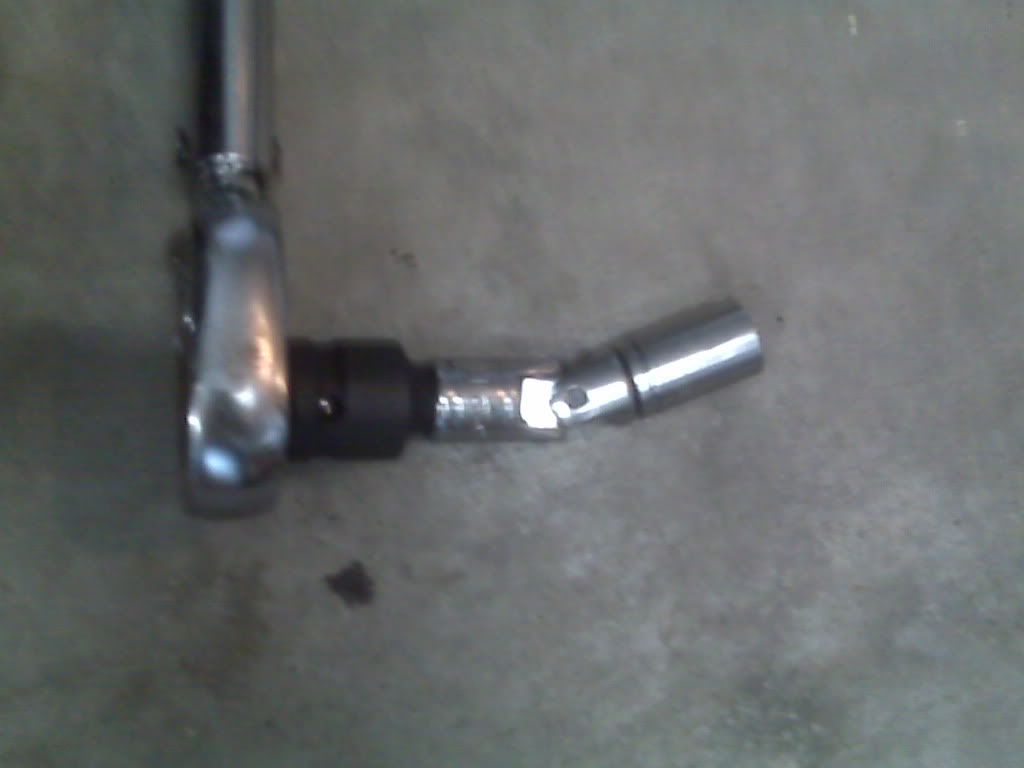

While trying to take those hub bolts off I broke a socket:

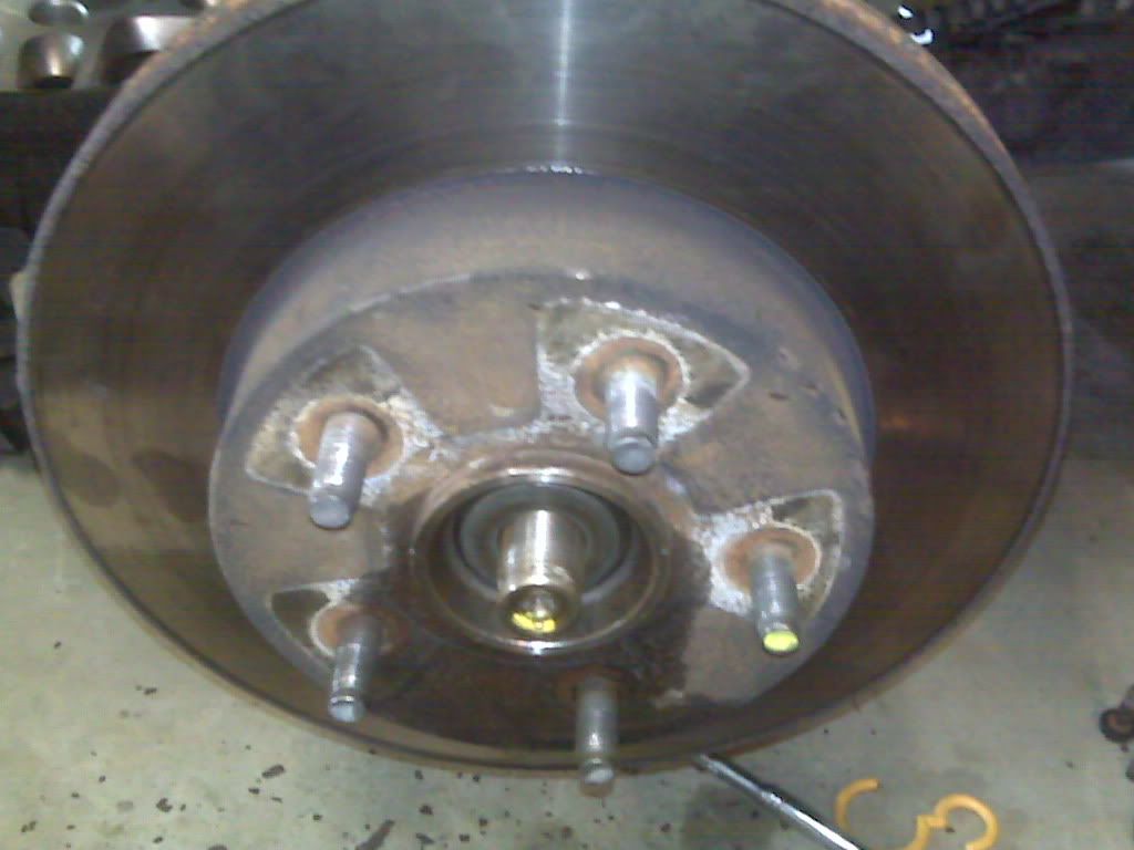

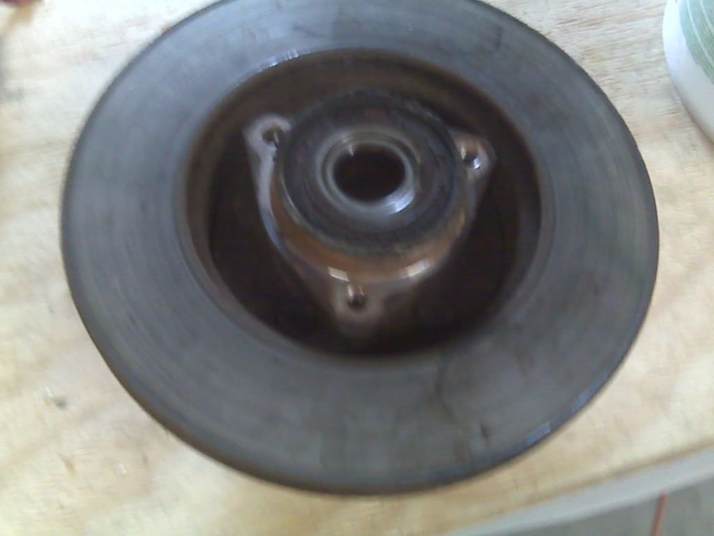

The hub and rotor were stuck on there really good and it took a fair amount of convincing to get those suckers off. When I fnally did, the rotor and the hub stayed stuck together:
I tried smacking on one of the wheel studs and it popped out of the hub. I was then able to spray some PB blaster (love that stuff) in between the hub and the rotor via the stud hole. I let that sit for a bit and was finally able to separate the rotor and the hub. I then popped the stud back in the hub and all was good:
New and old axles:
When I saw the crack in the boot, I put a piece of duct tape over it where it stayed all winter to buy me some time until I could replace the axle. I love duct tape.

New axle installed and hub put back on:
Rotor and caliper installed:
Mission Accomplished:
