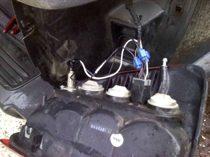

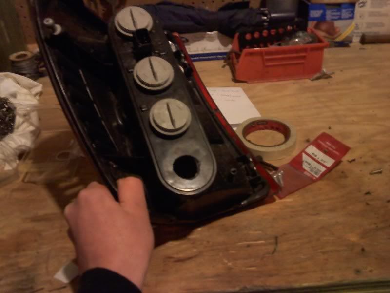

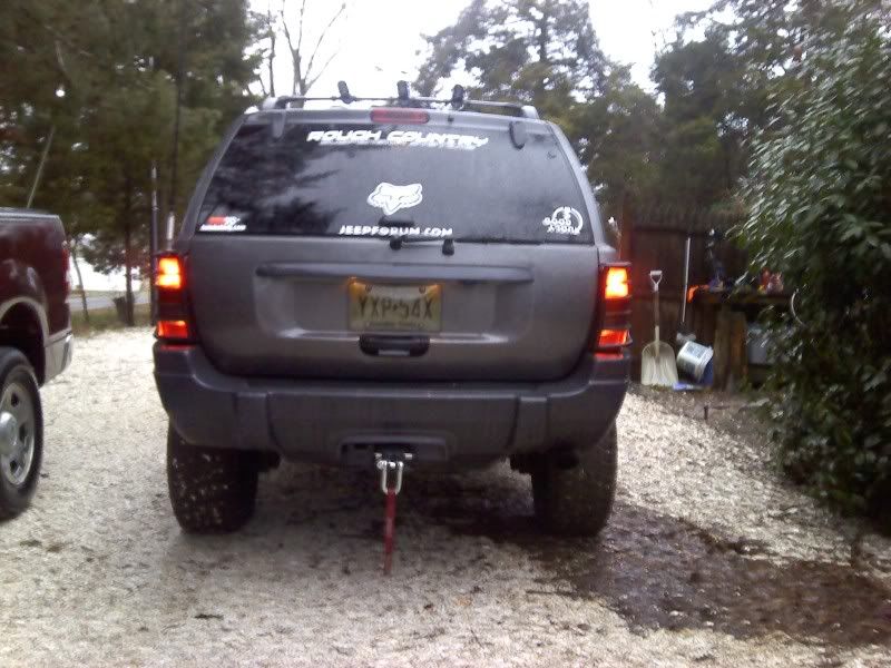

i did the quad tail light mod today ..came out really good i followed the write up on street jeeps heres the link http://streetjeeps.net/vb/showthread.php?t=5095
heres the hole i drilled
socket screwed into place
the wiring i used those easy tap in wire things
driving lights..
brake lights..
2003 4.0l wj- 6.5 inch IRO+.75 spacers. 4.56 gears. dana44a swap. 35x12.50 MTR Kevlars
is the wiring
white to brown
black ground to black ground
black to yellow
were did you get the bulbs/socket?
also like the light bar. have a coupon for those lights for $17 so going to pick up 2 sets.
have any pics of the light output on a dark road?
do you get any sounds when driving form the light bar?
nice WJ build

Originally Posted by straty1987 View Post
is the wiring
white to brown
black to yellow
nice WJ build
this is the wiring i used..
ground wire on socket > black wire on jeep
Minor wire on socket ( dimmest light ) > black/yellow wire on jeep
Major wire on socket ( brightest light ) > white wire on jeep
i got the sockets from advanced auto
if you have a sunroof and open it all you are going to here is gusting wind from the lights..with the sunroof closed you still here some wind but not as much and if you completely close the sunroof to where you cant see the window then there in no noise
heres some pics..
i just found out that my cell phone doesn't take good pictures at night but i will tell you that these put out much more light output then in the pictures
here is all of my lights on
thanks for teh info and pics.
i know they light were you aim them.
did you just run the given cable or ran to a point and then just 2 wires (+ & -) up to the bar?
install looks really clean up there
i ran two positive wires to the battery
one wire for each set of lights.
then i just used one wire for the ground
just make sure you get thick wire or there going to melt..i forget what gauge i used
