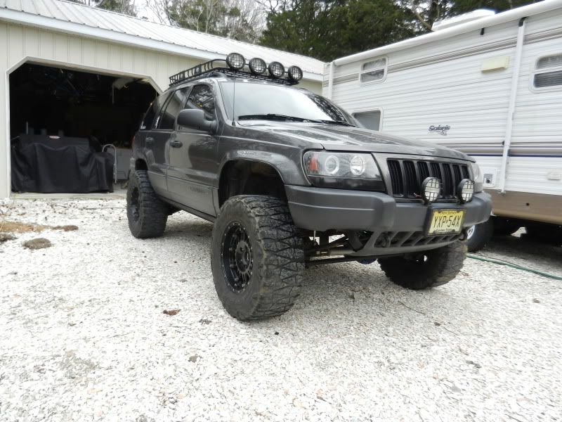

fixed my moms camera ..she had it on the soft setting my guess is for taking pictures of my baby nephew o well heres some clear pictures for enjoyment

Pictures look much better now!

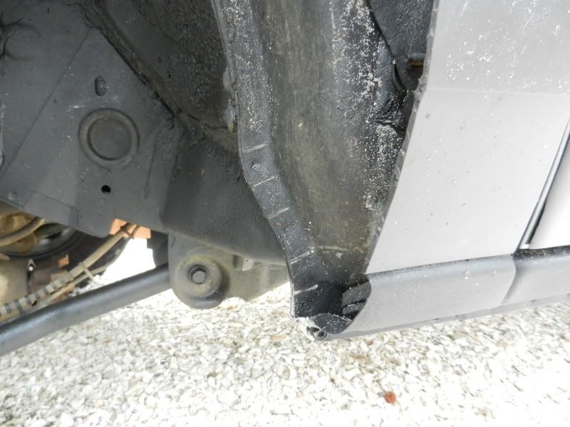

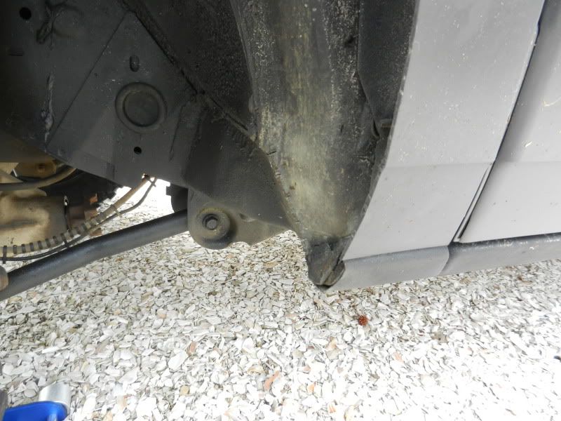

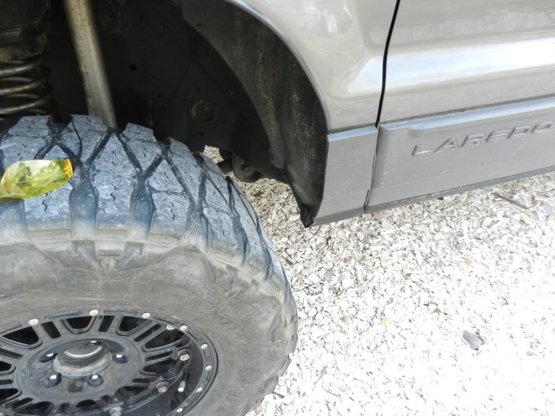

bent the pinch welds today ...very easy job with an angle grinder
made the marks with a razor
cut
and hamer down!
end result= No rubbing!
