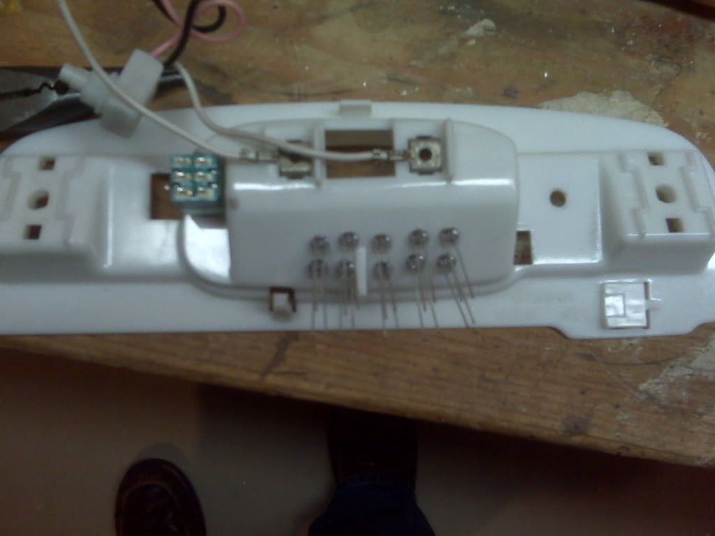

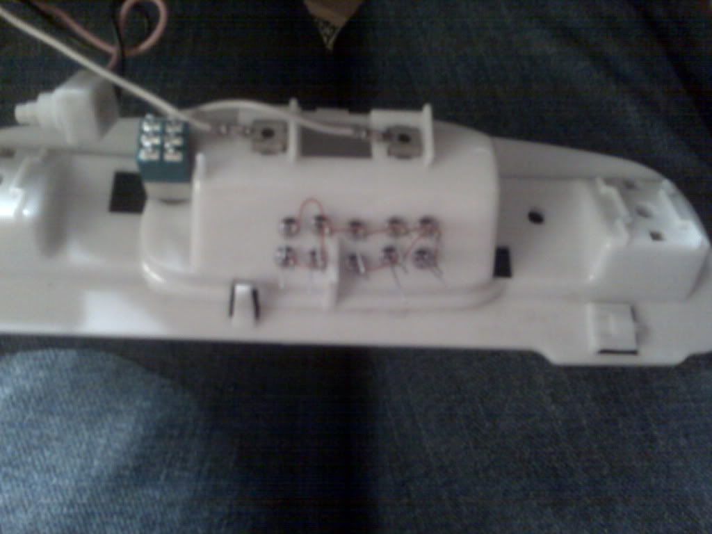

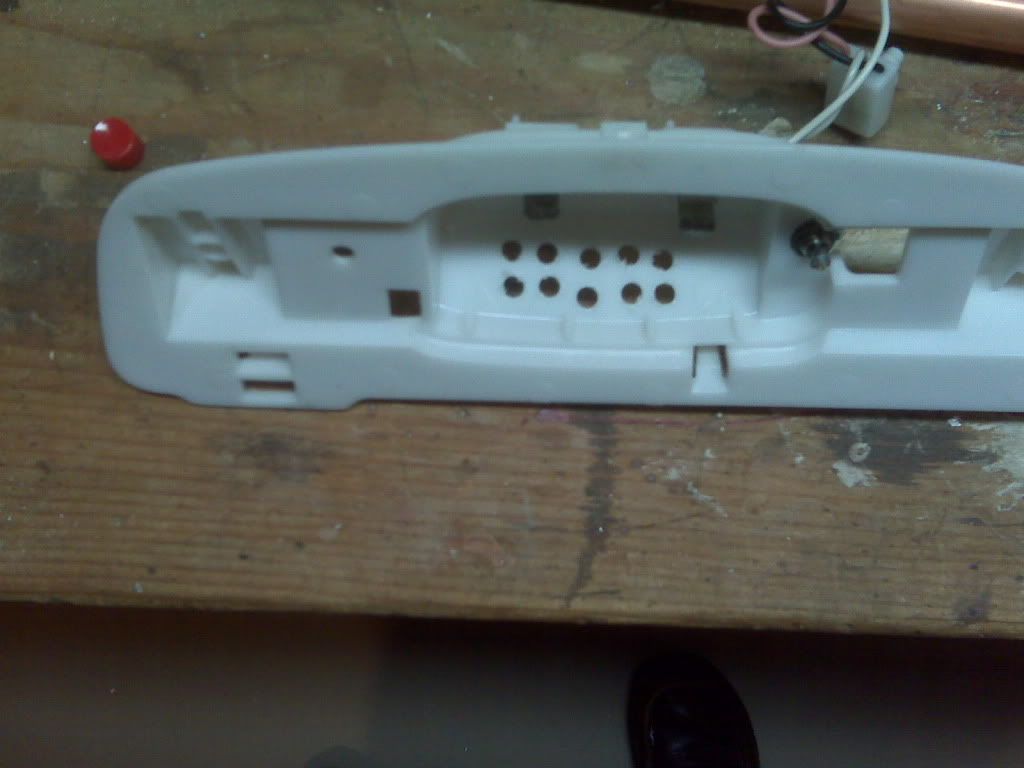

OK. Red courtesy lites:
basically all I'm doing is drilling holes in the recesses for the lights, and wiring in LED arrays (a bunch of LEDs in parallel)Then I'll have a day/night mode switch right by the EVIC, that will choose between day (white) and night (red) lights.
Soooo, first I drilled holes. Crappy job, I know. 1) they won't show, and 2) I'll make sure to make them nicer on the other lights
Next, I force-fit the LEDs into the holes.
Then, using a wire-wrapping tool and thin wire (radio shack FTW), I wired up everything in parallel.
Stuck a DPDT switch in there instead of the factory SPDT one, and soldered it up. I still have to wire in a resistor to make sure I'm not going to fry the LEDs, and connect it all to the wiring I did a few weeks ago.
More later, when I get it all running......
