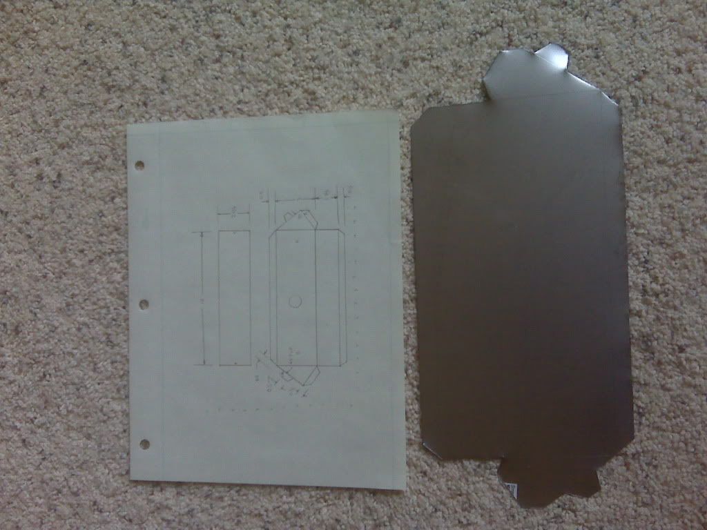

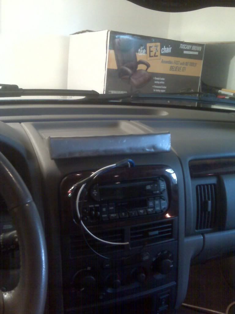

OK, worked on the 120v power a little more...first I tried to make a switch box that would sit on top of the radio.
...mmmm nice. looks like it should work....
...or not. generally it takes more than a hammer and a pair of pliers to bend sheet steel nicely. Back to the ol' drawing board....

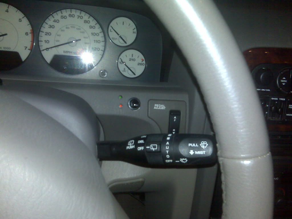

So the switch box idea not having worked, I decided to put the switch next to the movable pedal switch.
That worked a lot better. And this:

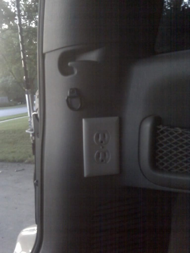

Everyone loves an electrical outlet in a car. Makes it feel homey. If I sleep in there, I can bring a light and alarm clock and it'll be just like home
Still left to do: rewire the front outlet, wire up the rear outlet, remove wiring from the old setup. And then done.
