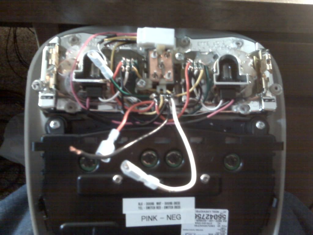

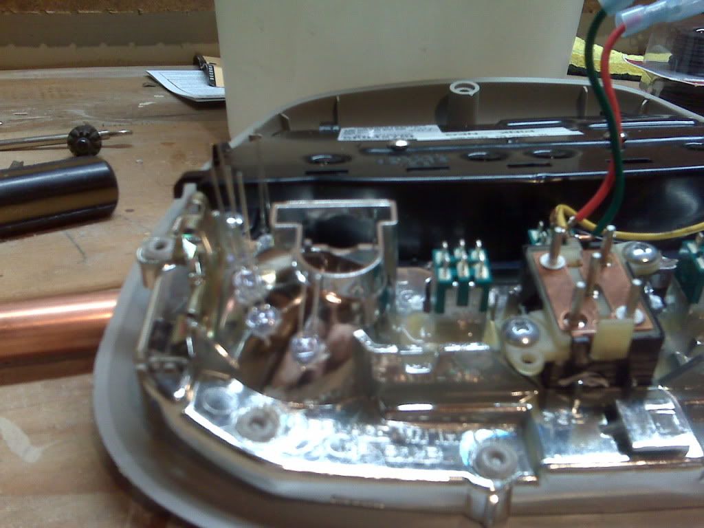

The array works! Now I've just got to wire up the mode switch on the EVIC, and then wire them together.....
EDIT: Everything works!!! Holy cow, I'm pumped!
Here's a little vid of it working:
Here's a couple shots of the EVIC getting wired up:
I still have to make the array for and wire up the right rear map light, and the dome light in back of the Jeep. Then I'll replace the courtesy lights on the doors with reds and we'll be good to go!
for those interested, you need a 470-ohm resistor in series with the LEDs to make them not blow out from 12v...

thx....it wasn't too bad once I figured out a) the logic (how to wire everything so it does what it's supposed to) and b) how to mount the switches. If you're real good, you'll notice I messed it up a bit. When you turn to night mode, the left rear light automatically comes on. Quick solder job will fix that...

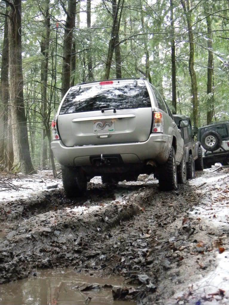

did a bit of wheeling with a local jeep club last weekend.....good times:
Busted up a rocker panel and a taillight. So I'll have some stuff to fix this weekend
