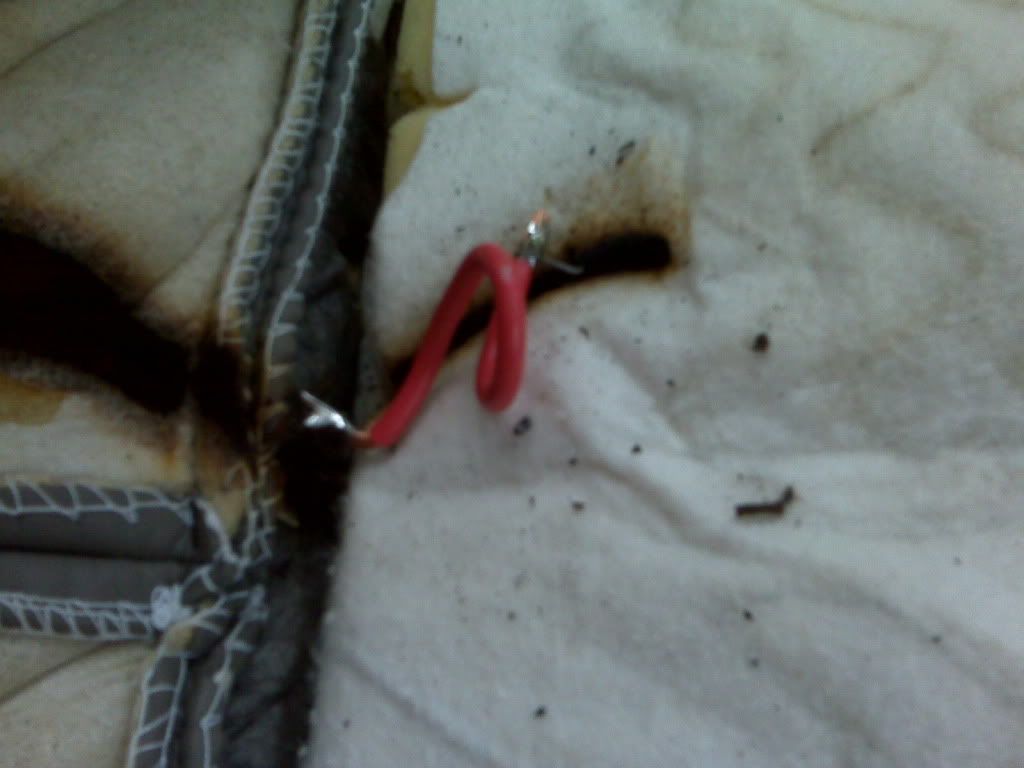

EDIT: there's a recall out on this. I'm going to get the stealership to fix this properly. But this was a nice temporary fix.
EDIT 2: apparently only certain Jeeps are covered, and mine isn't one of them...I guess my ghetto-fab solution stays!
EDIT 3: talked to a guy while waiting for some work to be done on my heep. He recommended getting the tungsten wire out of a hair dryer and using that instead of my 12v primary wire. He thought it'd solder up better than mine did. I think I'll wait for mine to break again before doing that...
EDIT 4: and it fried again. This was a temporary fix.

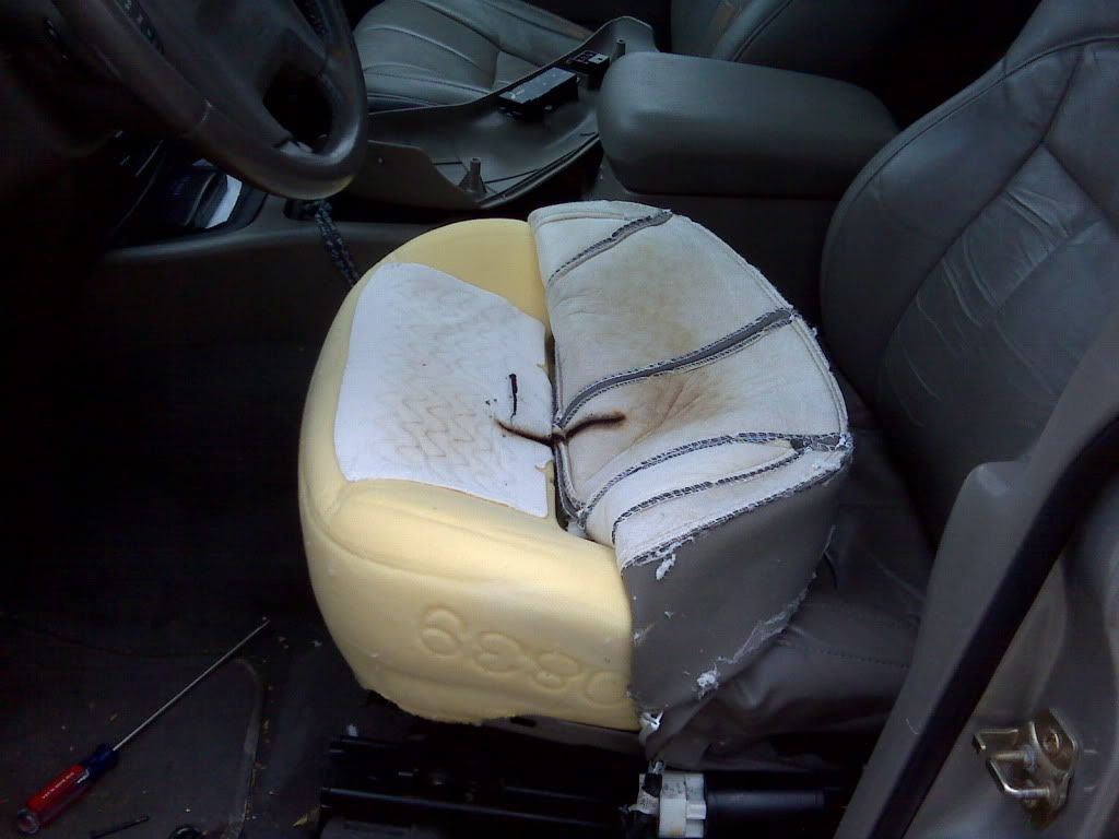

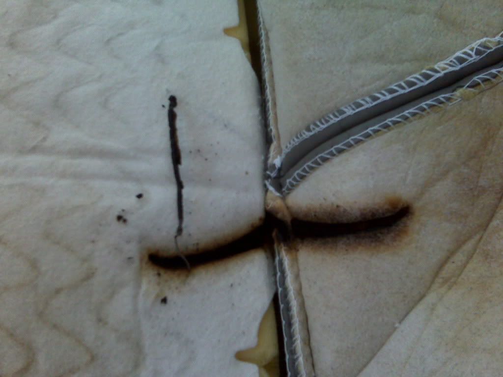

OK, fixed my seat heater (which I call a heat seater all too often). Here's how:
Firs you pull the seat covering off. It only comes off about as much as I've got here.
You can see the burn mark where the wire was doing its thing. I pulled the (charred) wire away from the little heater wire in the white pad and snipped it
and then replaced it with 12v primary wire.
Note: soldering the heater wire and the thicker connector wire was NOT easy. I'm not sure if this was because it had been so discolored/charred, or if it had to do with the makeup of the wire. What I ended up doing is pinching both wires in the stranded 12v primary wire, and then soldering the heck out of it. Seems to have worked quite nicely. the seat also heats evenly now. Nice for those of us with bad backs

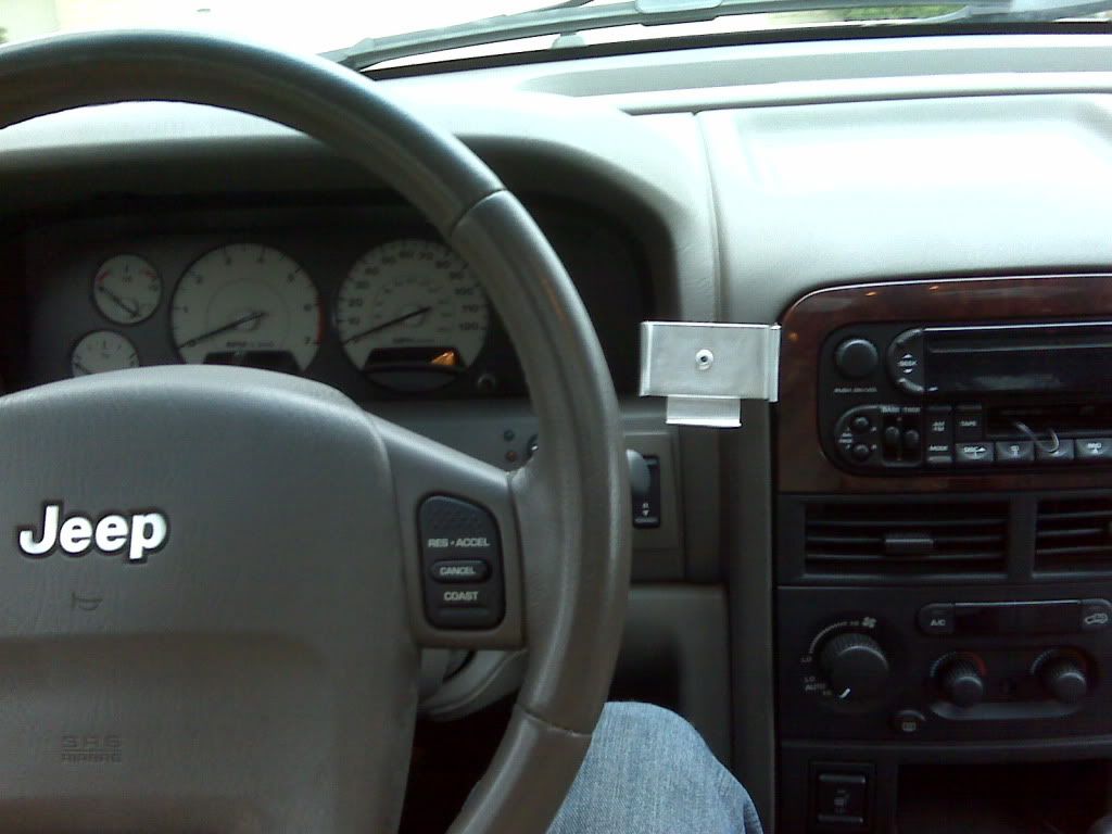

While I was at it, I also built a little cell phone/iPod holder out of sheet aluminum that my dad had lying around.

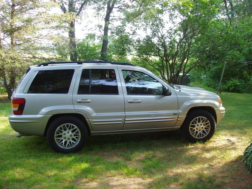

Just looking through some old photos and I found this:
Bone stock. Hard to believe she ever looked like that! It looks so ... small...and .....sleek..........and kinda like a -----*gasp* CAR!

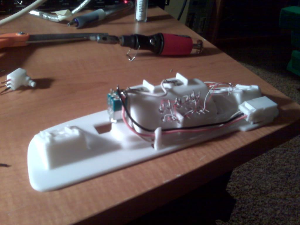

OK. Red courtesy lites:

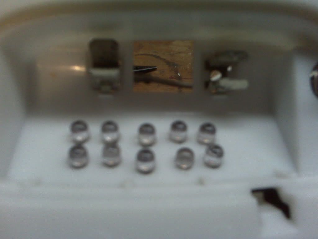

basically all I'm doing is drilling holes in the recesses for the lights, and wiring in LED arrays (a bunch of LEDs in parallel)Then I'll have a day/night mode switch right by the EVIC, that will choose between day (white) and night (red) lights.
Soooo, first I drilled holes. Crappy job, I know. 1) they won't show, and 2) I'll make sure to make them nicer on the other lights
Next, I force-fit the LEDs into the holes.
Then, using a wire-wrapping tool and thin wire (radio shack FTW), I wired up everything in parallel.
Stuck a DPDT switch in there instead of the factory SPDT one, and soldered it up. I still have to wire in a resistor to make sure I'm not going to fry the LEDs, and connect it all to the wiring I did a few weeks ago.
More later, when I get it all running......
