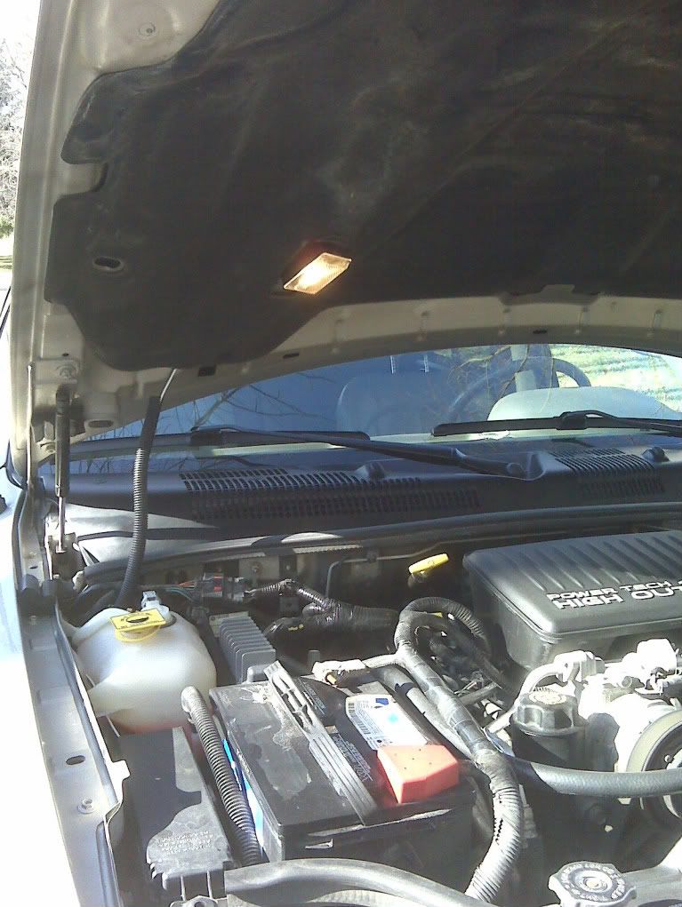

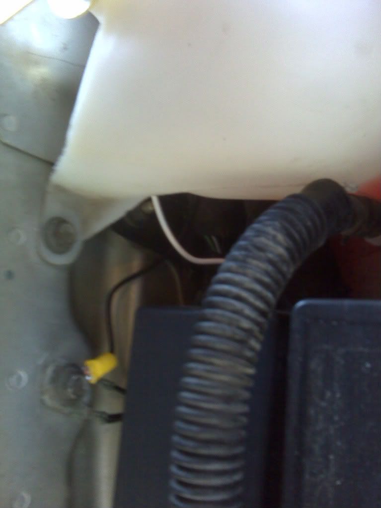

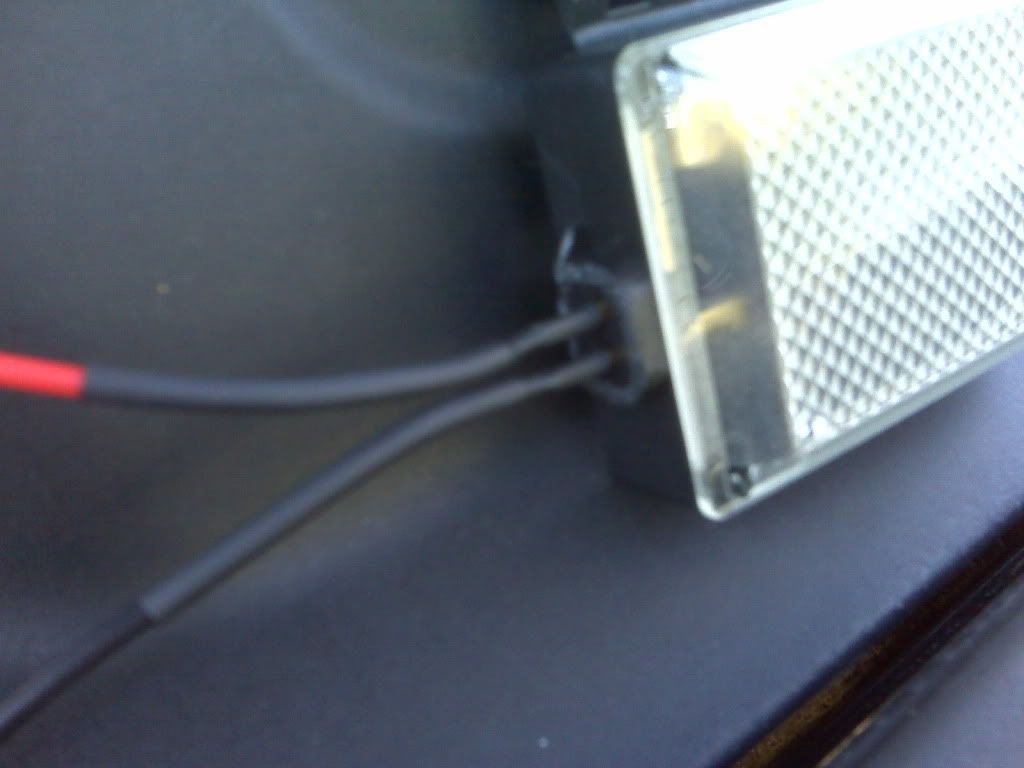

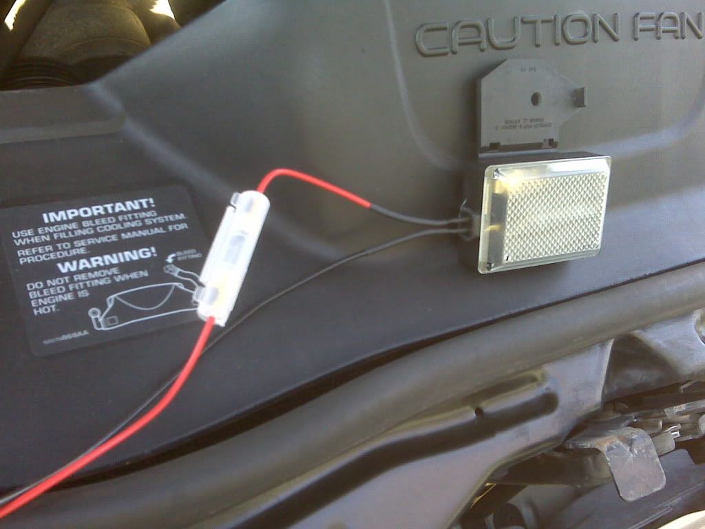

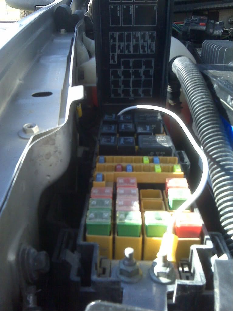

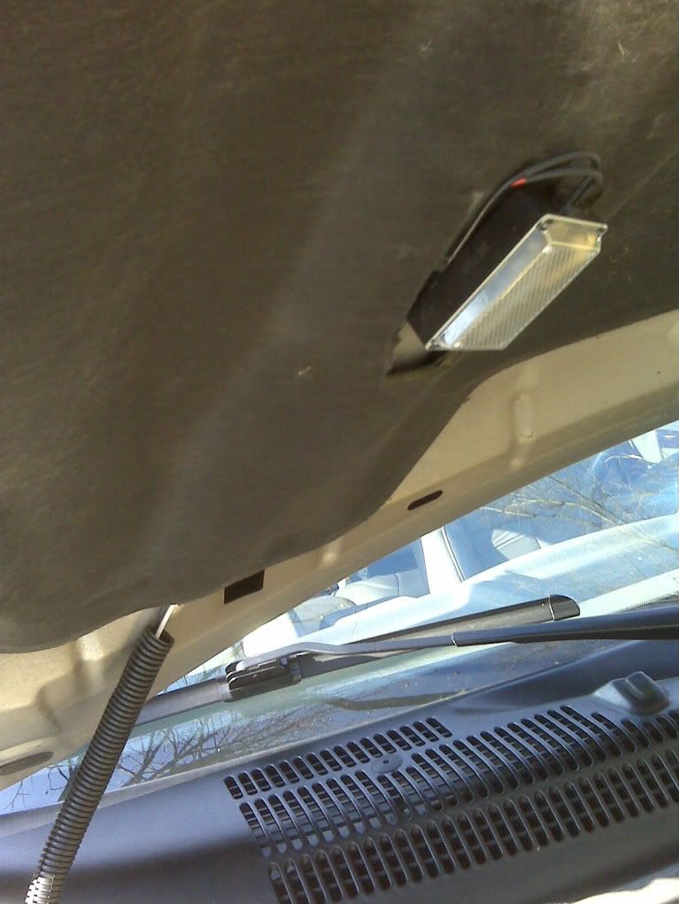

Well, it's official. The switched under-hood light that was on 2001s, and wjjeeps.com claims fits on 2002s also works on 2003s. Here it is:
So first, you have to figure out where to cut the hole in the black liner under the hood. I just looked at wjjeeps.com and kinda guessed, and it ended up working pretty well.
Next, you crack off the plastic around the two pins on the lamp, so you can solder to them. I just used a pair of needle-nose pliers to crack the plastic off. After that, I just soldered a couple wires onto the pins. I also included a fuse, so I wouldn't mistakenly fry anything.
Heat shrink tubing works well to weatherproof things.
Finally, I just routed the wire under the hood liner, through some plastic tubing, down to the fuse box and body, where I attached the wires.
Be careful how you run the tubing, so it doesn't pinch when you close the hood.

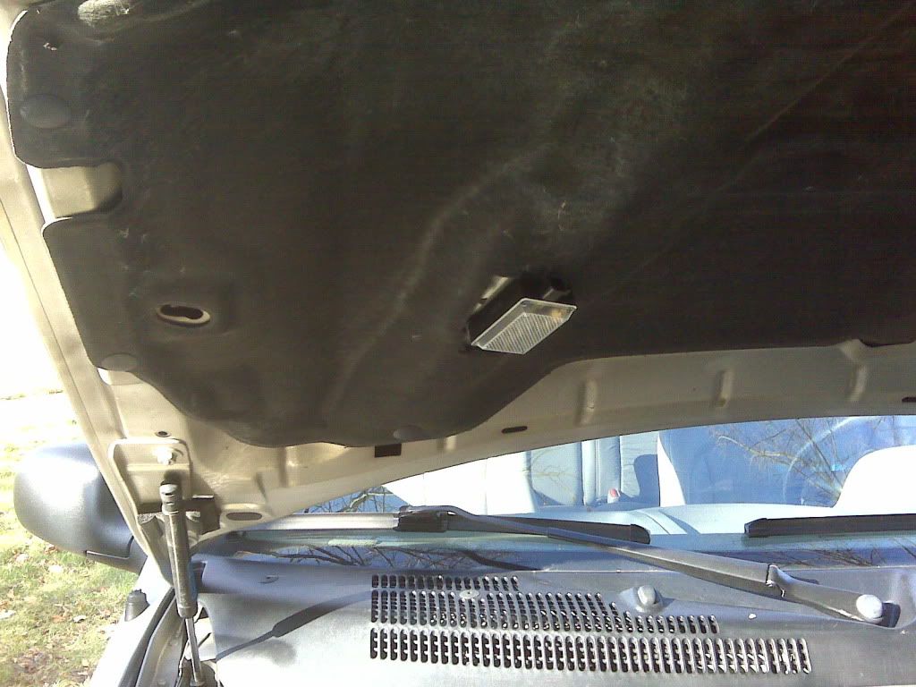

Oh, and yeah, it works:
It also turns off when you close the hood

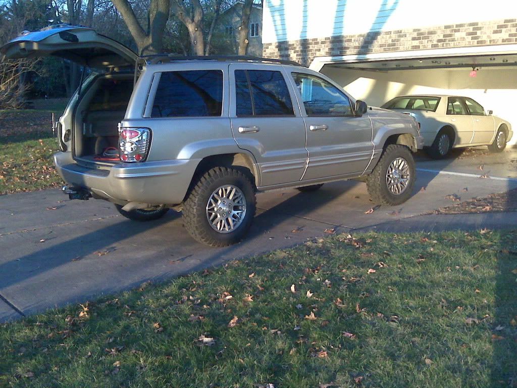

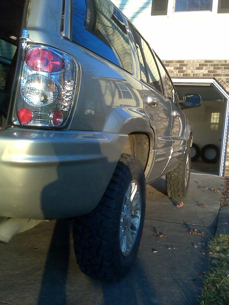

I just got my new tires!!! I LOVE them!
