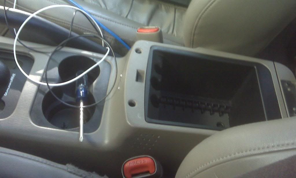

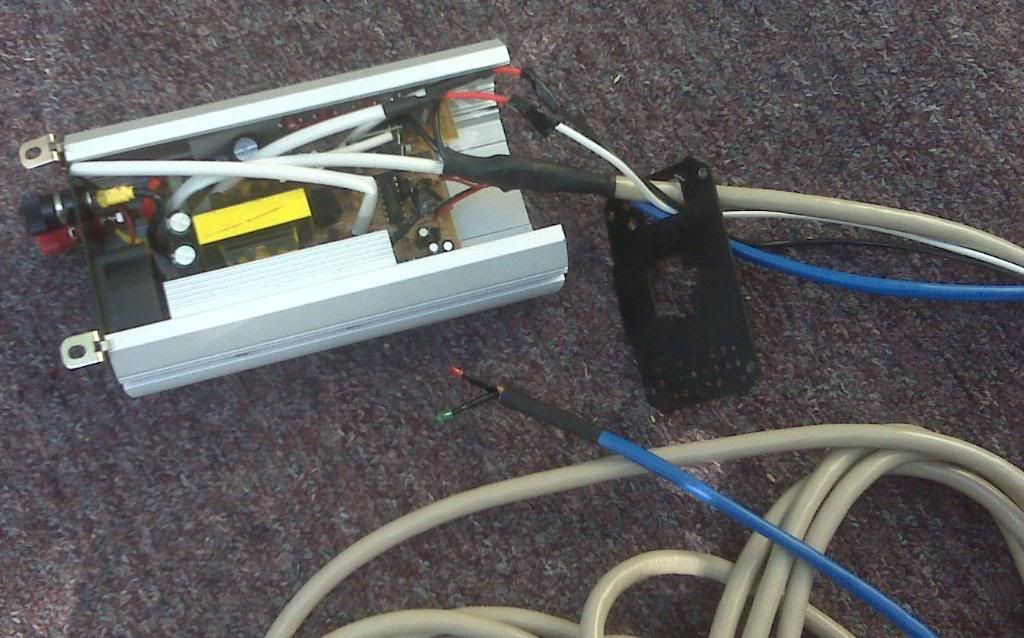

Step 1: Retrofit the inverter with a remote switch and on/fault LEDs.
Only place I could get it to fit was in between the cup holders and the CD box under the center console. That meant that I needed to run power, a switch, and (just for bling) the power/fault LEDs elsewhere. So, I tore the inverter apart (that's what you do with brand-new equipment, right?...I mean, that's what you do with Jeeps. I just figured everything else is the same).The fat tan cable is 120V power, the blue cable is cat5 cable that powers a couple status LEDs, and the black/white pair are for a switch.

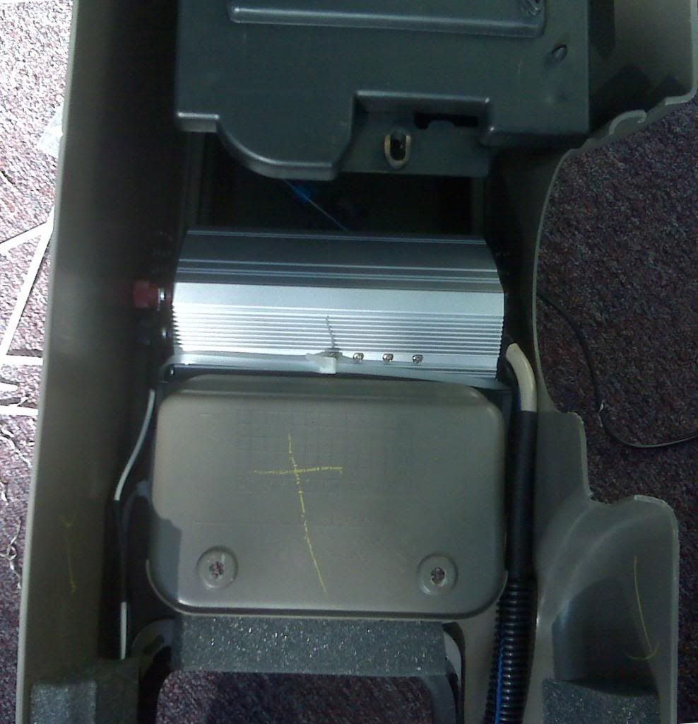

Step 2: Install the inverter
Tight fit, which is part of why I hacked up all the inverter's insides and ran all those cables. I'm holding it on with zip-ties. It seems to have done the trick very nicely.

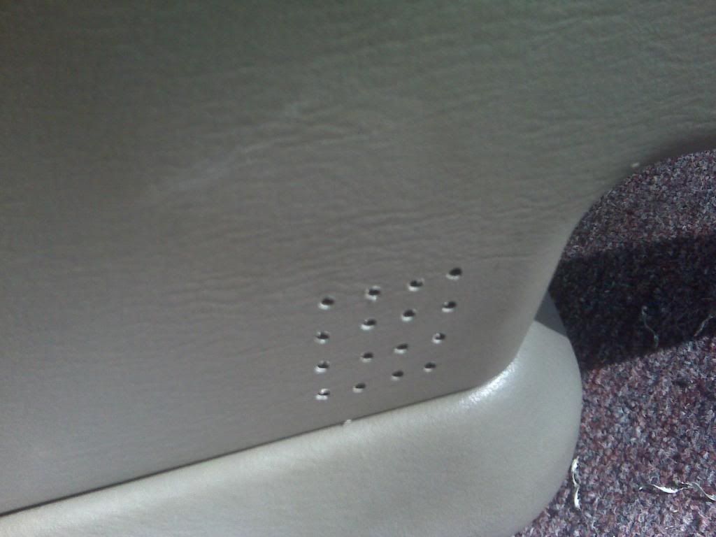

Step 3: cut some ventilation holes
Nothing too fancy here, just 16 1/8" holes on either side. It doesn't offer much ventilation, but it's better than nothing! If I end up needing more, I'll probably just drill the holes bigger.
Step 4: Put the console back in the Jeep
*whew, it fits* and DON'T twss me. I also had to re-route my USB power cable, which fits very snugly right above the inverter. Getting the console out was a bit of a pain, but getting it back in with the inverter in there (and therefore 2 lb heavier) was really weird. You'd think 2 lb wouldn't affect how easy it is to maneuver inside the Heep, but it did...

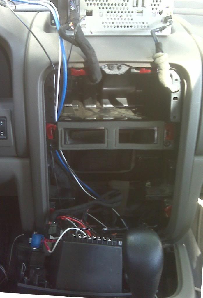

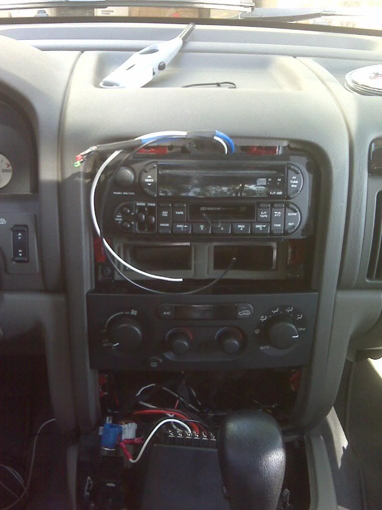

Step 5: Route all the cables. eek!
the tan one's 120V power, the blue one's LEDs and black and white are the switch. There's also another black/white pair that are power to the inverter. They're hidden by my pants
Forgot to buy the sheet metal to make a nice little switch box right above the radio. The LEDs and switch will sit there when I've made that. For now, I just let them stick out above the radio.

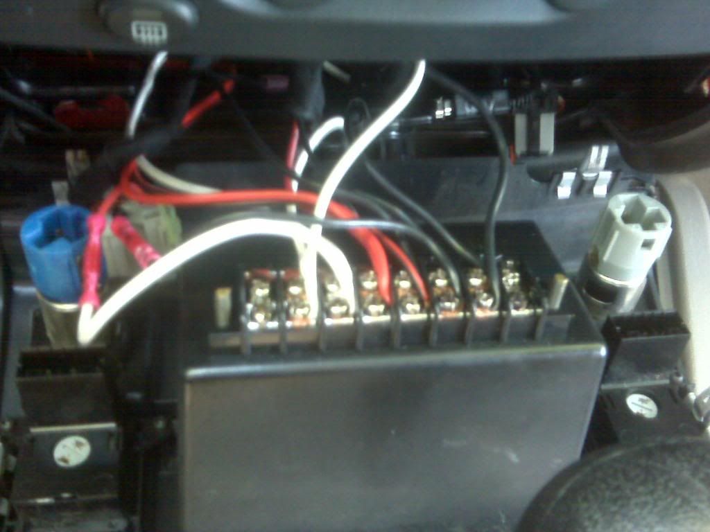

Step 6: connect the power
Finally I tied the whole thing into my power block that I hid behind the dash. Sorry, fuzzy pic.

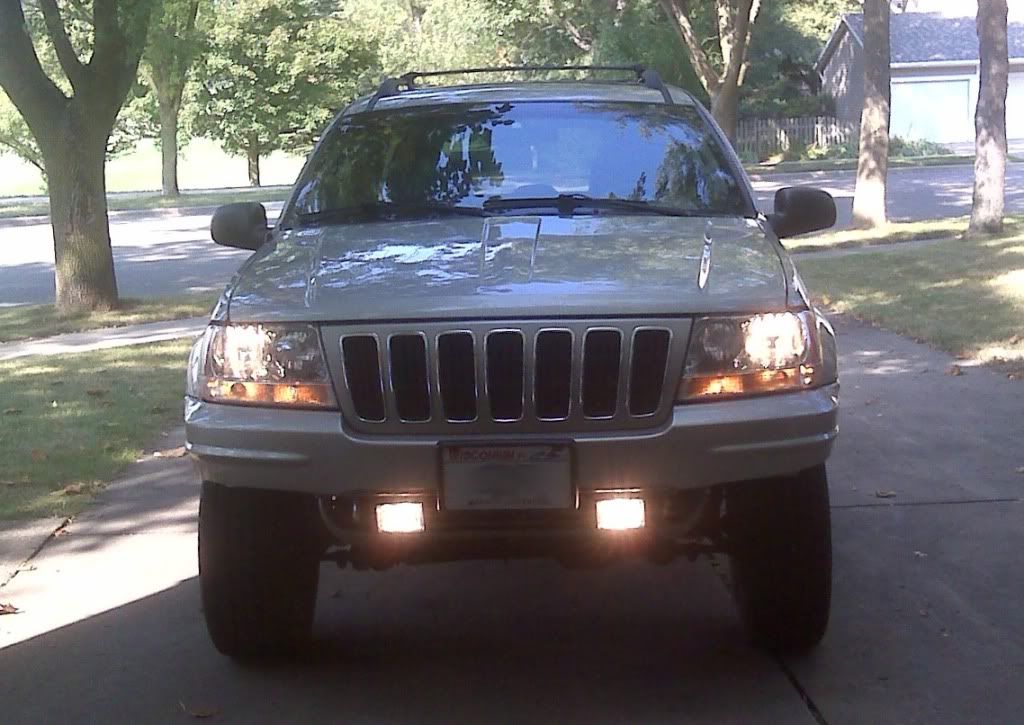

That's where The trick I used (although it doesn't really show up that well in the pic is to follow the indentation around the lower 'grill' part of the bumper, instead of just cutting it straight across. It makes it look a *little* more OEM that way.....
It's funny, I drove through town today, and there happened to be an event going on. I had a couple guys just stop on the sidewalk and stare at my heep as I drove (ok, crawled -- the traffic was bad) by. I get that every once in a while, but honestly, it doesn't happen much. A bit of an ego booster
Edit: If I save up enough money I might mount a pair of big circular driving lights in front of the grill...but I've been spending way too much right now, and I still need to save up for my Christmas present (tires, new TPMS'es and the little box dealie that fools your speedo into showing the correct speed when you have outsized tires)

yup. I was expecting to have to drill, but I found those holes and just stuck the lites there. The cool thing about the Jeep engineers is they thought of everything, even down to where modders might want to put auxiliary lights!
