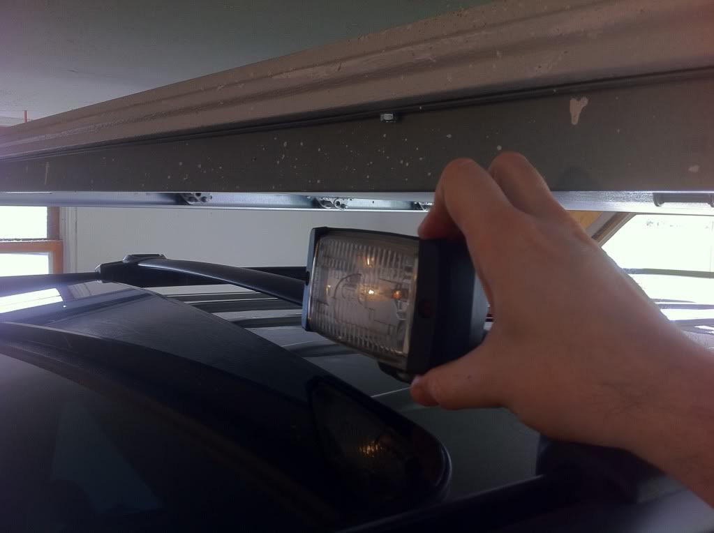

and something else I'm thinking about...
They'd clear my garage door by 1" and my sunroof when it's open by 1/2".
