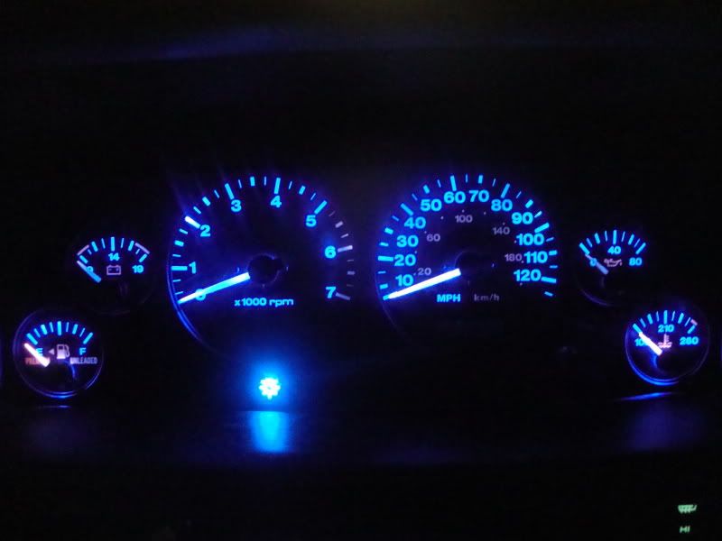

Originally Posted by jlipka98zj View Post
Correct, that is WITH a sunroof. I have only owned two ZJ's and both of them are/were '98's with sunroofs. Since the non-sunroof jeeps have map lights similar to the front, I would agree that you probably need (4) ea 212-2 bulbs and neither the 561 nor 921 bulbs, as you said. Can anyone confirm?
That 561 bulb you linked to is pretty nice. Cheap, too. Since my post, I have found some more 561 bulbs. Try about halfway down this link:
Festoon Dome Lights
You can get some larger arrays to fill out your lens better. Note, the some 561 bulbs may be a little loose on the "posts" that the bulb secures to in the light. Loose enough that the light would flicker when opening/closing doors. I just bent the rigid loops of the bulb to hold it in there tighter.
Every indicator light on the gauge cluster (with the exception of the turn signals) is a 74 bulb. I got all the correct color ones for all the different idiot lights that could come on (amber for ABS, green for cruise, etc). The color gets slightly more "brilliant" but you won't notice a difference on any of them except for the turn signals. You get a much "crisper" flash with LED turn signals. Oh, and I went with low-power frosted lens LED's for the turn signals so I'm not blinded everytime my blinker is on, LOL.
glad to see somebody else knows their stuff
the only thing is, i dont like mixing bulbs from different palces. Iv noticed before that sometimes there are different shades of blue. ive been around autolumination a few times. id say V-LED and superbrightleds are the best. V-LED is just really expensive
Originally Posted by vonericsen View Post
i want pics of the green lights too because i am wanting to do that sometime in the future and i think it'll look awesome
it would probably just look stock but brighter. boring if you ask me.
im sure you could throw colors behind the blue filters to manipulate them.
like when i put a blue bulb behind a red filter, the light output was purple

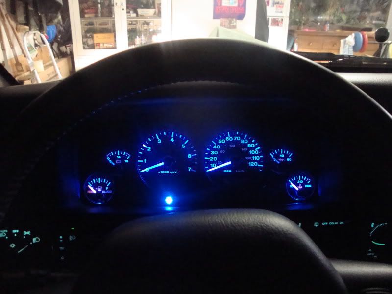

leave it to the blackberry to take the most accurate pic of my guages as far as color goes. this is how they look in person. a nice deep blue.

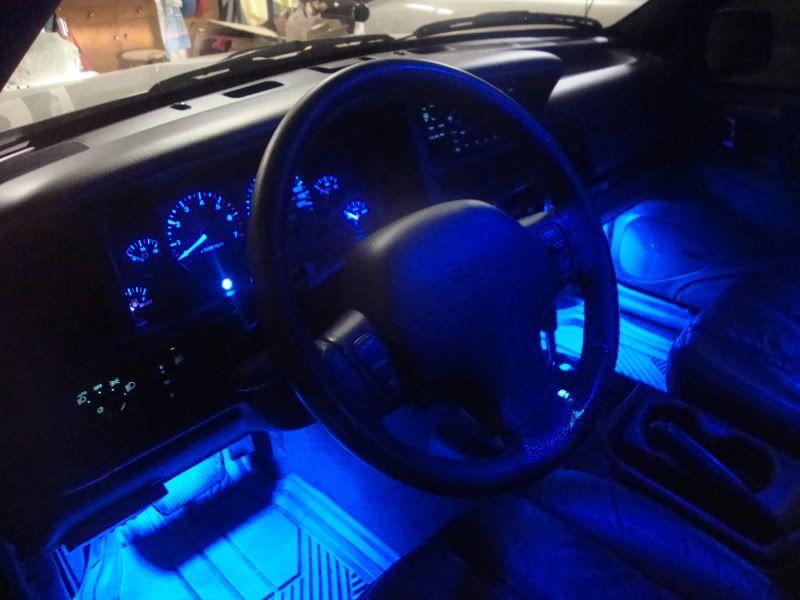

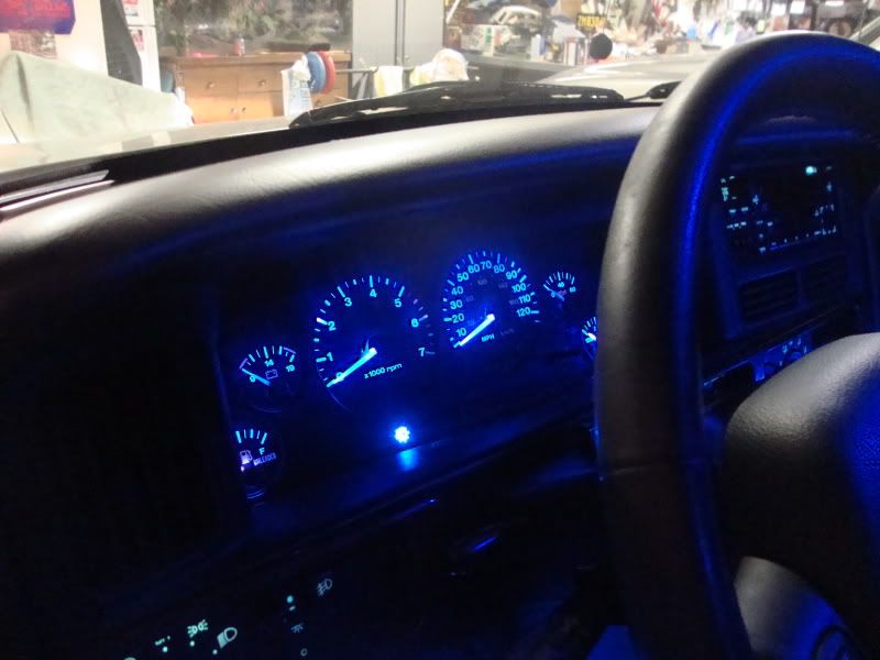

My Gauges:
Also have LED's in the turn signals (in the dash).

Yerfdog, how did you manage to install your LEDs and not have any hot spots?
