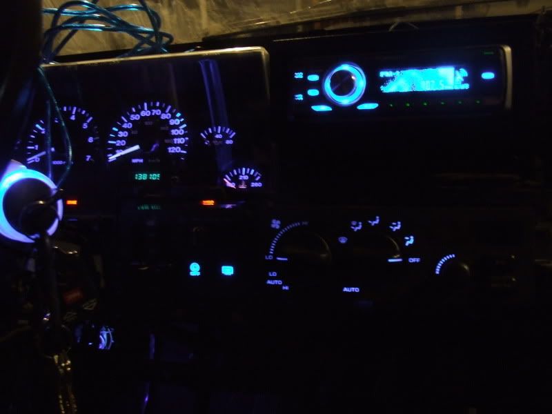

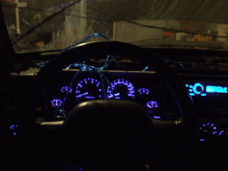

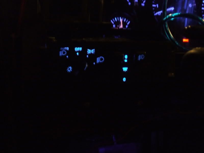

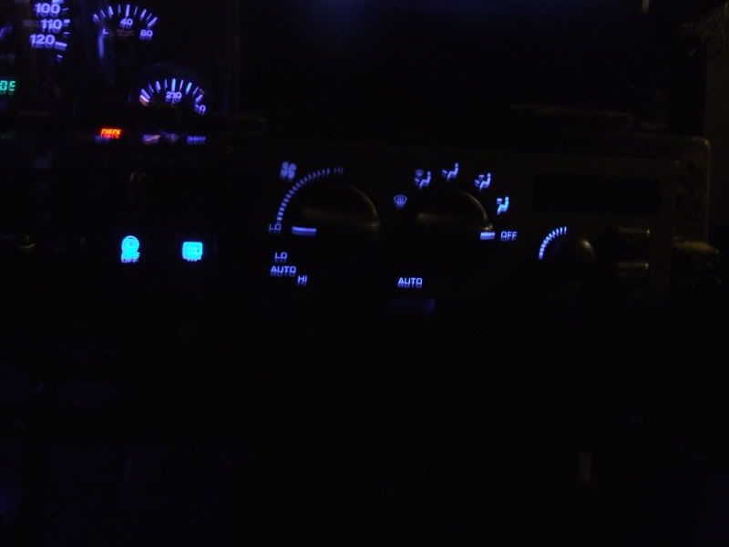

i just did mine! they look awesome. pics are uploading
How did you get the more even look in your dash, I wasn't too fond of the focussed light on the other one?
Id like to know this as well.
1997 Jeep Cherokee 4.0 Automatic NP231
subliminal is offline
post #72 of 219 Old 02-11-2010, 08:32 PM
2GRND4U
Location: Lethbridge
Posts: 101
I think because the OP used "white" leds and BlackZJ as well as myself used "blue" leds.... My heated seat control module is brighter than the others but thats because the led's sit closer to the front of the module than the rest.
couldn't tell you to be honest, just put the leds in and they worked?
