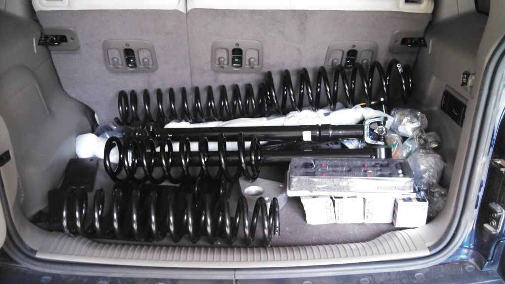

So the lift kit came a couple of days ago. First impressions are this: Control arms = beef, springs = big and heavy, kit as a whole = win. Here it is in the back of my moms KJ awaiting installation next week.
If you look carefully, you will also see a new front driveshaft and somewhere in there is a SYE. The tires are also being shipped soon
