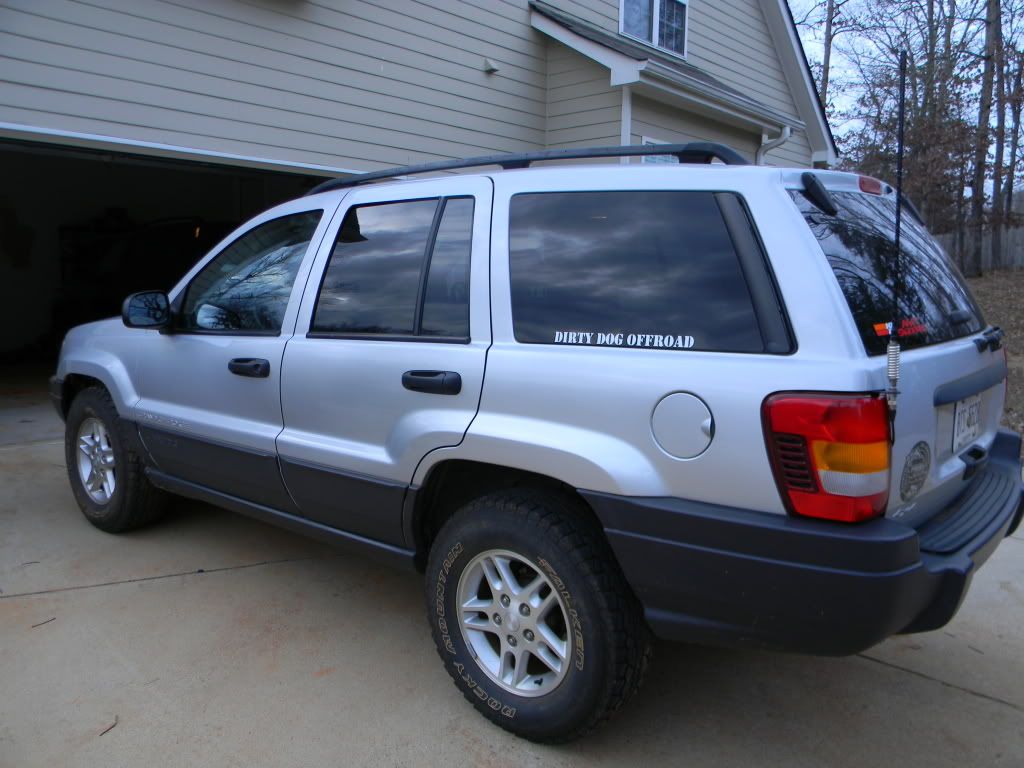

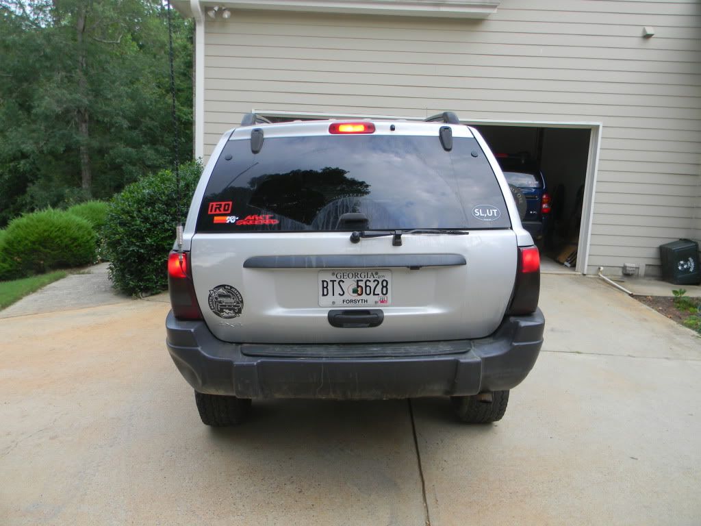

I got this 2003 Grand Cherokee a little over a year ago and since then I have been using what little money I have as a highschooler to get some upgrades for it. This is what I started off with. A bone stock WJ.
I wheeled with it like that for a while on street tires

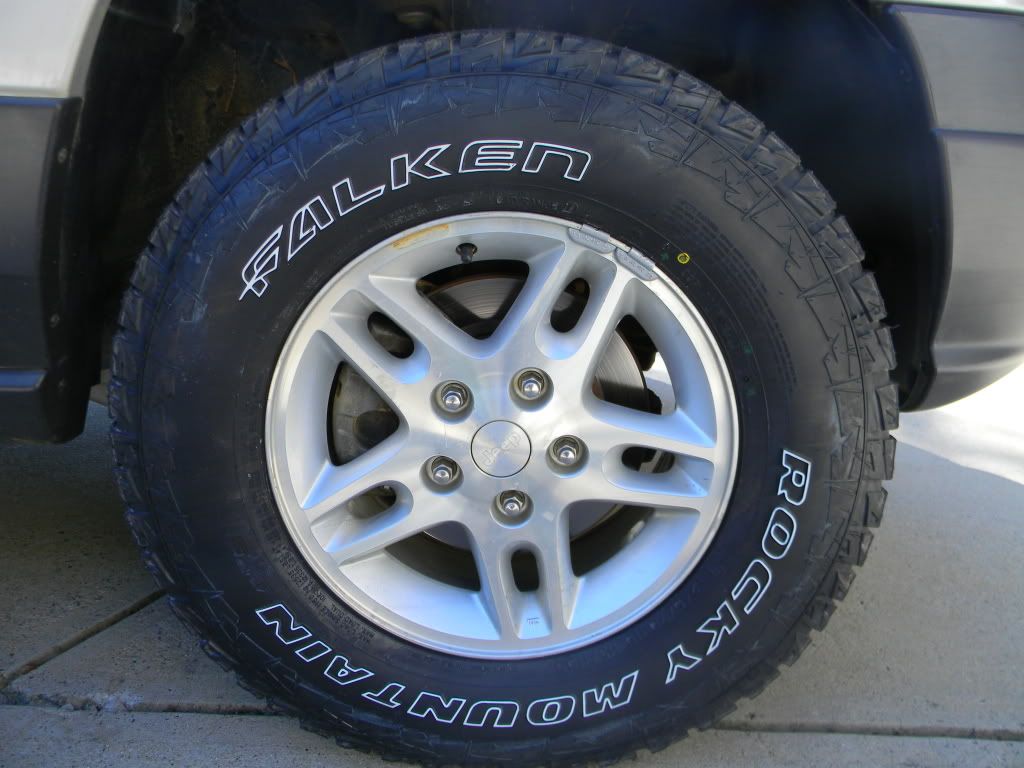

After that I dumped 850 bucks on some 245/70/16 Falken Rock Mountain ATs. I went up in size from the factory 225/75/16. I was suprised at what a change it made in how the Jeep looked. It made it look more like a trail rig with the more aggresive tread.

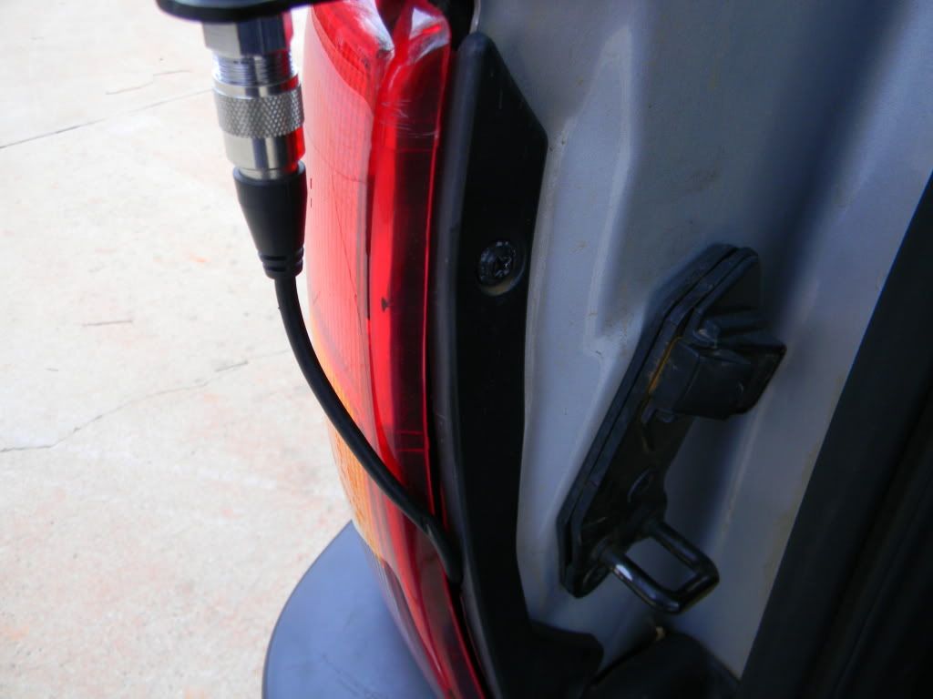

After that I got a Uniden CB. I made a custom mounting plate that goes above the tail light. The only thing wrong with this setup is that I need a softer spring and a longer antenna.

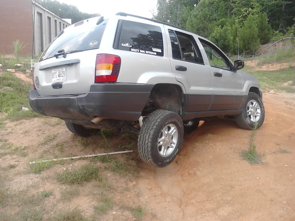

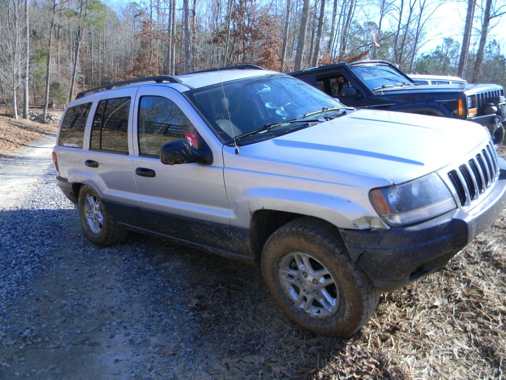

After that I got to experience my first ever trail damage when I lost grip in the front and and slid over into a tree.
I then got an IRO 3 inch lift. It has tons of flex and I am very happy with it

looks good man, how you liking those tires? thinking about getting some Falken Rocky Mountains too

I like them a lot. They are good on the rocks, and on the street. They clog up in the mud though in typical AT fashion

Nice! I'm in the same boat! High schoolers budget! I'm working on mounting my antenna you bought that bracket or made it yourself?

I made it. 1/8 inch steel. Cut it so that it goes all the way to the back of the tail light housing but leave enough sticking out to mount the antenna. Put five or 6 sheet metal screws in and you are good to go! Don't forget to paint it and you may have to trim the tail light bezel to get it to fit. I didn't but depending on how you are wired up, you may have to.

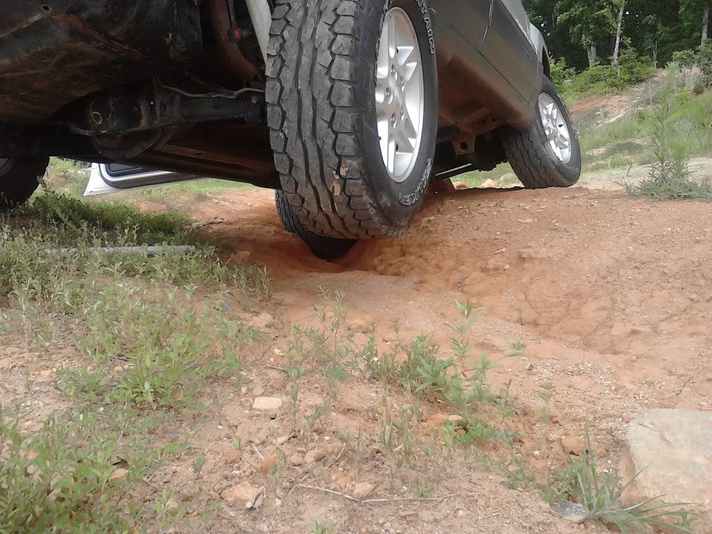

Took the Jeep to a local rock garden today to have some fun. Didn't get any pics of me on the rocks. The front end was connected here btw

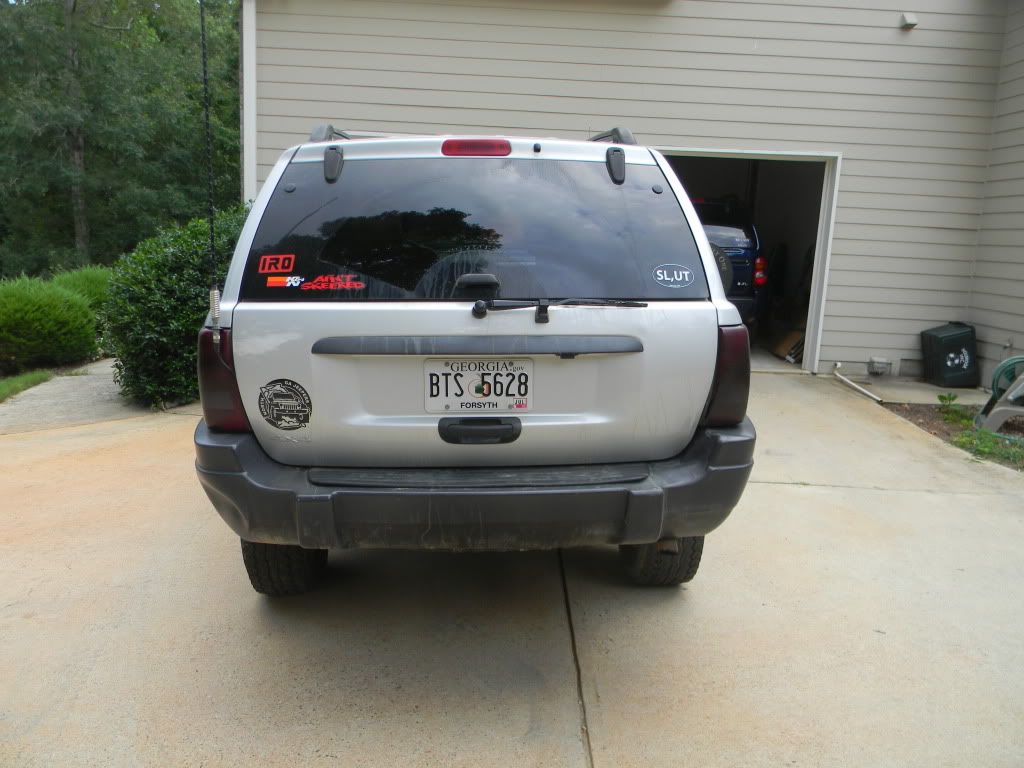

Well here they are. Fully blacked out LED tail lights for under half of the cost of any online ones!
Turn Signals
Lights On
Brakes Applied
Reverse

Haha, I sprayed them with the clear, and you can't tell in the pics, but they look semi-shiny in real life, and they actually look just like I wanted
