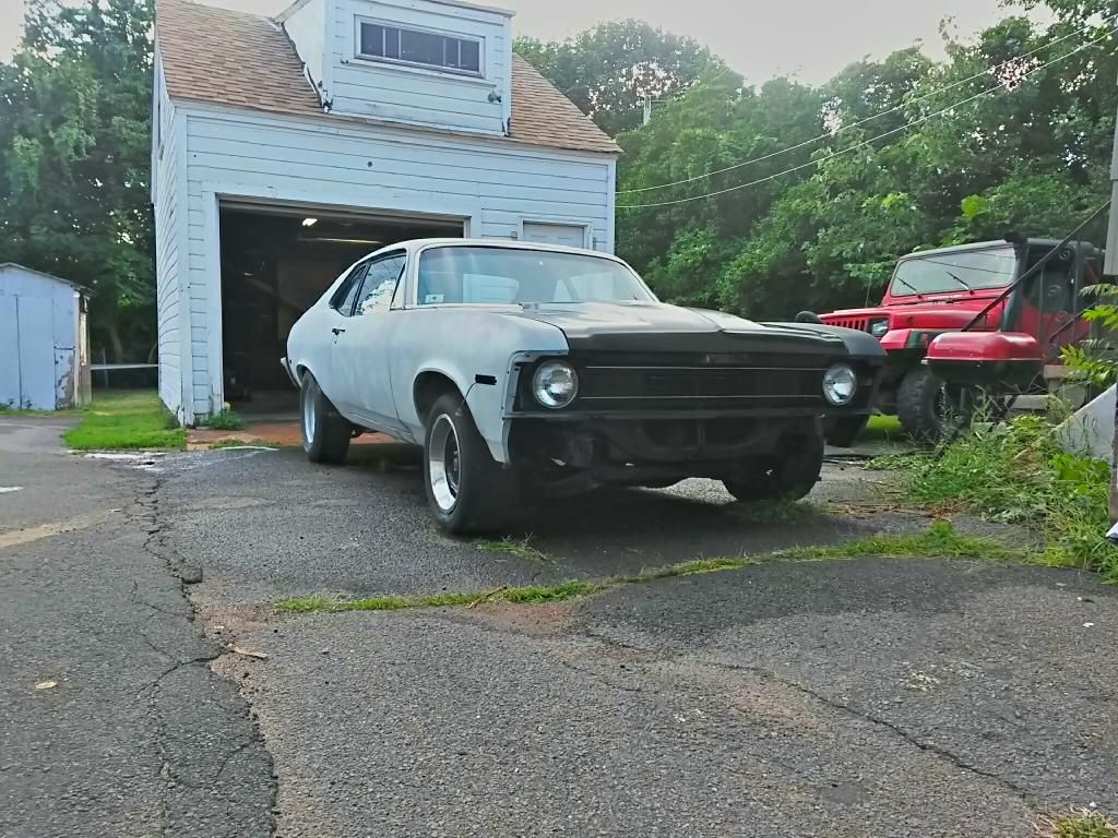

I traded the GTP for a 72 Nova that's been sitting in my garage.

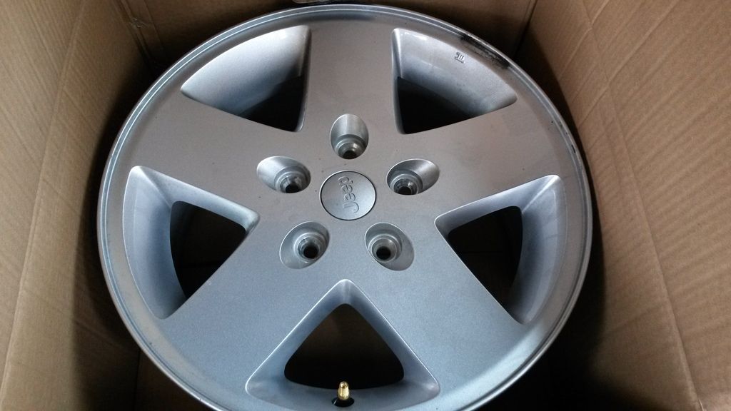

I want to fit some 245 70r17 all terrains on the 17" JK moab rims I picked up without much, if any, trimming. I already bought 1.5" hub centric wheel spacers and installed them with the stock rims

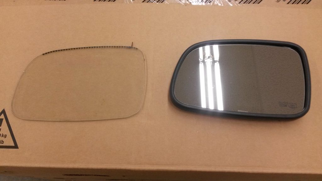

First up was the driver side mirror. It was looking like a fish bowl because the auto dim liquid started leaking out. After looking up the repair in this section, I was able to fix it in no time

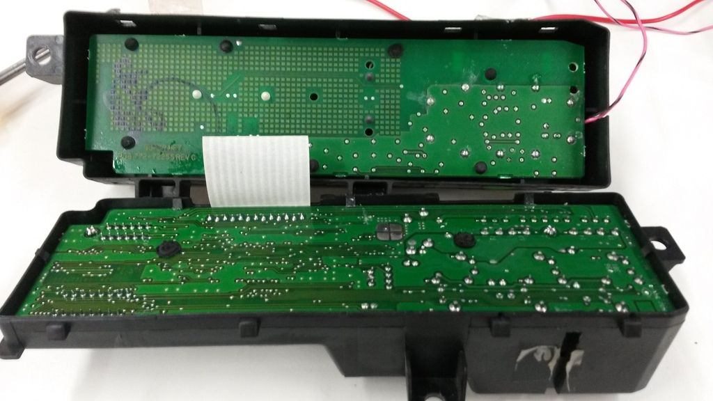

Then I attempted to fix my no range key fob by extending the wire which didn't work. And then I took the whole assembly apart and replaced the whole wire , which also didn't work

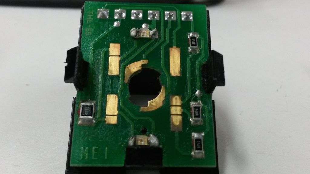

I was able to replace the surface mount LED lights in the heated switchs

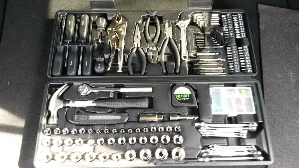

Picked up a little tool kit and some jumper cables to keep in there

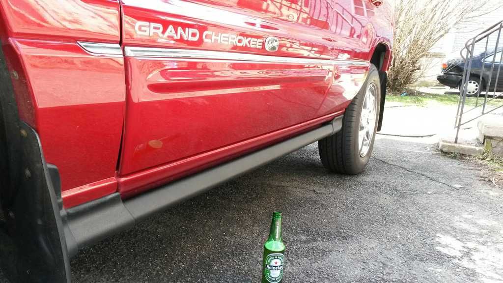

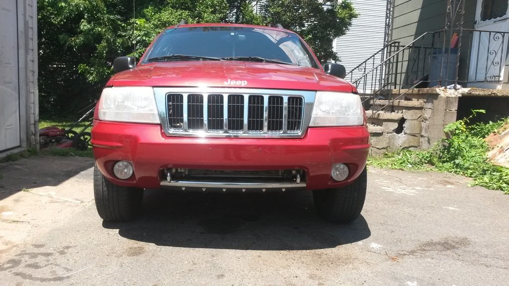

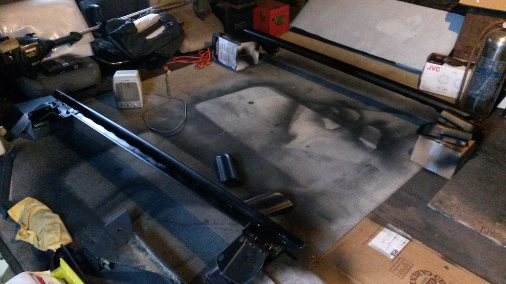

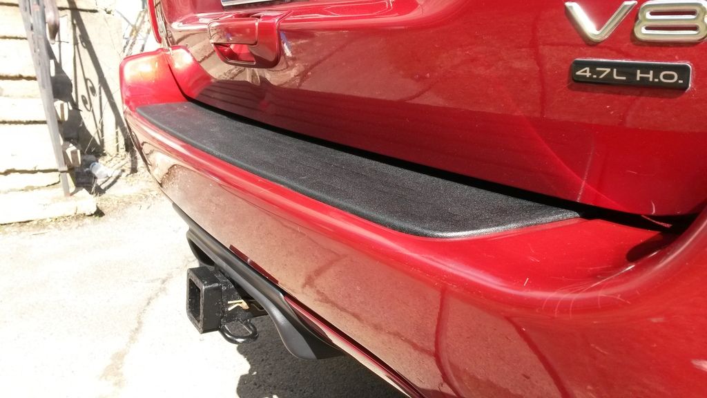

So here things get a little more interesting. I decided to paint the factory rock rails and rear step pad with black bedliner
I really liked the factory sound system but it was lacking an aux input. So rather than swap out to an aftermarket headunit, I followed the write up here and installed one myself. ( no pics as I was using parts from work and had to diagnose what was what)

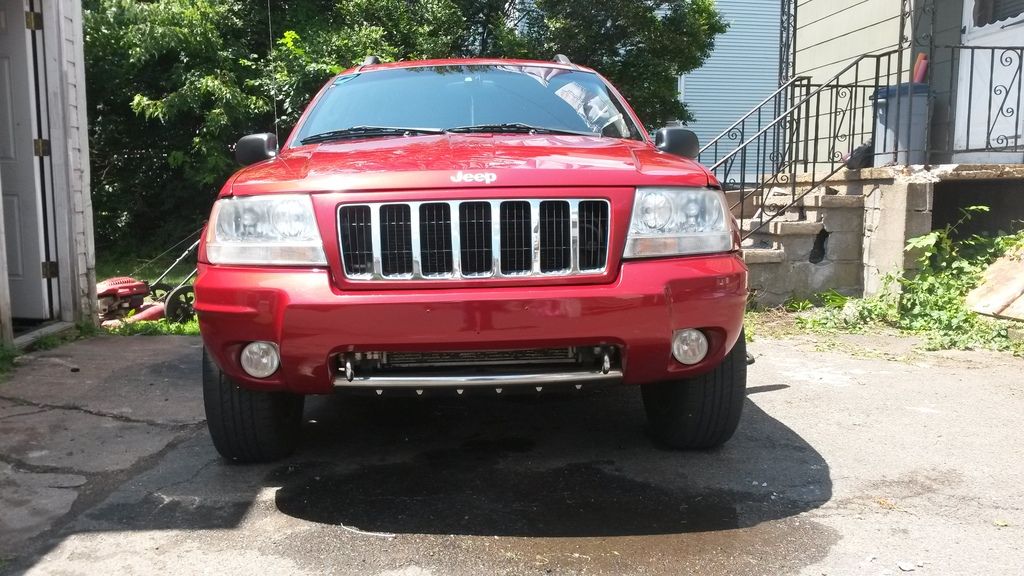

Just this past weekend I swapped out my all chrome grill assembly and installed a body color matching outer grill bezel. I'm not a huge fan of chrome and I feel like this is a happy medium
Before
After

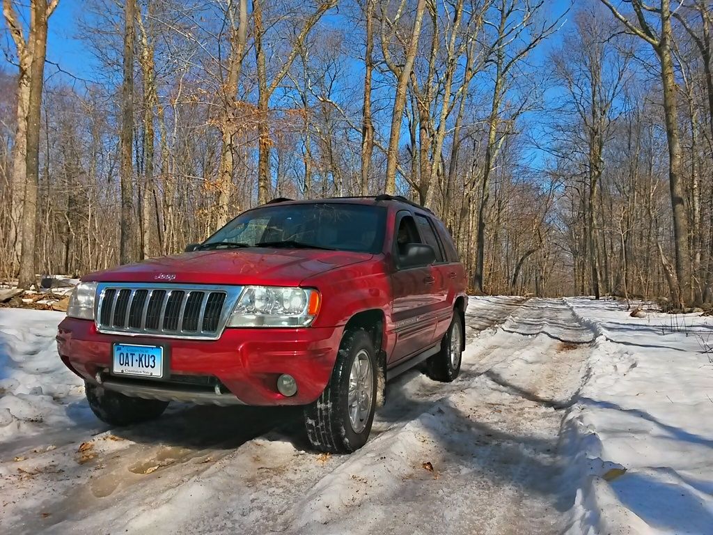

Other than that, I've taken it down some easy trails
And I think we're up to date. I'm sure I forgot something here or there and maybe not all the pictures are in chronological order but there it is. I'll add in things as I remember them and try to keep this thread updated whenever I do something

Checked the pan this morning for leaks and freaked myself out lol the new paint on the pan was so glossy it looked wet. But luckily everything's dry for now.
I went back to the garage to clean up a bit more and also weld the cat shield. I noticed yesterday it was rattling so I just threw a few tacks on there and it's good to go.
While I was under there with the wire brush, I hit a couple spots where I saw surface rust forming and sprayed them with Loctite rust neutralizer
