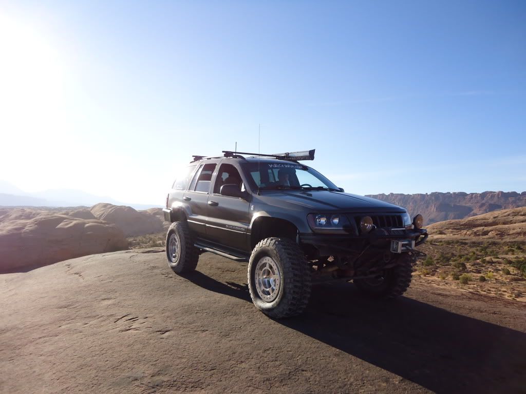

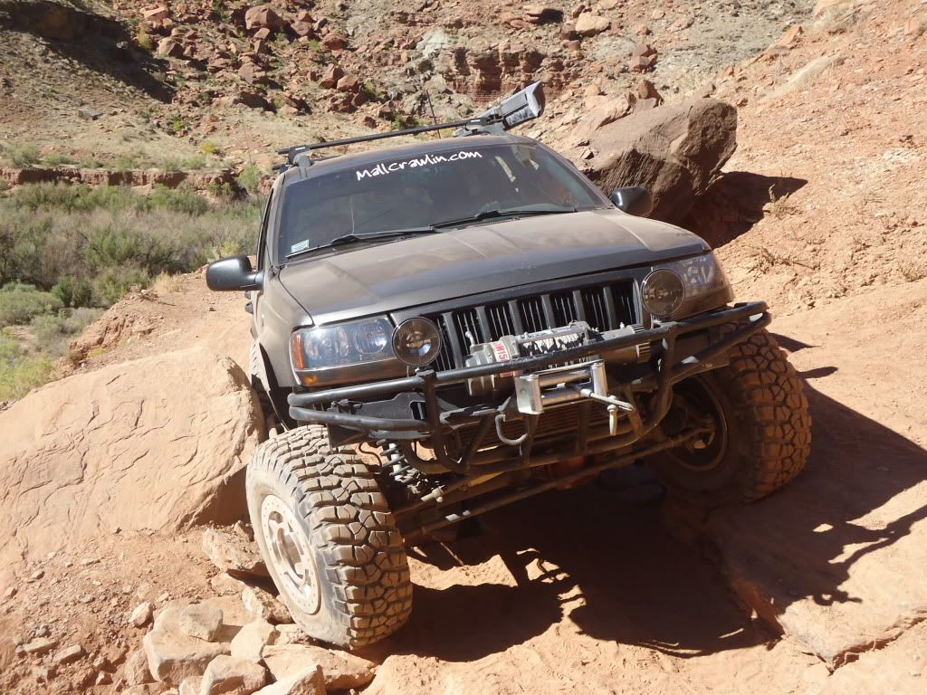

Went to Moab this past weekend and meet up with some JF people. Had a blast! Ended up running Hell's Revenge, Potato Salad Hill, and Kane Creek. Some photos from the weekend.
Hell's Revenge
Kane Creek

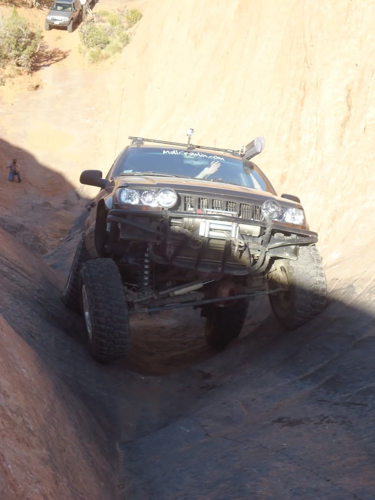

Potato Salad Hill

damn those spyderlocks are sexy

Thanks. They have been taken a beating lately. The outside ring makes contact with rocks a lot. They have definitely got used this year. I wouldn't recommend them if you want your wheels to look perfect. Once I clean up the jeep, I will get some photos of them.

how many bolts are your beadlocks? any problem with them losing air or balancing?

What PSI are you running in the pictures?

It's 24 bolts. No problem losing any air at this point. I go out once a month with a torque wrench and check every bolt. But that is just part of owning beadlocks.
As far as balancing, I have 8oz of balancing beads in each. Now, let me elaborate on the balancing. My jeep has only seen very little road use. It gets trailered everywhere so I have no clue on balancing at high speeds. I have gone 60 before and everything seems good. That is the most honest I can give on balancing.
With that being said, my plan this winter is to get my jeep drivable for long distances again. When I researching beadlocks, I found that balancing these along with many others was very doable so don't get discouraged about balancing them.
I have 8psi in them most of the time. Sometimes I put more depending on the situation.
