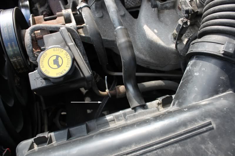

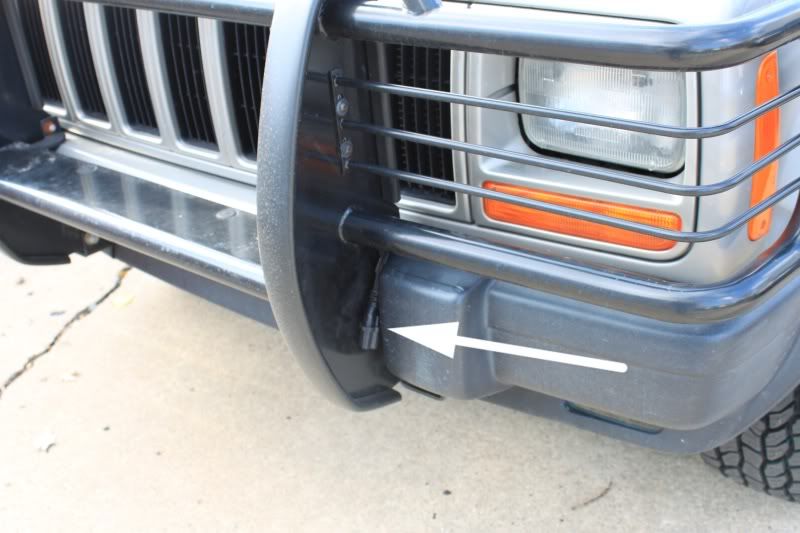

For the winter months: 5w30 motor oil, an engine block heater, and a remote starter and you're good to go! Use the block heater as much as possible as a warm motor puts less stress on everything during start-up but remember that even in the coldest weather only a couple of hours is all that is needed to warm the block; anymore is just wasting electricity.
From my engine block heater install (overly simplified):
1). Drain coolant (best to do during a coolant change)
2a). Take some stuff apart and out of the way...
2b). Knock OUT (not in) the frost plug.
3). Install block heater.
4). (Put stuff back together) Refill coolant, start motor, and check for leaks.
5). Plug in heater and check that it heats up (you'll hear it) Note: never plug in the heater without any coolant in motor as it will burn up the heater.
