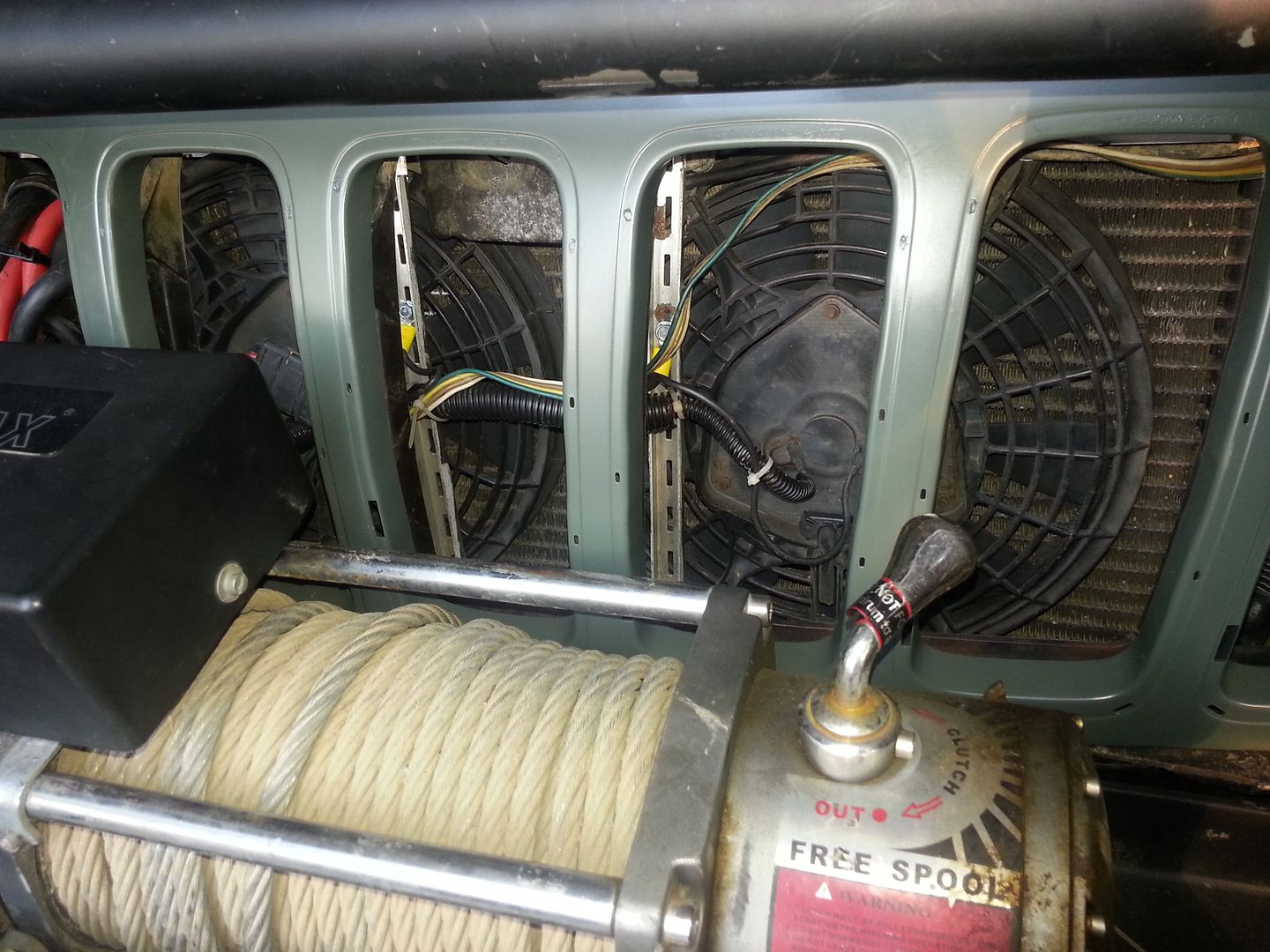

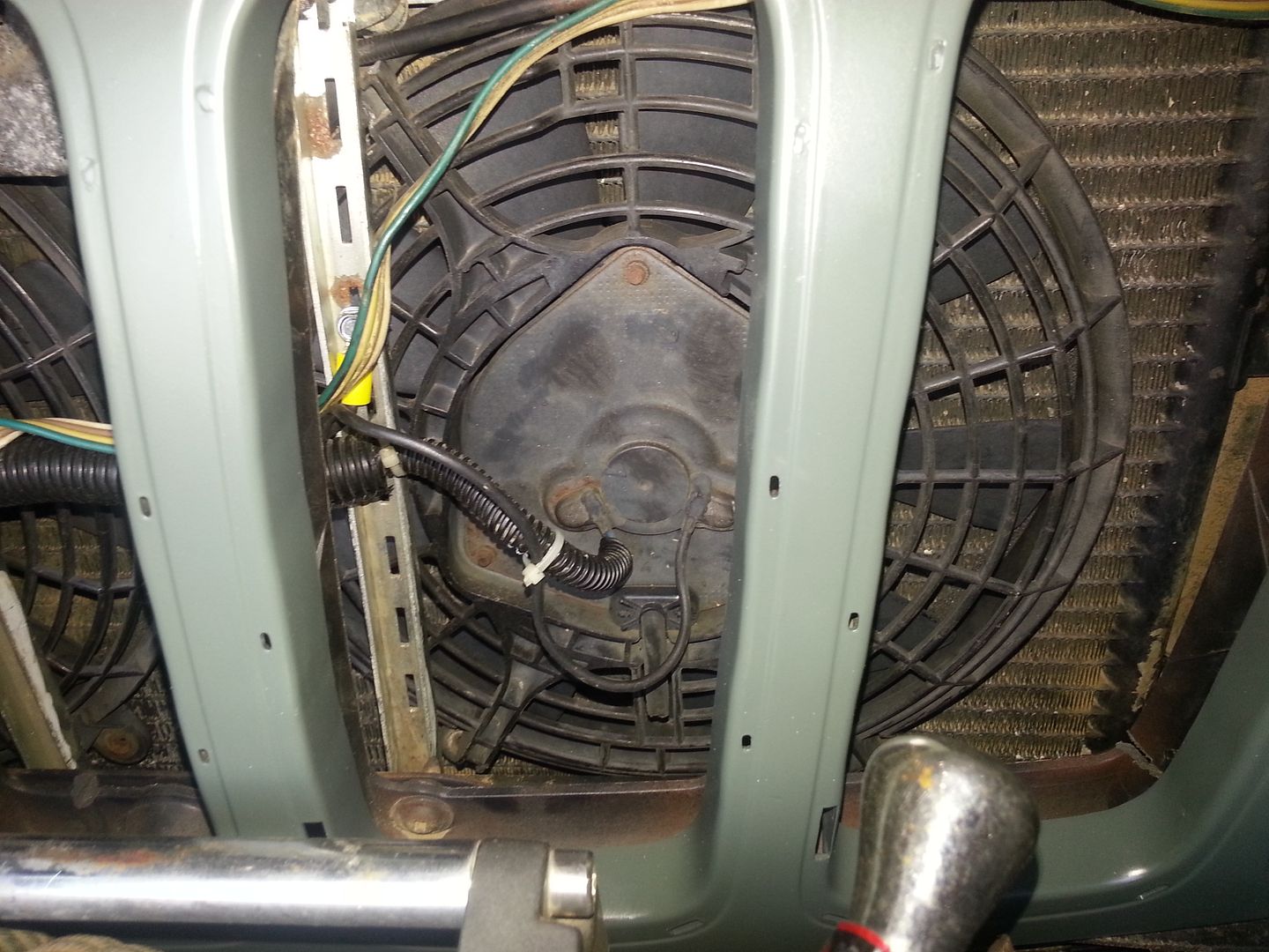

Drove it around this weekend and the temp stayed a little above 210 most of the day. It usually stays below 210. So I swapped the thermostat out (Original) and got around to installing the the aux fans I got from the JY a couple years ago.
They are of a 4L Land rover. They push a lot of air and turn the stock fan when they are on.

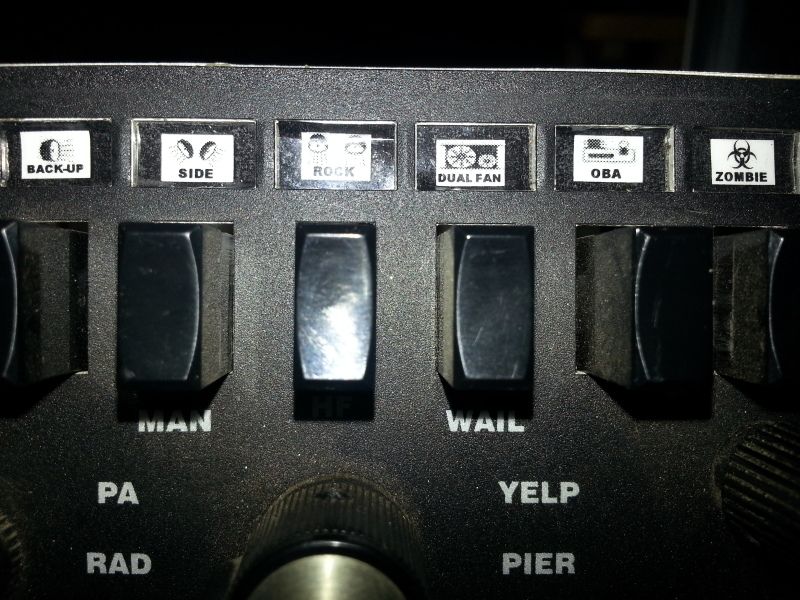

Wired them up to come onto with the stock fan and or by themselves with the switch on my Whelen controller.
Drove it around today in 100+ temps and didnt go over 210.
