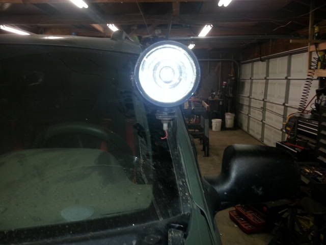

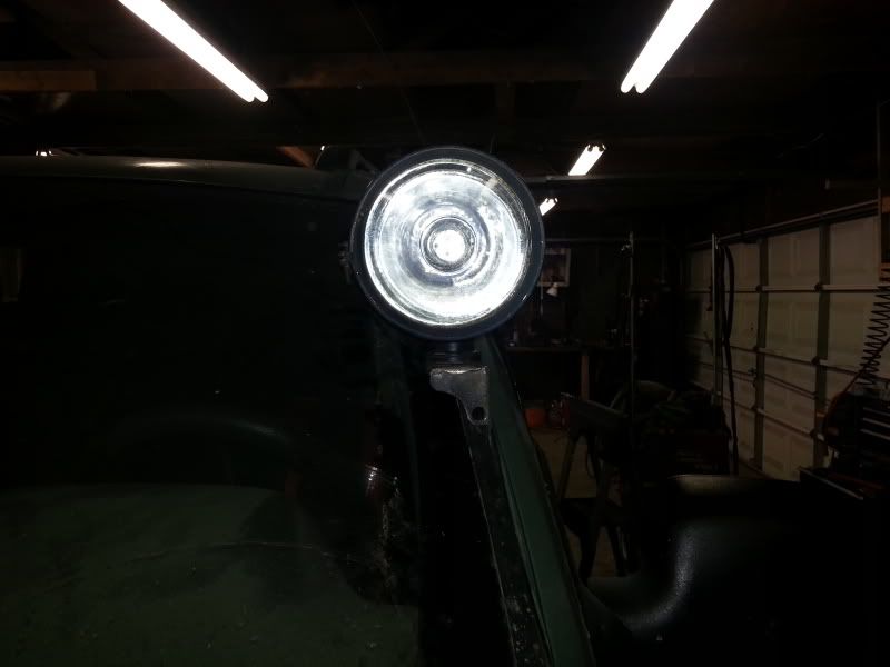

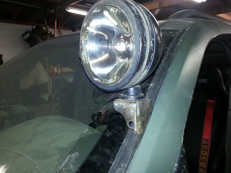

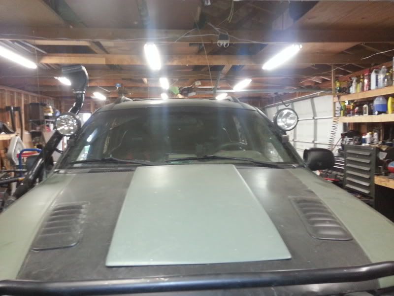

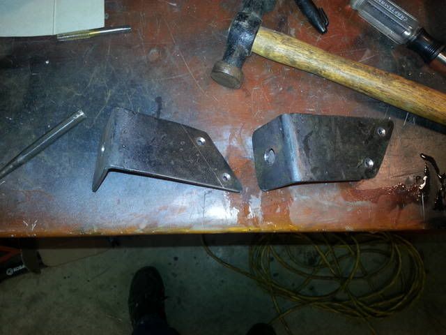

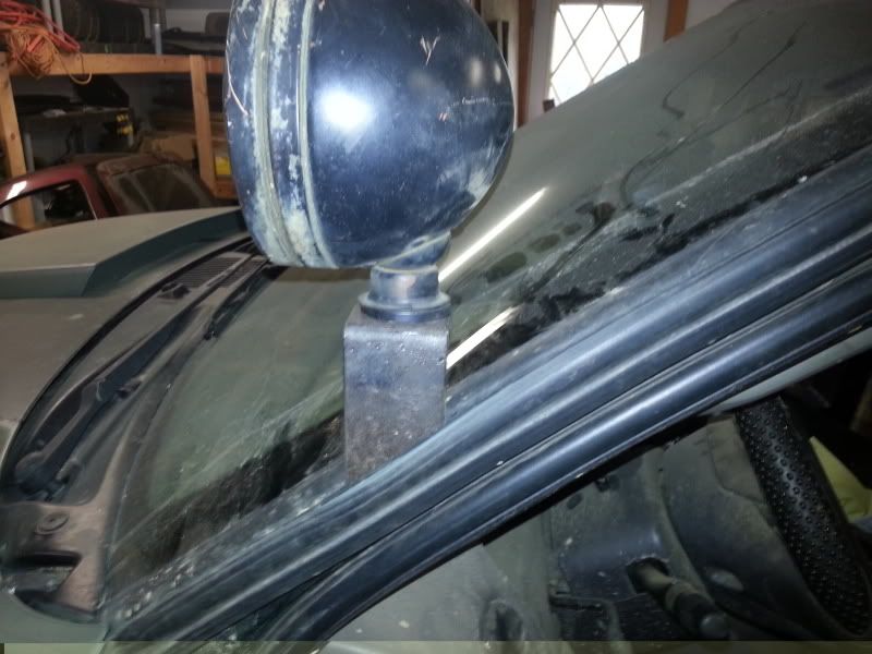

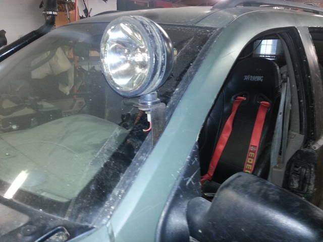

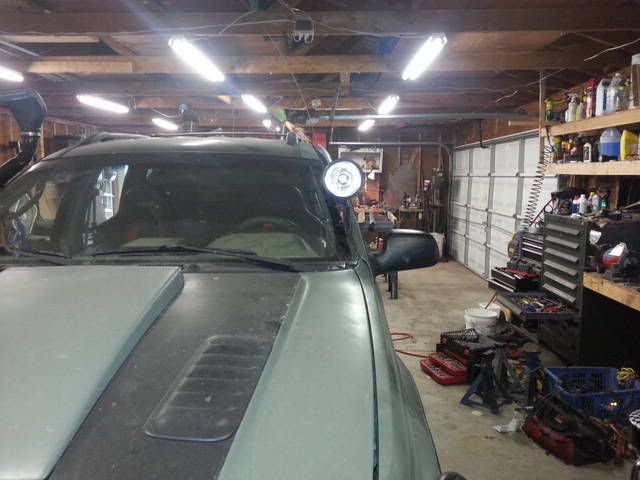

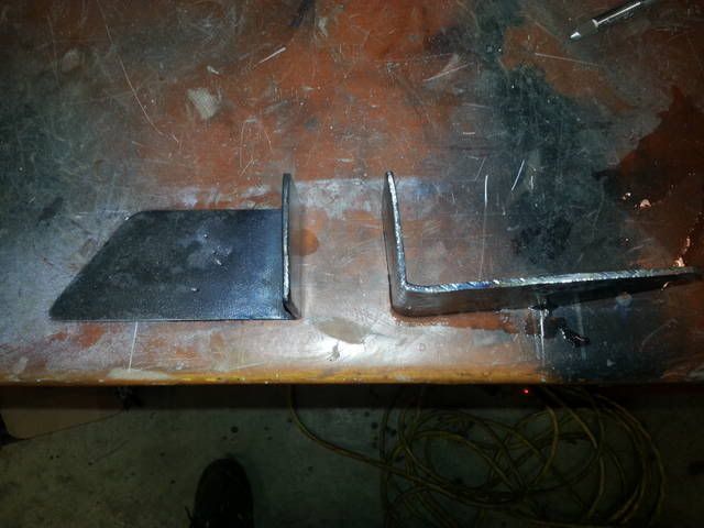

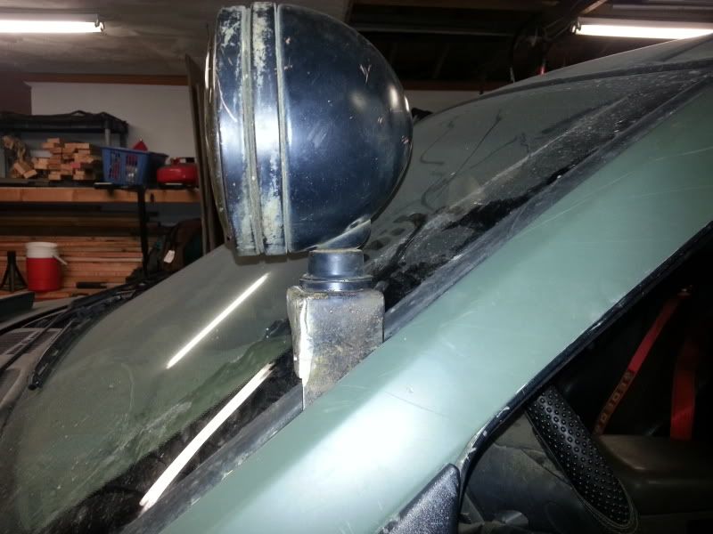

Toyed with a-pillar light brackets.
20 min and walla.
20 min and walla.
Nice Are you going to be able to put one on the other side with the snorkel there?

Dunno. If I do put lights on the A-pillar they will be smaller or round LEDs.

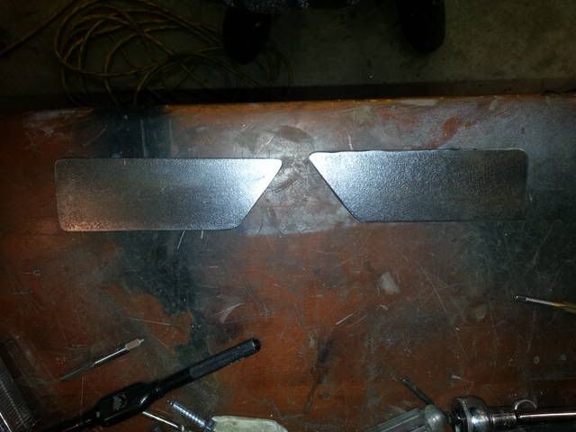

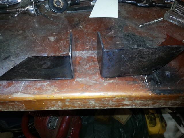

Ver 2
Cut it down 1/2" and added a front cover with a hole for wire or wire loom.

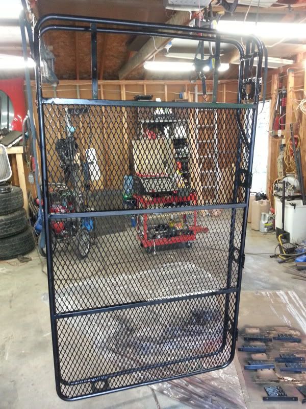

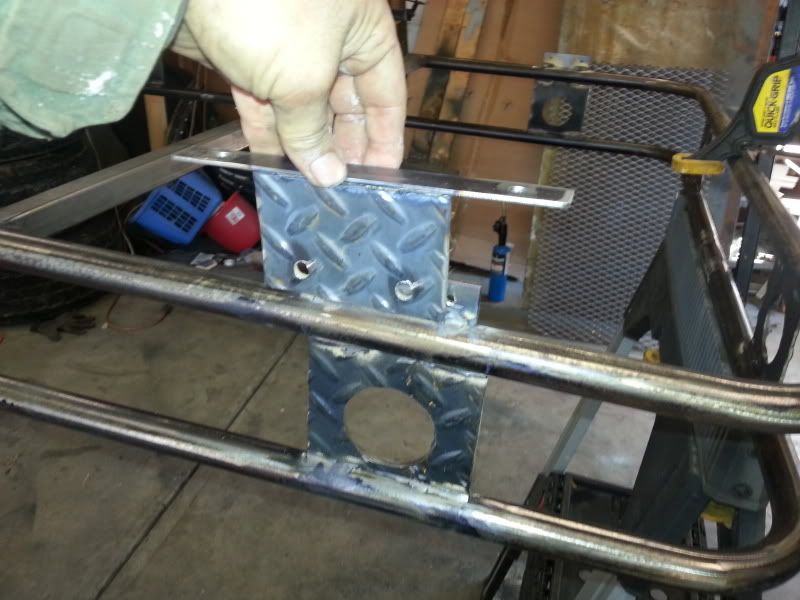

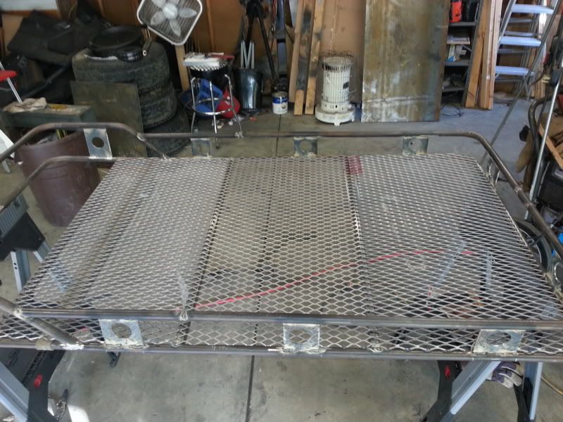

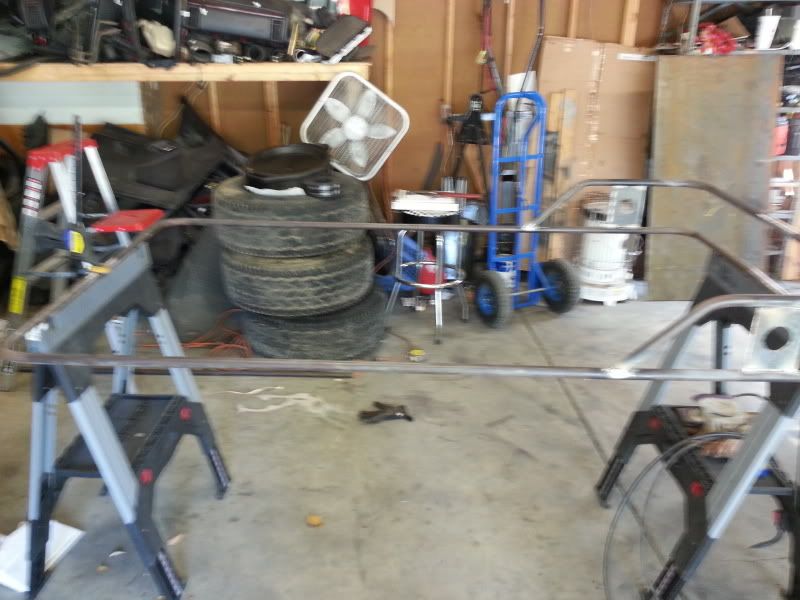

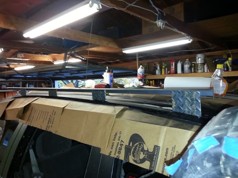

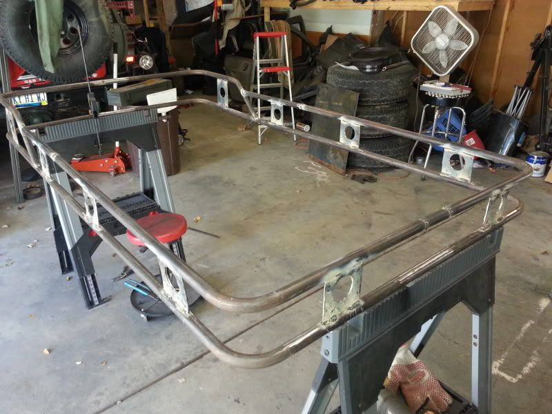

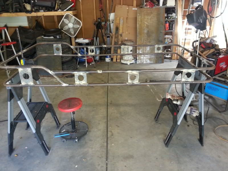

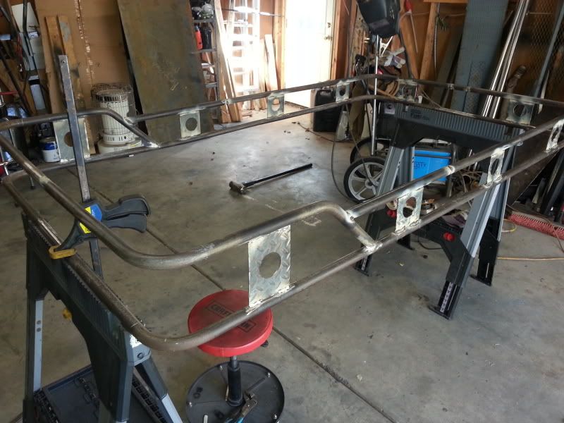

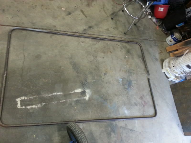

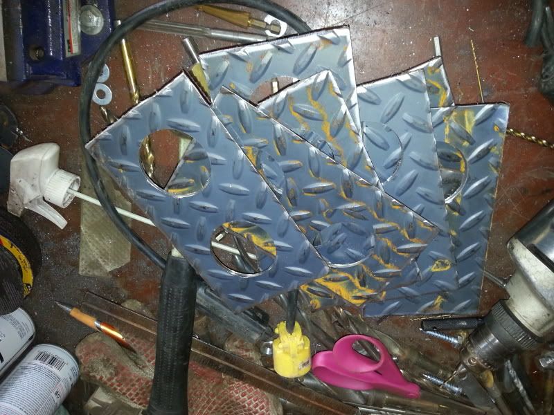

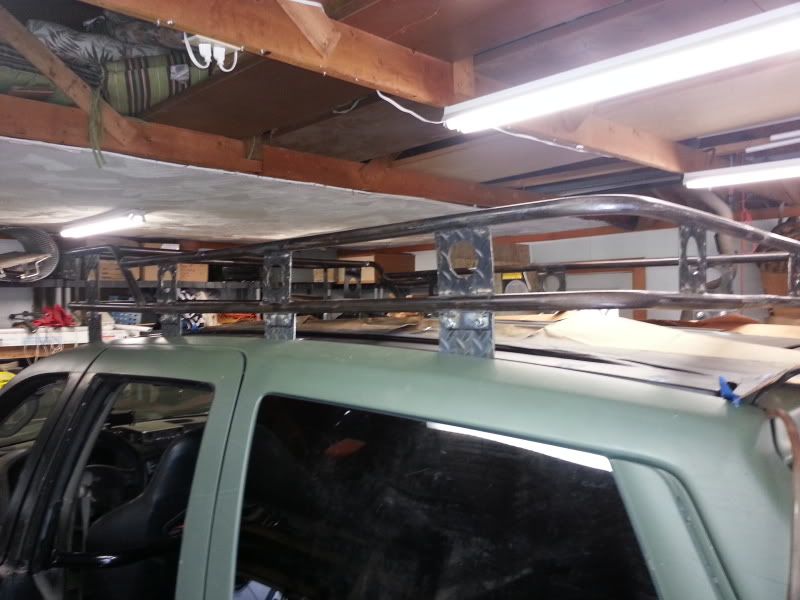

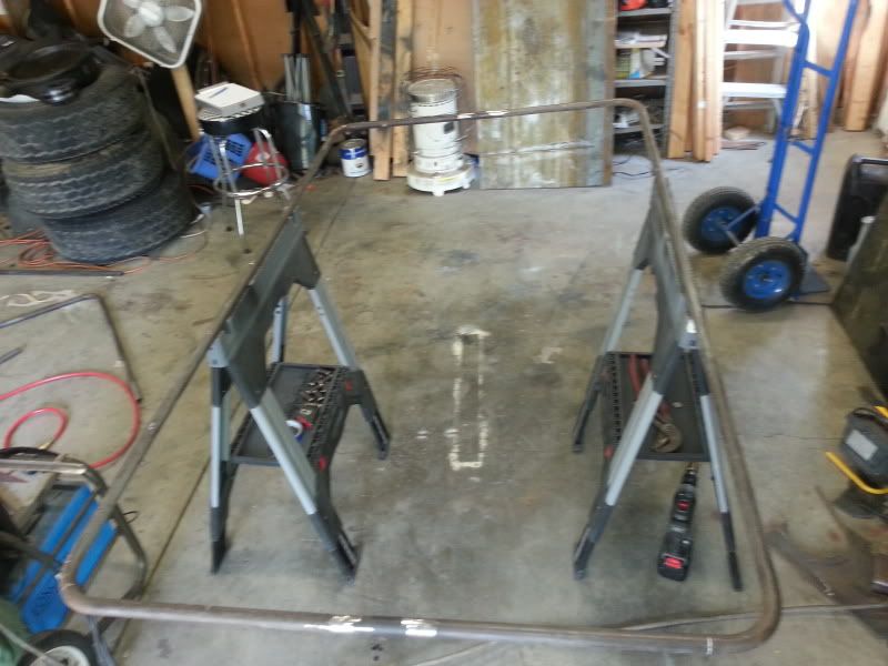

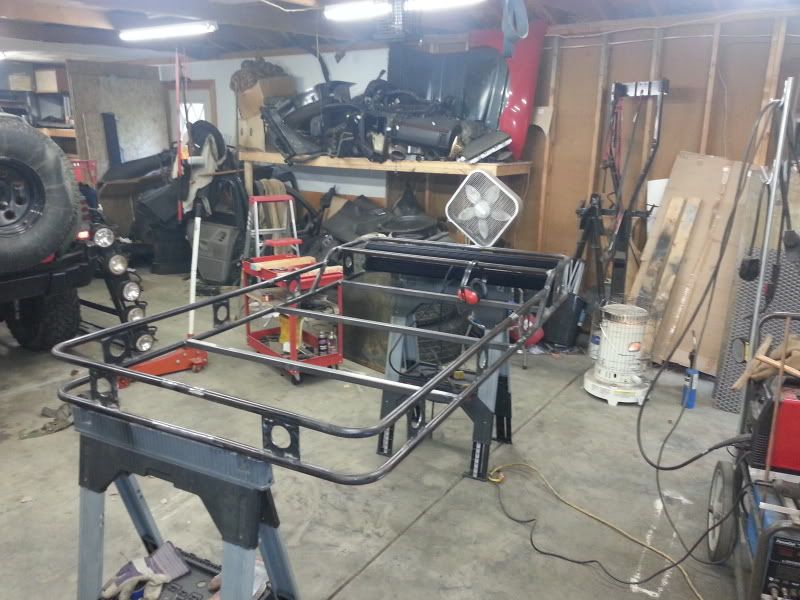

So I built me a little roof rack for my new, to me, LED light bars.

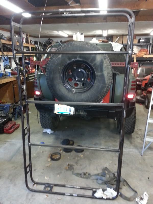

It's made of 1" thin wall tube. $24 for the tube, $10 for the grating, a few cans of paint, bed liner, stop leak spray and misc nuts/bolts. Bending the tube.

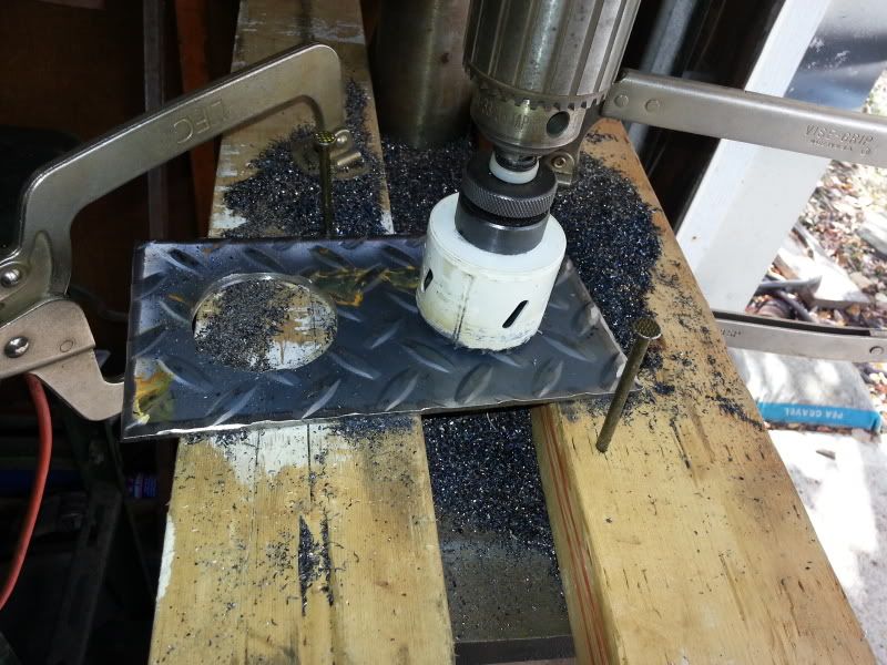

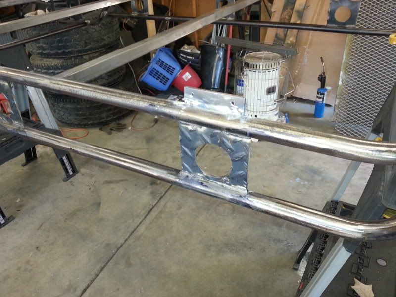

Cutting some scrap diamond plate for the supports.
Upper and lower tubes welded together.

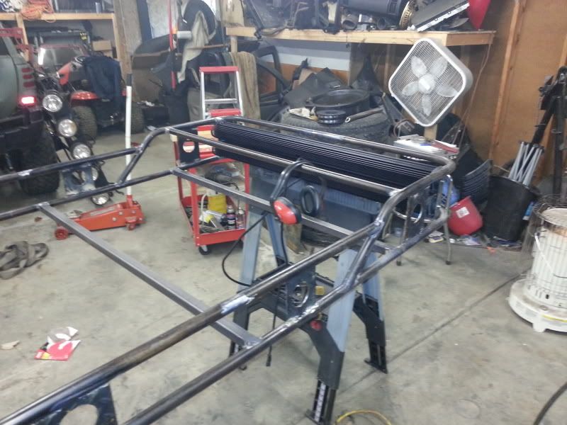

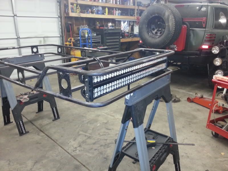

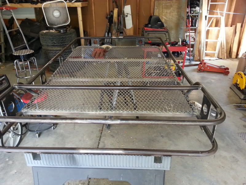

Cross braces cut and in and grating test fit.
Light bar test fit.

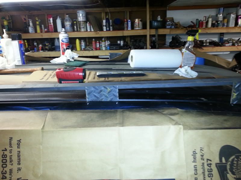

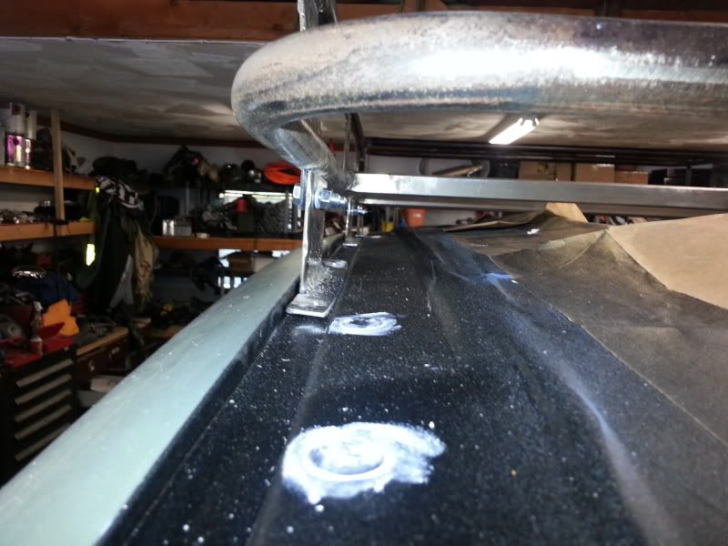

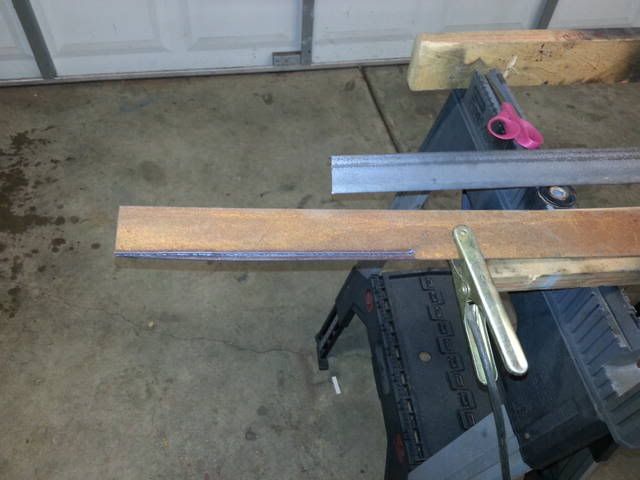

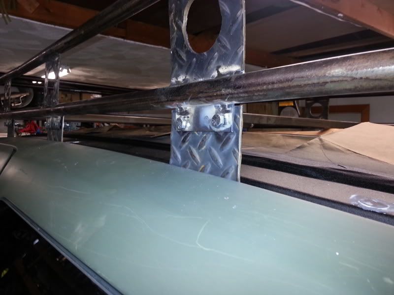

Roof supports, 4 each side. They sit in the roof channel. 1" x 1/8" bottoms with diamond plate uprights. I RTV'd them in and used a can of stop leak spray on the base and bolts to help seal them.
Test fit rack to roof supports.

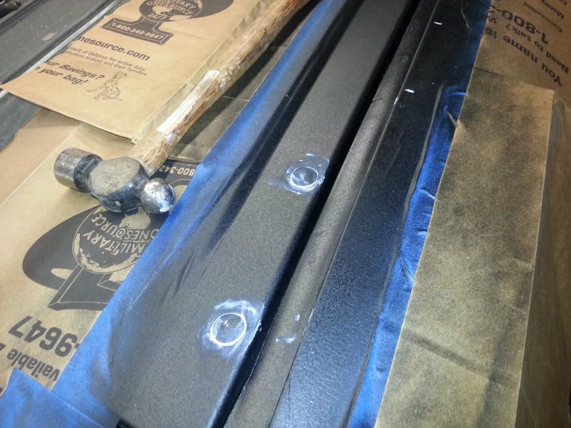

Taped off roof. Bought plastic snap in plugs to fill the original roof rack holes. RTV'd them in. Then 2 coats of bed liner.

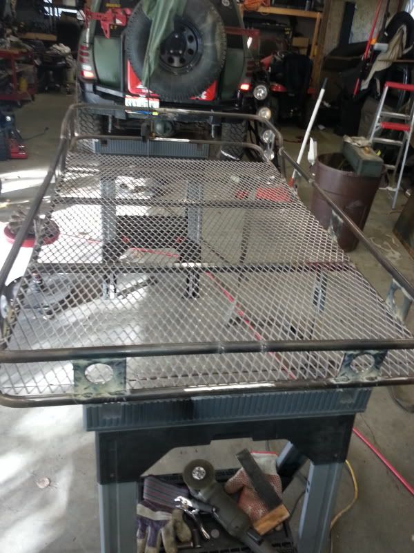

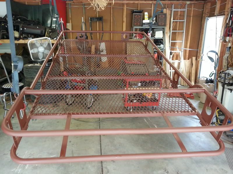

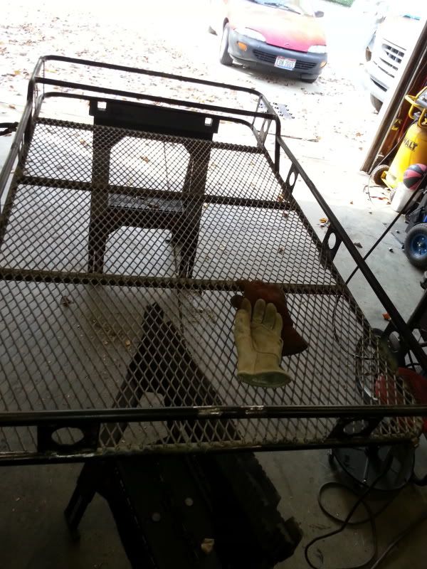

Ready to weld grating on
Grating welded in.
_____________

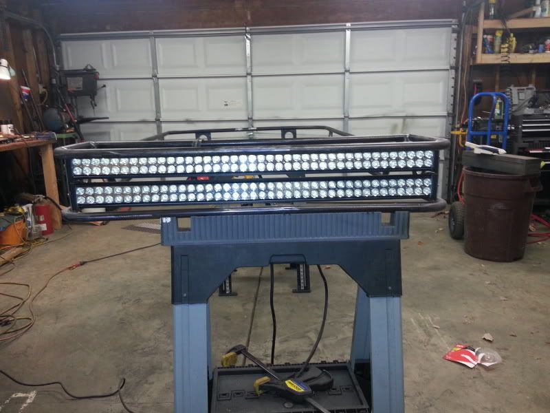

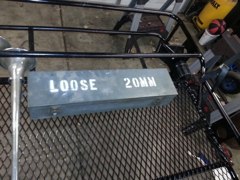

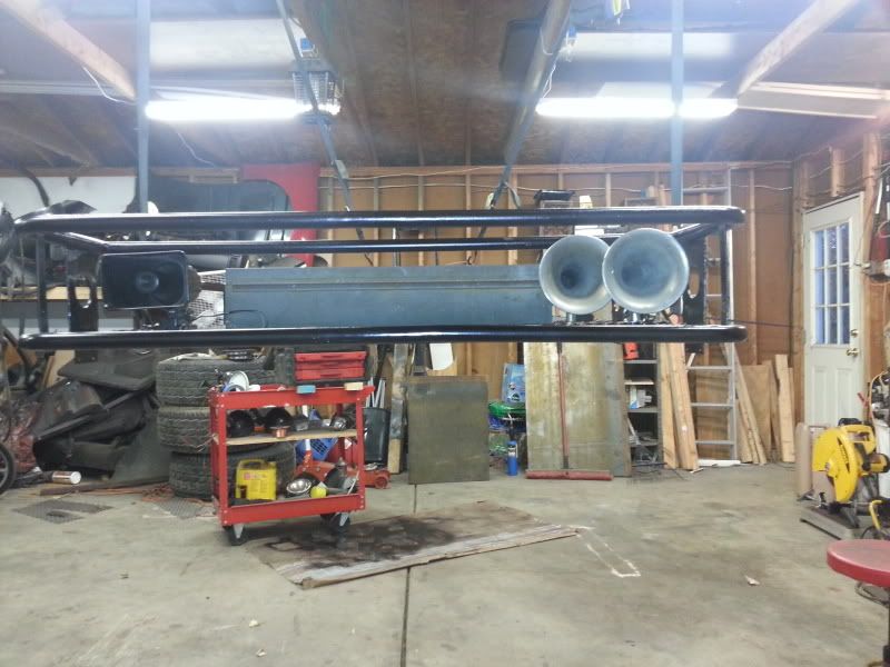

Primed and painted.

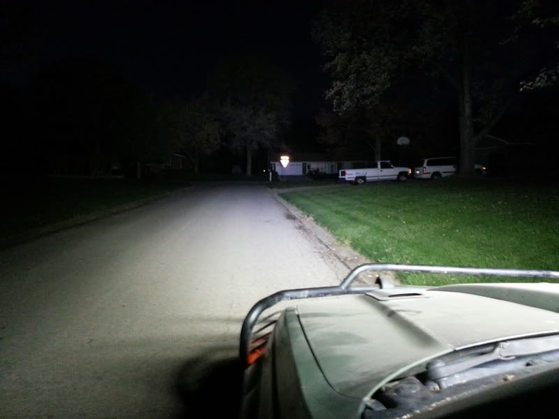

Accessories added. Air horns, PA and ammo can from a 20MM UALS. Light bars and BU flood lights will go on after its on.
Roof rack all done and mounted with LED bars.
low beams- yeah they are dim because there is a thin film of dirt on them.
High beams.
1 LED bar.
2 led bars
