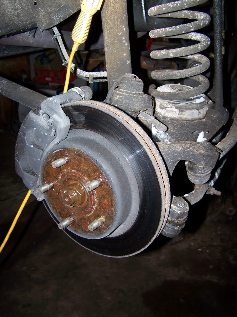

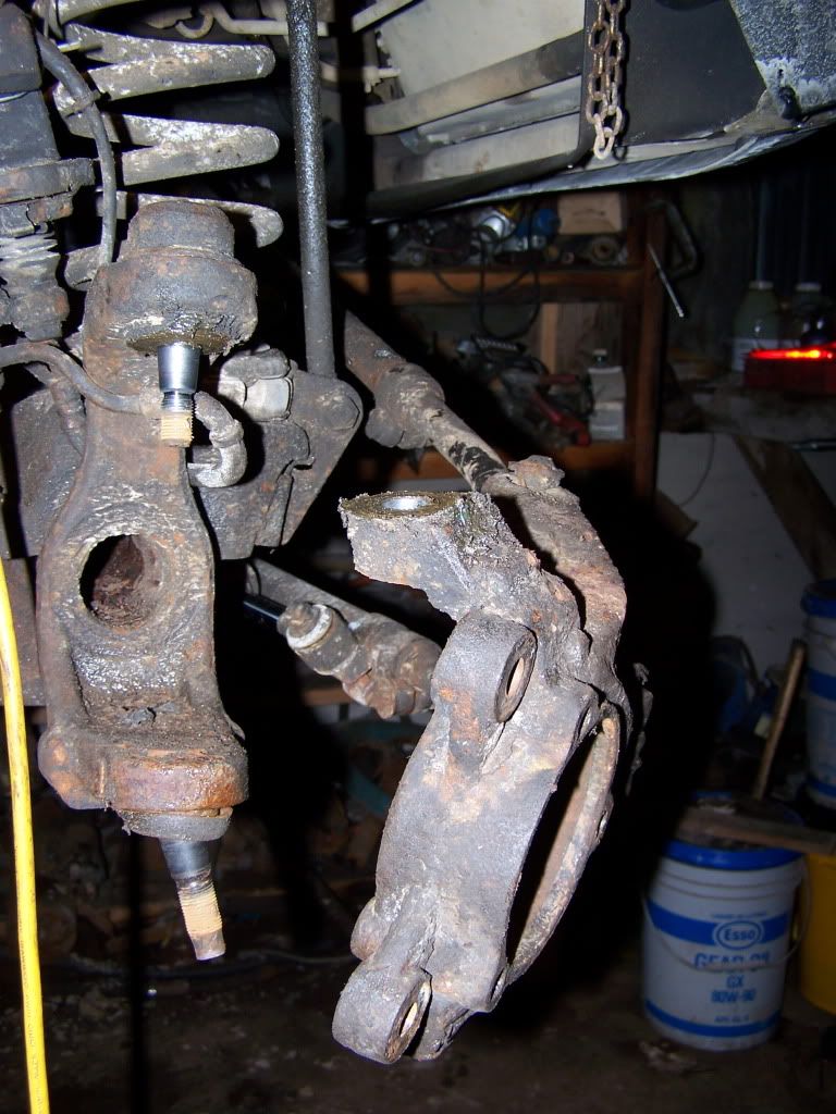

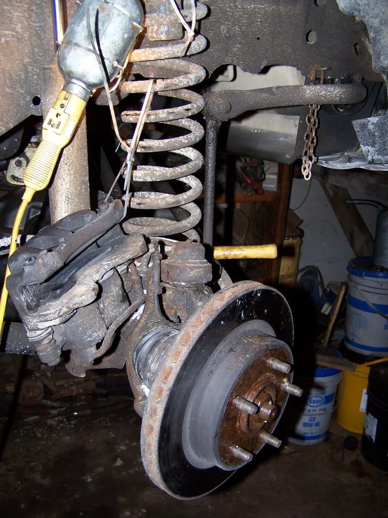

Little update today...i had my inspection done and the mecanics told me i needed 4 new ball joint and the 2 tie rod ends replaced...so instead of paying them 6h labor i did it myself...its my first time replacing them on a solid axle and i gotta say its quite the process compared to an independant suspension. I took some picture so i could do some kind of wright up on this.
wheel removed

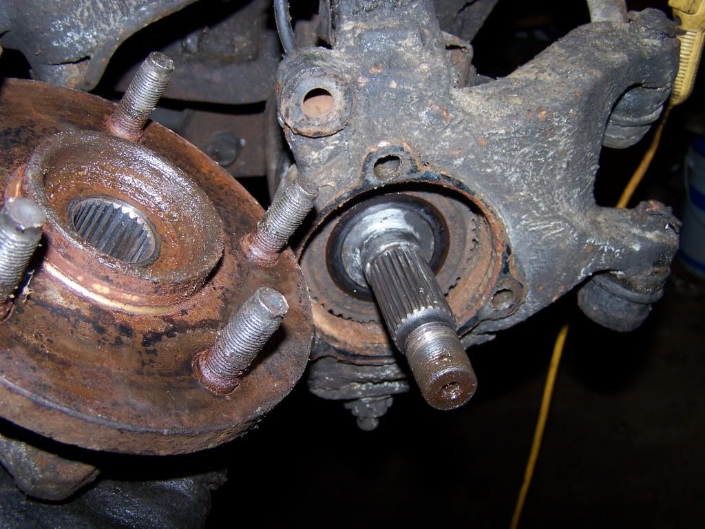

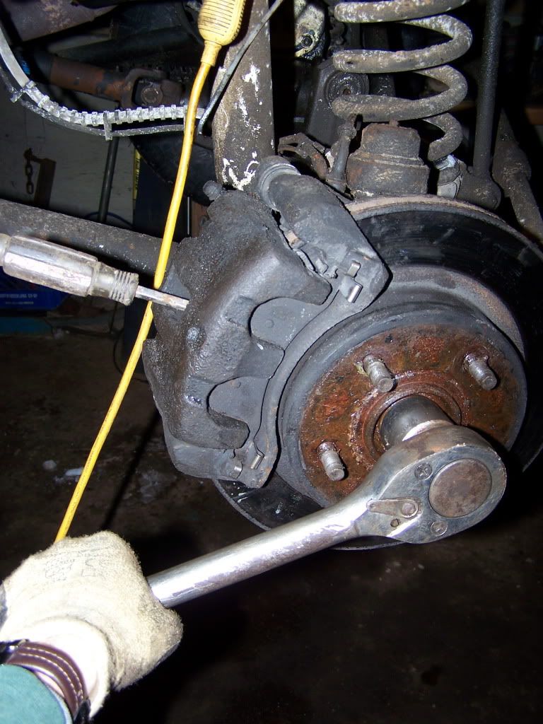

Put a screw driver through the caliper to lock the disc from turning and remove the big axle nut.
Remove caliper
Remove rotor.

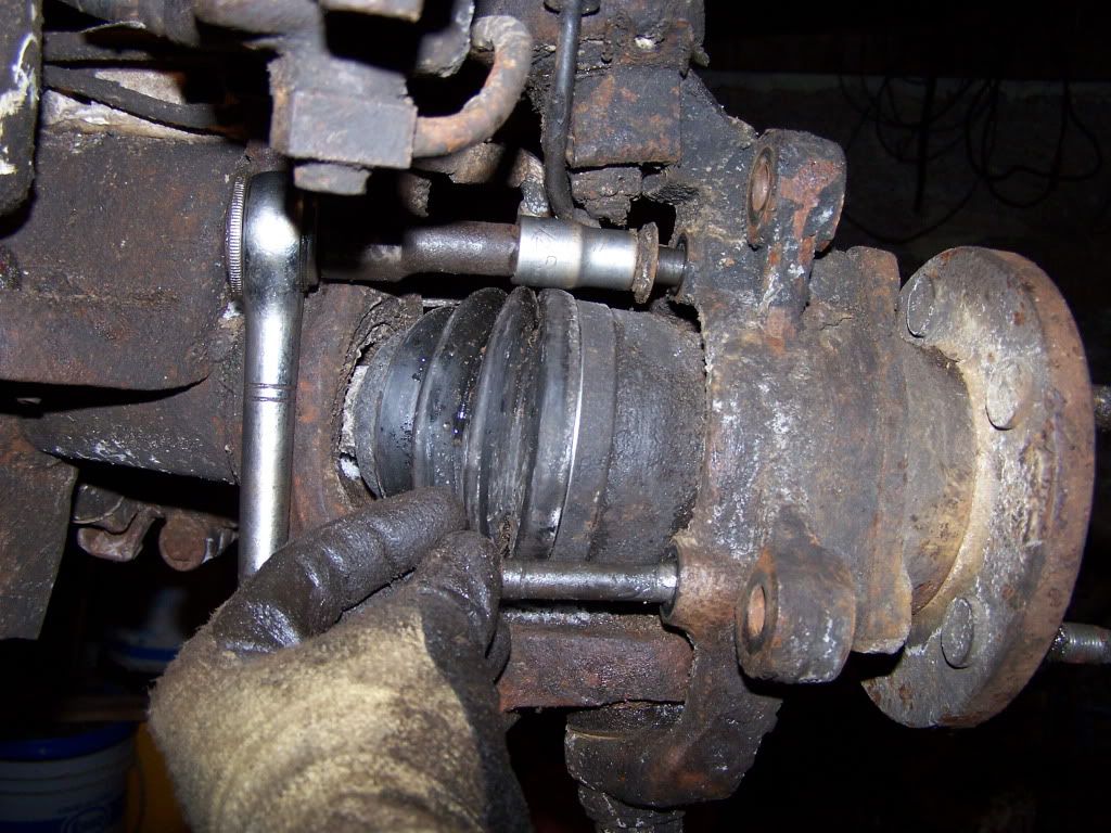

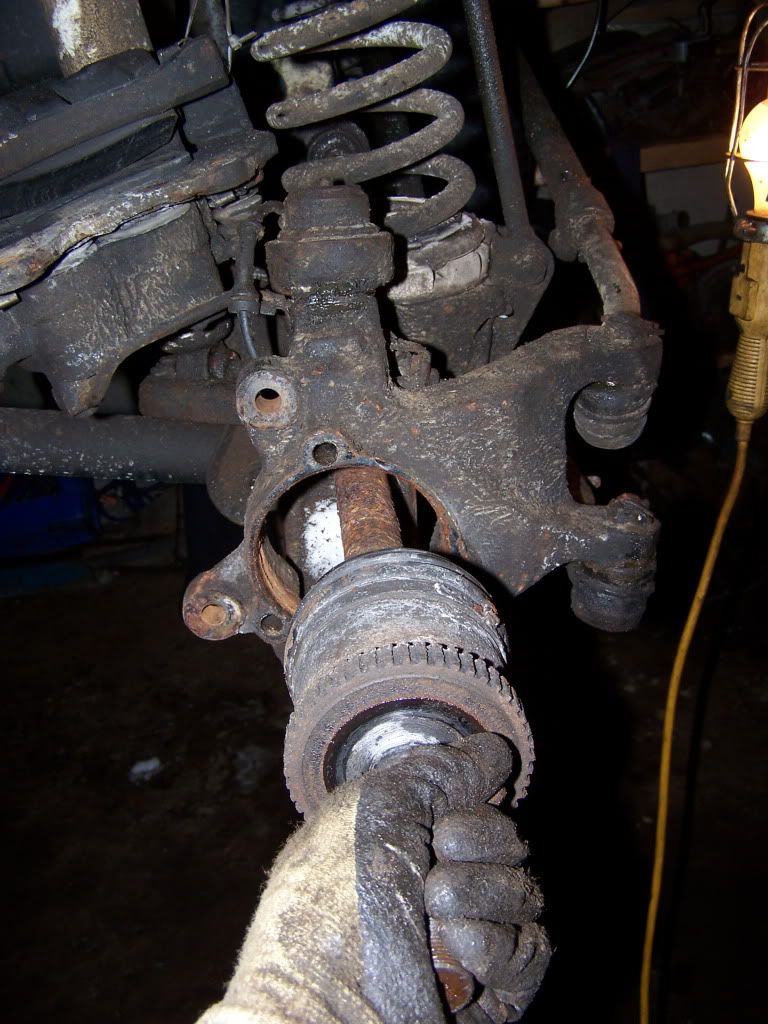

Remove the 3 bolts that hold the spindle.

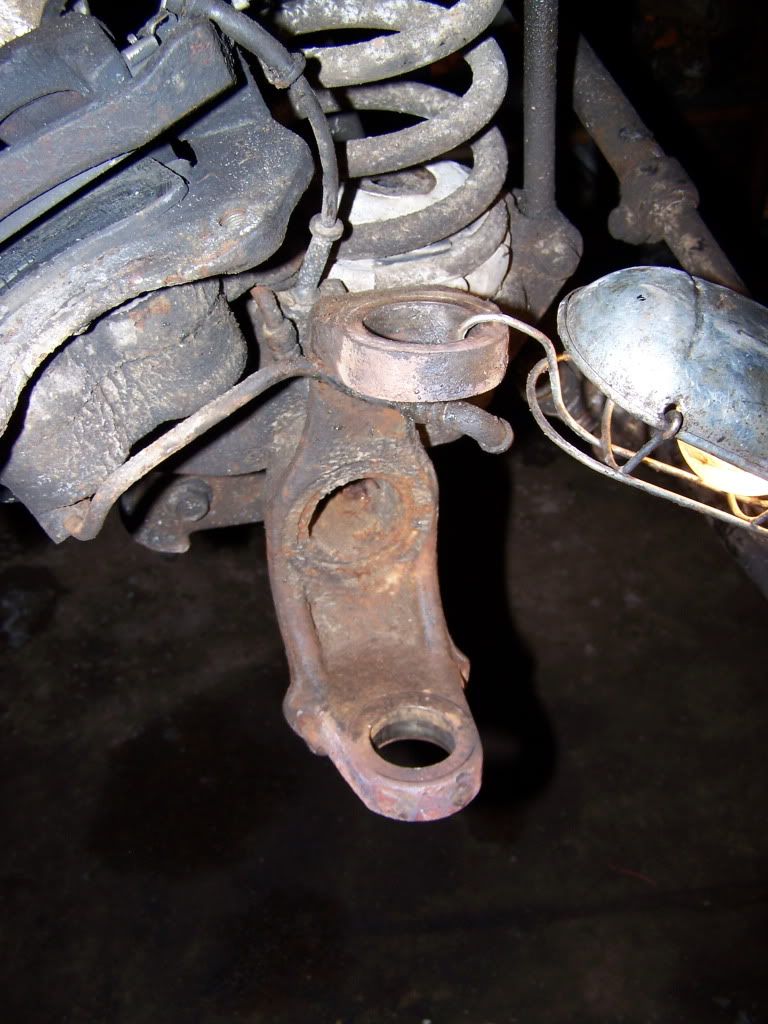

Spindle out.
Remove driveshaft.
Disconnect the ABS sensor.

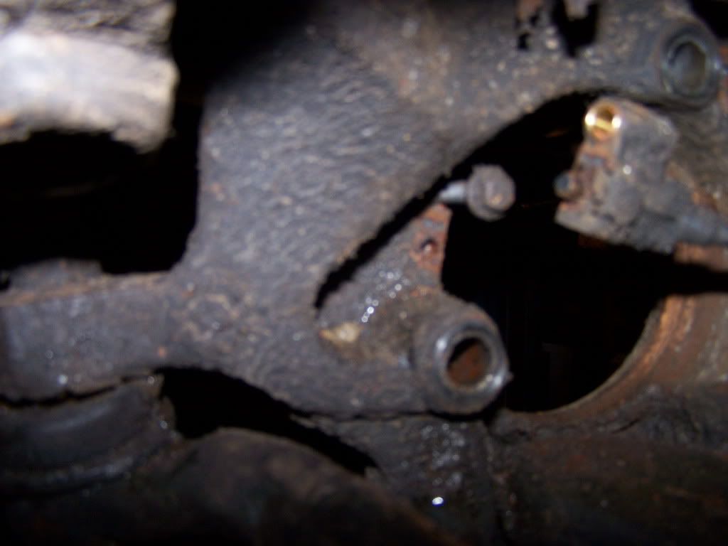

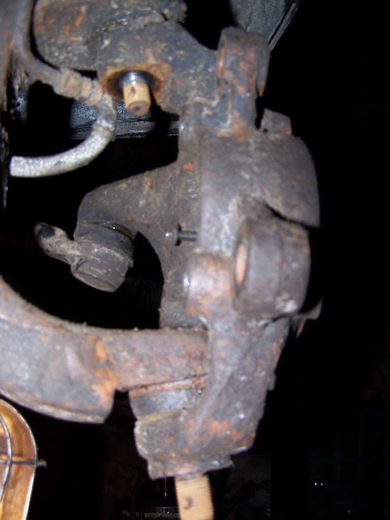

Remove the 2 bolts that old both ball joint.

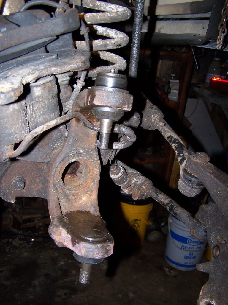

Take the BFH and hit on it downwards and it will seperate from the ball joint.

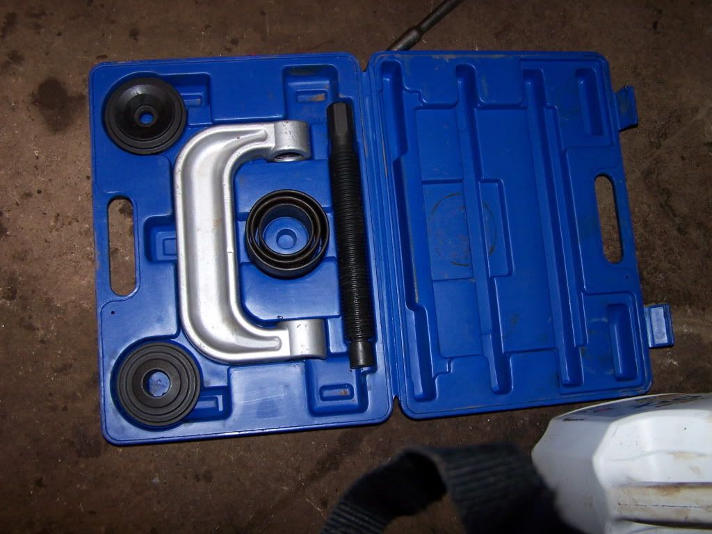

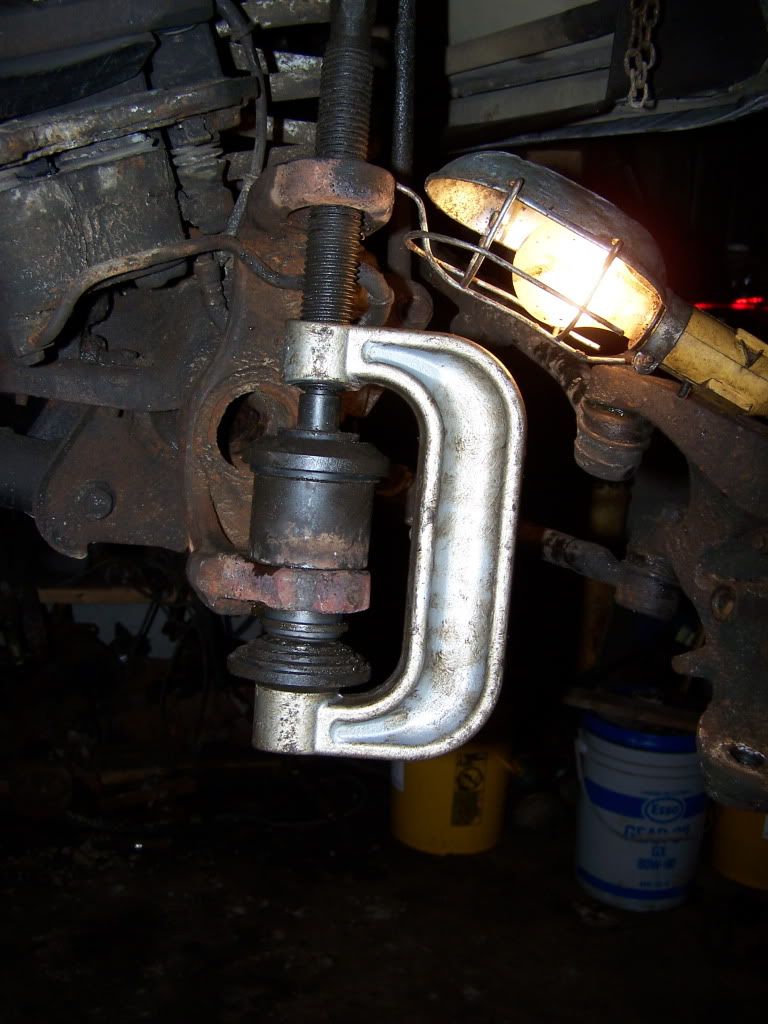

Ball joint press is now needed...and STRONGLY recommend one. I actuallu needed the torch for one of them because it was seized solid.
2 ball joint removed

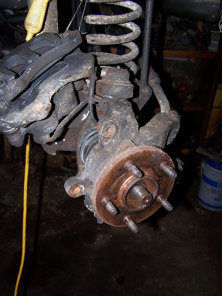

Pressing the bottom one in first.
Then the top one et voila all done one side. Reverse step for the install.
