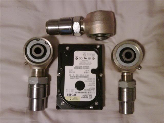

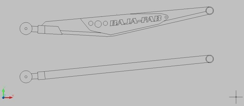

Havent really been doing much to the jeep since the rear.. but now it starts again... haha.. just got my Johnny joints in to start my custom triangulated 4 link in the rear. Im still debating if i should go with trailing arms and change up my rear shock location. heres a drawing of the arms for comparison.
The shock and coilover will come off the trailing arm going through the floor in the rear and attached to the shock tower.
Here is a cell pic of the Joints..waiting on the bushings now.. so if everything goes good i will be busy this weekend .... I will also be making some Uni-body stiffeners.
These Johnny Joints are HUGE!!!!
Next i will be ordering 14" travel 2.5 King coilovers to put in place of the front spring..
My rear upper and lower control arms will be for sale soon.. so if anyone is interested pm me.. they are IRO all adjustable arms.
What are the specs on the tube for the arms? If its 2" .250 DOM, it will bend if you land on it ever. I know it's a runner and not a crawler, but **** happens. You may be thinking that the claytons arms don't bend easy being 2" .250, but square is A LOT tougher to bend in that size.
The trussed trailing arm would be good, can't tell if you are still planning that.
Also, I would go back to heims, use a good QA1, Aurora, FK bearing, or other quality piece. You will likely end up stretching the casing FAST if you baja the ZJ much. I'm on my way to replacing all my JJ's with Heims.
Looking very cool though Cache, You ought to post this build on Mall Crawlin, I'm sure Kraqa (and others) would love this. Very out of the box for a ZJ build, not very many pre runners, and even fewer doing it right. Triple bypasses! PIMP.

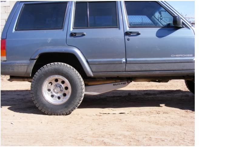

Actually the arm are DOM .120...... im still thinking about going the trailing arm look im leaning more towards it because i love how it looks.

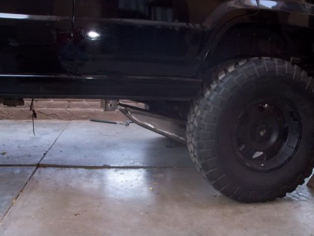

Heres one he did on a XJ
. I'll try out the JJ's and see how they hold up, already paid for them so might as well..hahah.. I'll have to post it over on mallcrawlin, i usually just browse around over there dont really post.

Holy crap.That .120 scares the hell out of me. Definitly sleeve it, or definitly do a trailing arm, although I'd go a bit higher clearance than that XJ, or you'll be on the arm all the time, cresting steep hills. Your ZJ will look sweet with trailing arms.
You should appreciate these trailing arms if you love the look of race arms.
Saw these being built in person, they are awesome, and SO strong, all chromo plate!

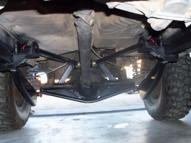

Heres a pic of the rear arms.... they look a little low but i still havent seen them in person... right now all the arms are being powdercoated and everything should be installed by the weekend.. all there is left now is the unibody stiffeners.

post #55 of 211 Old 08-13-2010, 09:35 PM Thread Starter
-cAcHe-
-cAcHe-'s Avatar
Location: Holtville CA,
Posts: 2,515
Finished!!!! I will have more pics tomorrow once i pick it up.

Bama_WJ
Bama_WJ's Avatar
Location: Humble, TX
Posts: 3,874
Slick setup man. Looks nice.

post #57 of 211 Old 08-14-2010, 03:23 PM
Spike300
Location: Marion, Wis
Posts: 1,355
Looks good, But ill stick to making mine for drivin in the woods

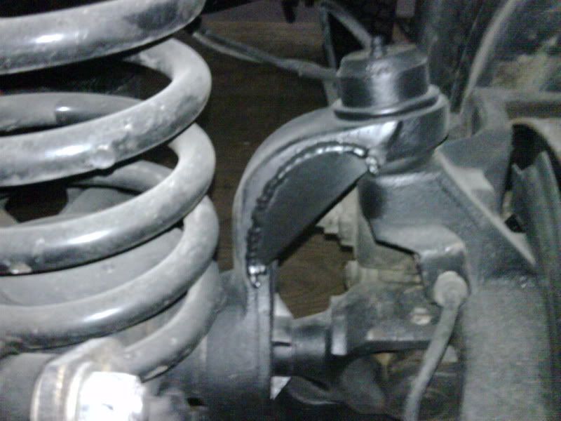

Just picked up the jeep and man the rear feels alot different. couldnt take pics cause its to dark but here is the front C gussets...

post #60 of 211 Old 08-16-2010, 02:53 AM
xgerstandtx
Location: Marshalltown
Posts: 687
This thing is looking great, I Dig the rear link setup very clean stuff. Keep it up.
The front C gussett's are nice too. Just keeps giving me more ideas.
