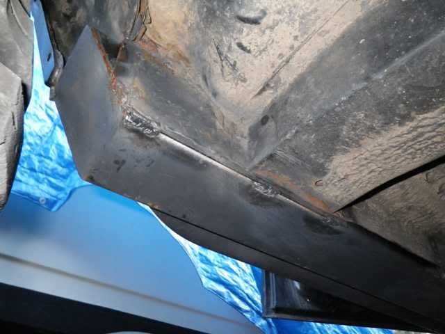

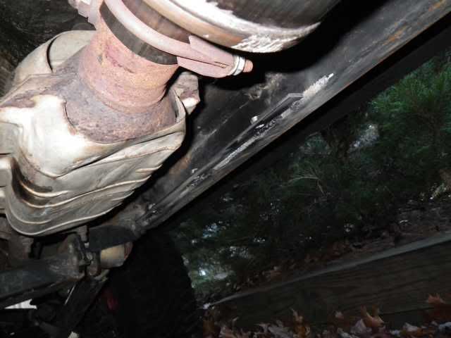

Hey Eric can you post up some pics from the bottom on the pinch seem as well as the back tie in i will be doing this soon and am a tad curious also can you take pics of the uniframe tie ins?
Will do ASAP. I'm travelling the next few days and then wheeling it as-is this weekend. I can tell you right now that the pinch seam itself is gone; one of the cuts to get the old rocker skins off was just above the pinch seam. All that is left is the metal just above the factory pinch seam.

Ok Goofy, are these the pictures you were looking for:

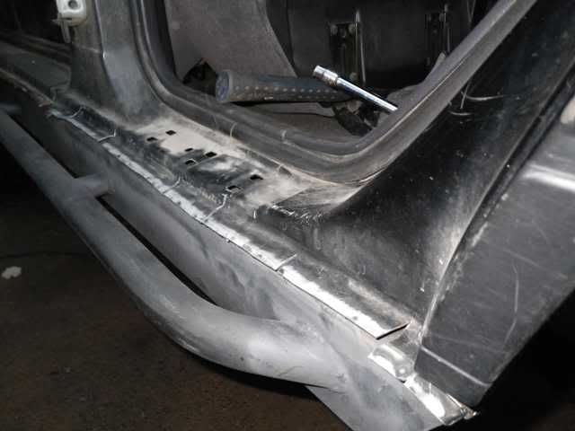

I still have not installed tubing from the sliders to the frame and at this point probably will not. The way they are tied into the body through the pillars is plenty strong enough. The remaining tasks are to stitch the rocker sheet metal to the sliders and then finish with seam sealer & Herculiner. The following picture shows the trimmed and cleaned sheet metal ready to fold onto the slider:

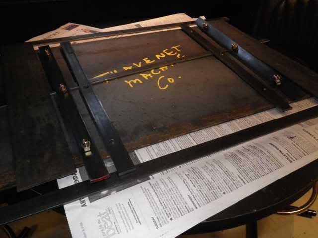

I also started building a belly skid plate. Here are the parts:

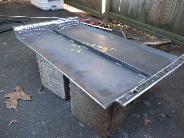

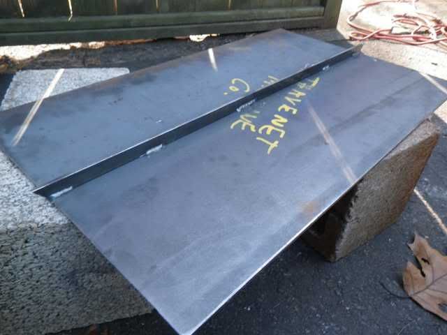

Fitting the parts together and tacking:
I welded a couple flanges to the Clayton frame stiffeners for mounting the skid plate. That cat sure will be happy to have some protection:
Now I just need to be patient and keep it from warping when completing the welds.
