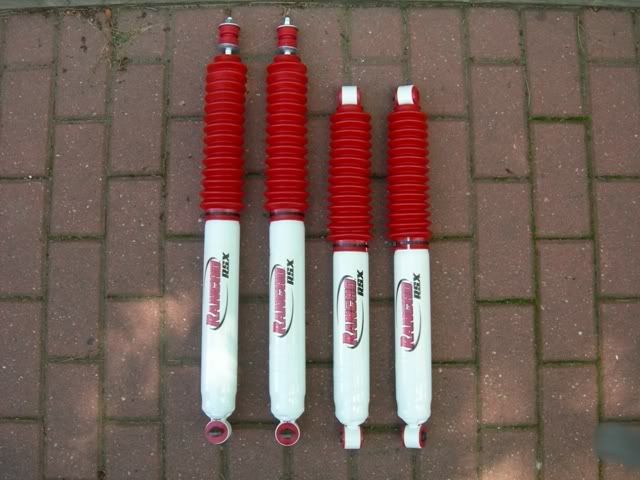

Also installed some new shocks. I went with the new Rancho RSX to replace the Rancho 9000XL's that have been on there for four years now. I ordered the shocks from 4 Wheel Parts. Unfortunately, when I went to bolt on the rears they were about 3" too short. Upon closer inspection it turns out they shipped the wrong part number. Kinda obvious from the pictures ain't it? Arrrrgh!

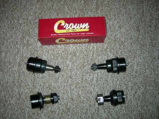

Crown ball joints. The part number on the boxes was the same but the joints have a slightly different look. Need to check this out:

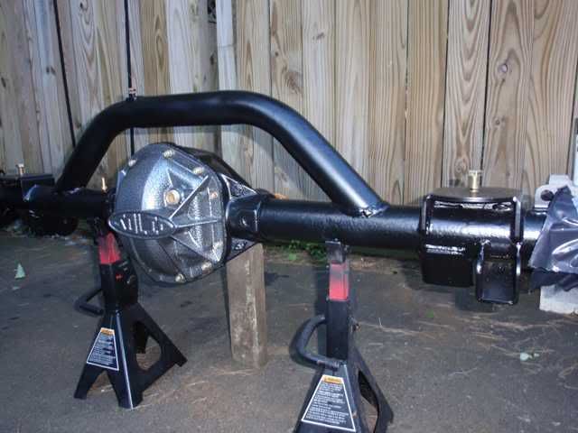

Brackets welded on (some of them are just tacked/bolted in the photos):

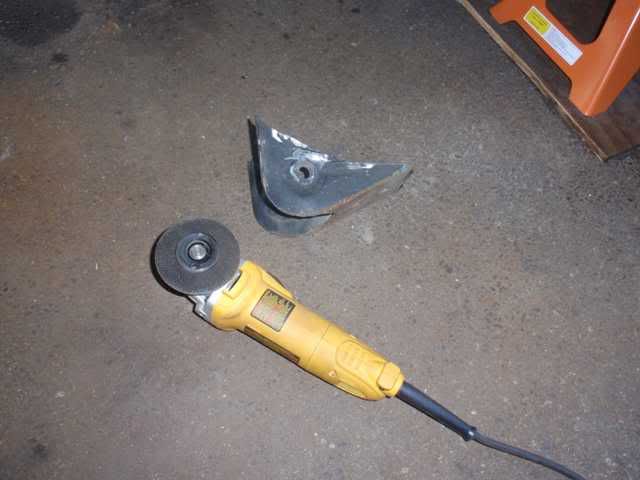

Went to remove the track bar bracket which is getting replaced with a double-shear unit and one of the bolts snapped off:
This bolt goes through to a nut that is welded to the engine mount bracket. Plan A was to remove the engine mount bracket and try to extract the broken bolt. I pulled the engine mount (what a PITA) and then proceeded to break off another one of the bolts holding on the engine mount bracket. Plan B is to just get that MF out of there and get a new bracket because I don't feel like screwing around extracting bolts. I just love it when what should be a 10 minute bolt-on job turns into a multi-hour ordeal.

Here's that f***ing motor mount bracket that caused so much pain:
Motor mount bracket and track bar bracket bolted back on. Wasted alot of time tracking down the required metric 10.9 hardware:

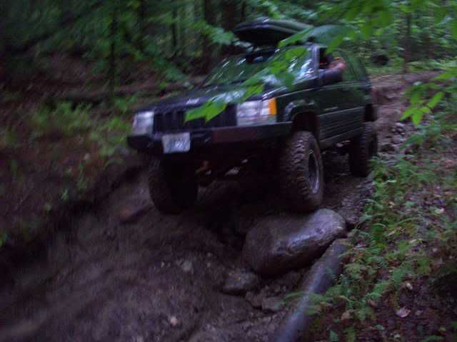

Some pics from the trails:
