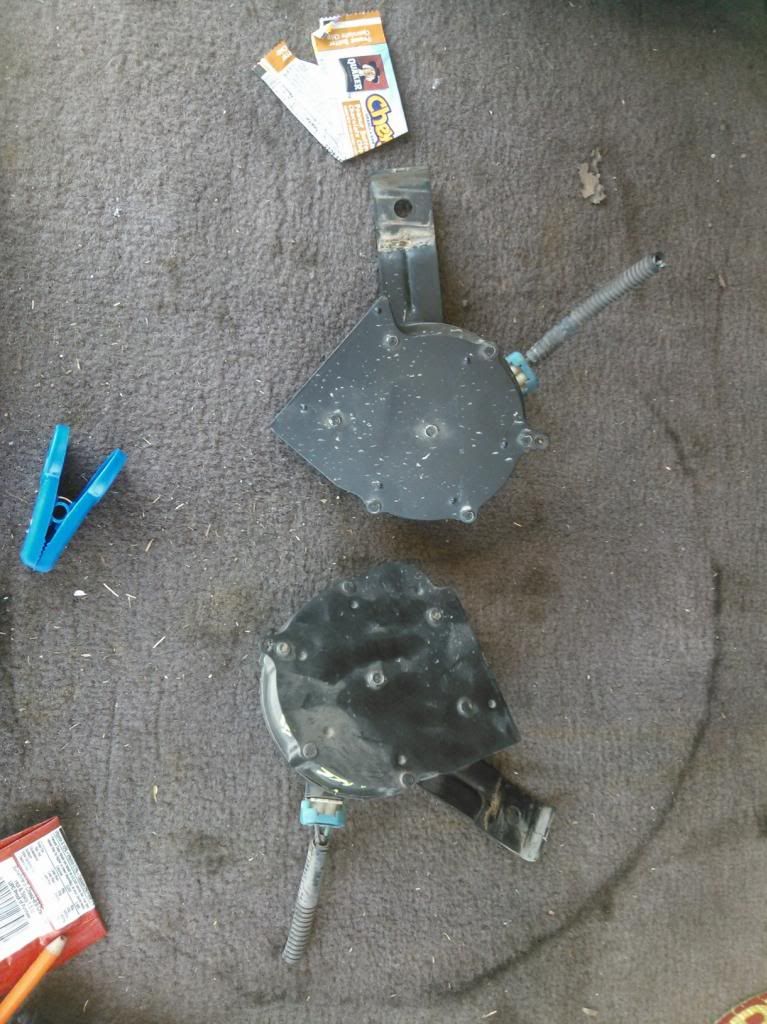

went to pick n pull today to kill some time, left with a couple horns from an early 90s caddy.
im running 4 horns total now; factory jeep high note, GM "F" note, GM "C" note, and GM "D" note. sounds like a train horn, just a bit queiter

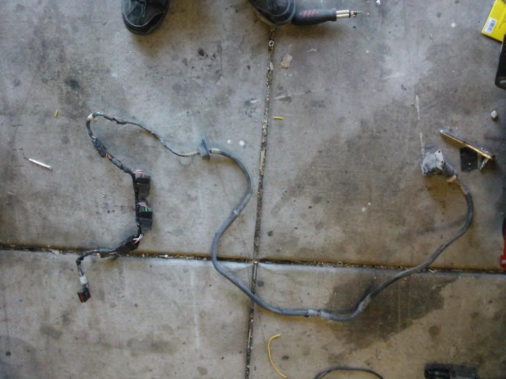

also finally found a factory trailer wiring harness with the 7 way plug.
grabbed the relay set too, but turns out mine already had it. probably because mine came with trailer prep.
all for a grand total (get it? GRAND? ok ill shut up....) of $0. junkyard was closing and the guy told me the registers were already shut down, so i can just take it
