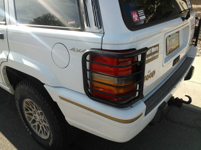

Got some ***** done on the ZJ in the last week or so.
First thing was I wanted to replace my old, hacked-to-***** tail light harness'. the PO did a really ghetto wiring setup with scotch locks and wire nuts. I ordered a tow ready harness system that plugs inline with the factory harness connectors, no tapping any wires anywhere. Install on that will be complete tomorrow, I took the ZJ to school so I can run the hot wire to the battery for the towing module. Didn't want to deal with that on my back so I'll put it up on the rack and get it done. Work smarter not harder. Doesnt hurt that my teacher gives me extra credit for all the outside crap i do involing cars .

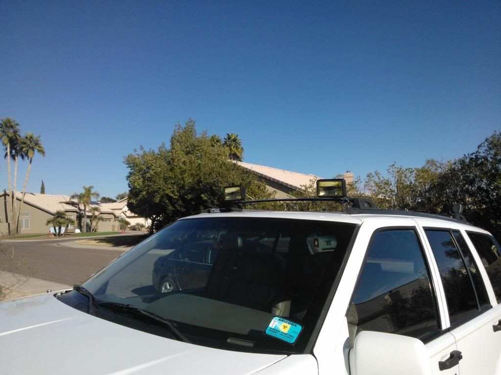

threw some harbor freight lights up on my roof, theyre pretty bright
mounted the switch inside my cubby hole AKA VIC delete

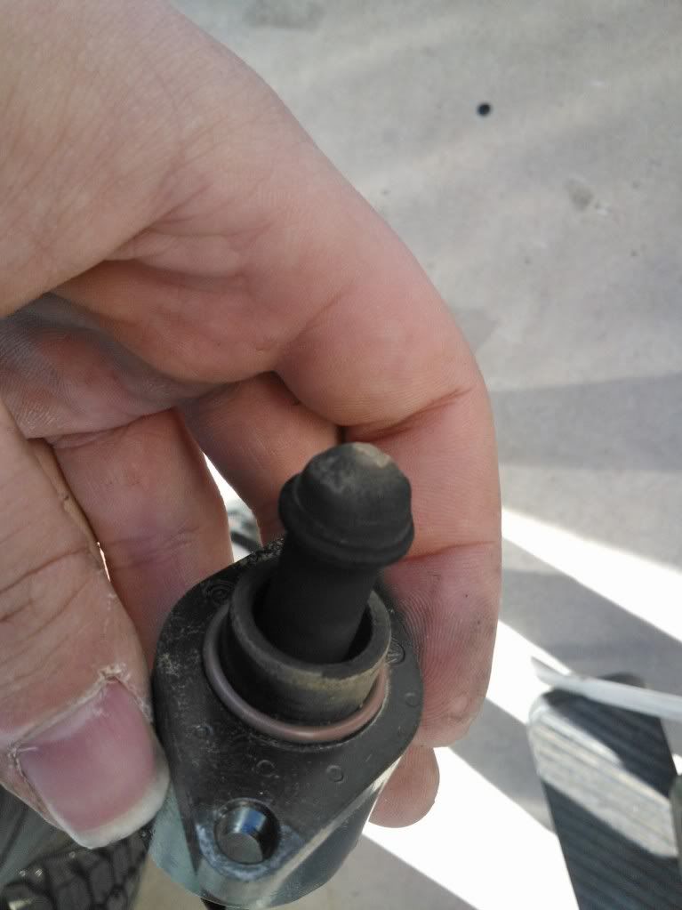

Jeep was idling a rough last night, so I cleaned my IAC valve and the throat of the throttle body.
Here's the location of the IAC on the throttle body, its on the back side facing the firewall.
Held on by (2) T-25 torx screws
Here it is removed. Definately needed to be cleaned:
And here it is after I cleaned it:
Idle is noticeably smoother now
