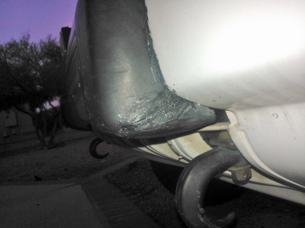

Also was able to install that bumper cap thing today. I did some surgery on the one from a rear bumper i got at the JY. I cut about 1.5 inches off the part that slides into the bumper cover, then cut out about a 1/4" of material right where it curves. Then i bent the bottom piece up. To hold it together, I used those plastic caps that come on cans of carb cleaner. I put them in a little metal can and melted them down. then used a razor blade to scoop the molten plastic out and graft it onto the cap. heated up a knife real hot and smoothed it over:
As you can see, you would only notice it if you were up close.
Cap is held onto the bumper cover using black sillicone.

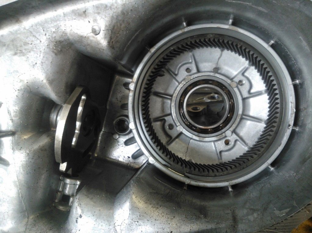

Hit all 4 junkyards today.
Pick-a-part Mesa: UpCountry decal for rear window, crappy broken selec-trac bezel (only took it cuz it was the only one i ever saw, didnt know if id find another), selec-trac shifter gate (for the predetermined stops)
Pick-a-part Phoenix: 1.55" input shaft for the 242. Found a 249J sitting in the scrap pile, so i turned it over and read the tag. birhtdate: february 1994. threw it on a cart, wheeled it into the back of the yard, lifted it into the back of a fullsize dodge van, and ripped it to $h!t.
Pick-n-Pull Chandler: Good selec-trac bezel.
So the total I have in the 242 swap at this point is around $175. Ill get that back when I sell my old 249.
242 gutted:
Here you can see the difference in the two input shafts. 1.55" 23 spline on the left, .750" 21 spline on the right:

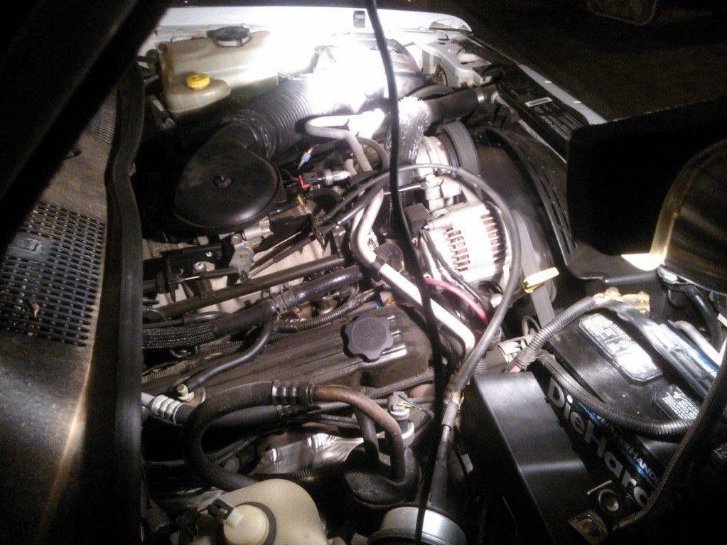

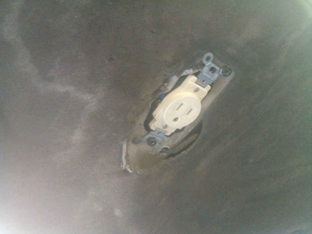

Did another cool mod
Thats the factory underhood light location. The factory light is crap.

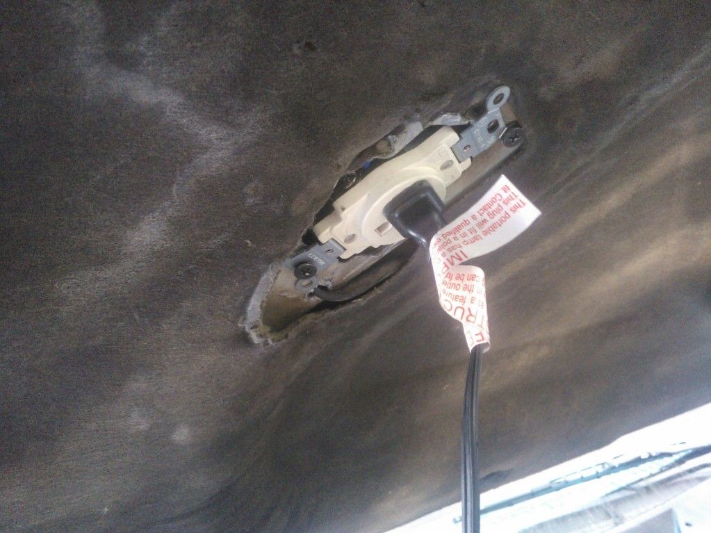

Massaged the sheetmetal a little bit, and was able to fit this single round outlet in the hole. Held in place with 2 sheet metal screws. Its wired with the original underhood light wires, so it only gets power when the hood is open.

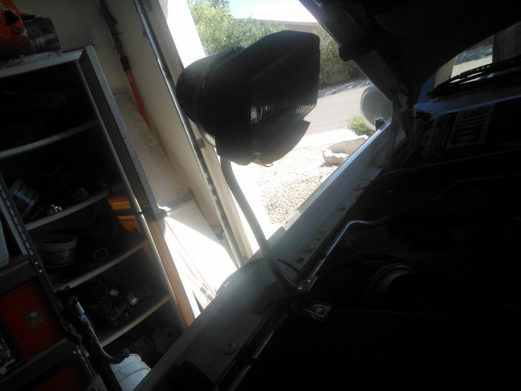

This is what plugs into it:
Took an old desk lamp with a bad switch, gutted it, cut the housing up, and installed this halogen fog lamp. Wired it with the original lamp cord.
It has a clamp on the end, so I can clamp it where ever it needs to be. The post is flexible, so its easy to aim where I need it.
Super bright
Total cost was around 6 bucks. I had the light leftover from my front fog light install (broke one of the lenses, had to buy another set of lights. took one of the lenses, had a spare light). The outlet was 5 bucks plus tax, and the screws were 50 cents a piece (theyre stainless).

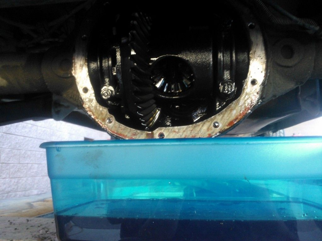

Rear diff opened up, fluid draining. Gears look excellent and no metal at all in the oil.
New fluid, walmart brand, cause its cheap

Rear diff is done. didnt do the front one because my dumb*** friend didnt realize the fluid was dumping out of the hole, so i lost some fluid on the ground. gotta buy another bottle or i wont have enough for the front diff. driving the ZJ home tonight, my dad wants to help me with the trans so were gonna take it to his friends shop in a couple weeks. ill do the front diff there.
