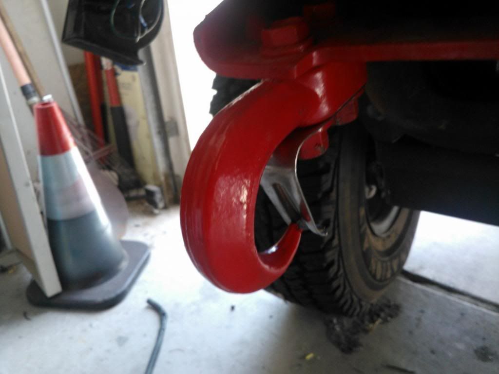

was at the junkyard yesterday and found a couple spring clips for my tow hooks. 50 cents a pop! little rusty, but nothing a wire wheel couldnt fix. for those of you that dont know, they keep the strap from falling off the hook.

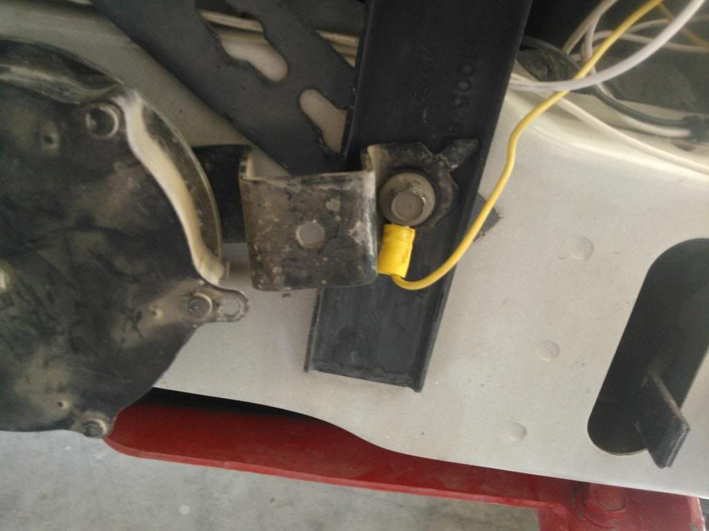

also found out why my aux lights werent working. the ground wire to the relay somehow broke. added a new one and they work now.

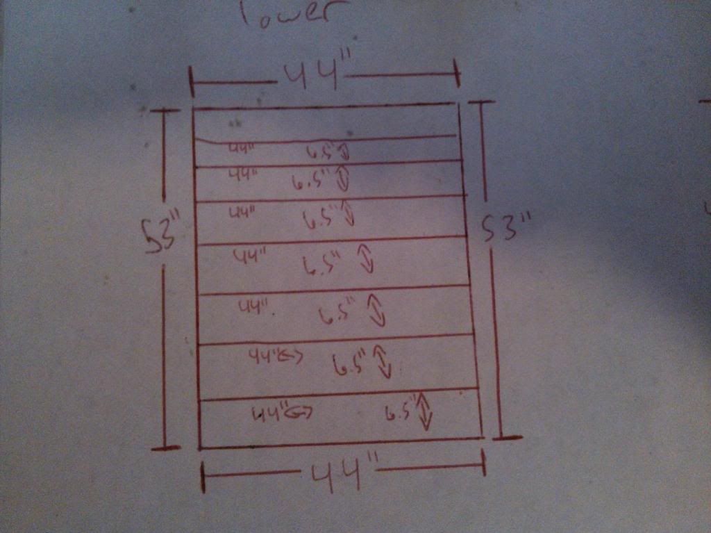

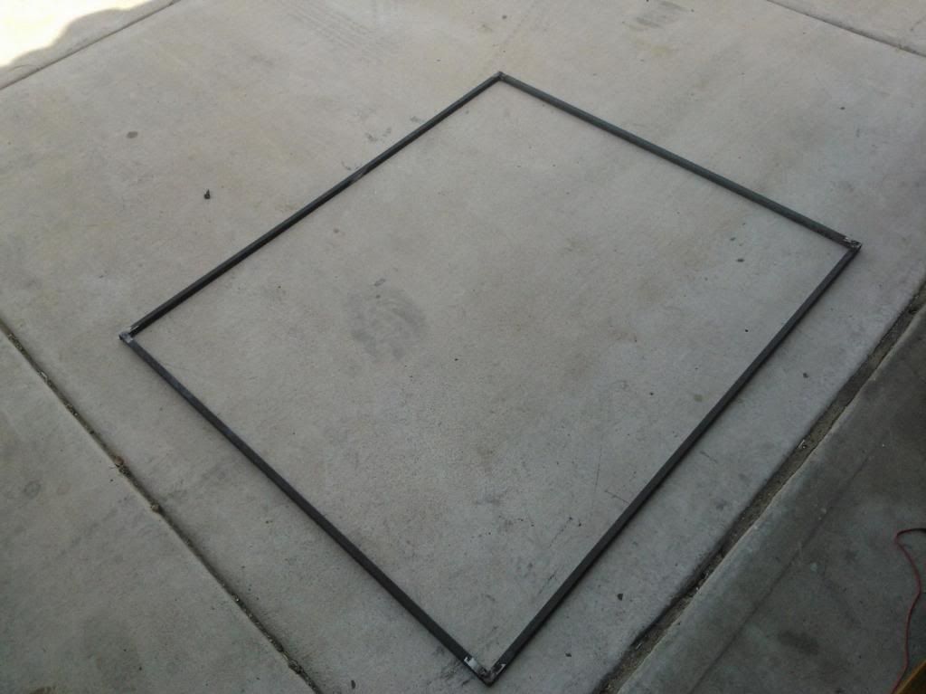

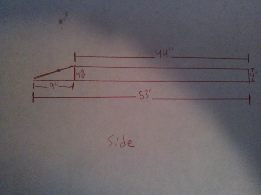

roof rack build
started building the new rack.

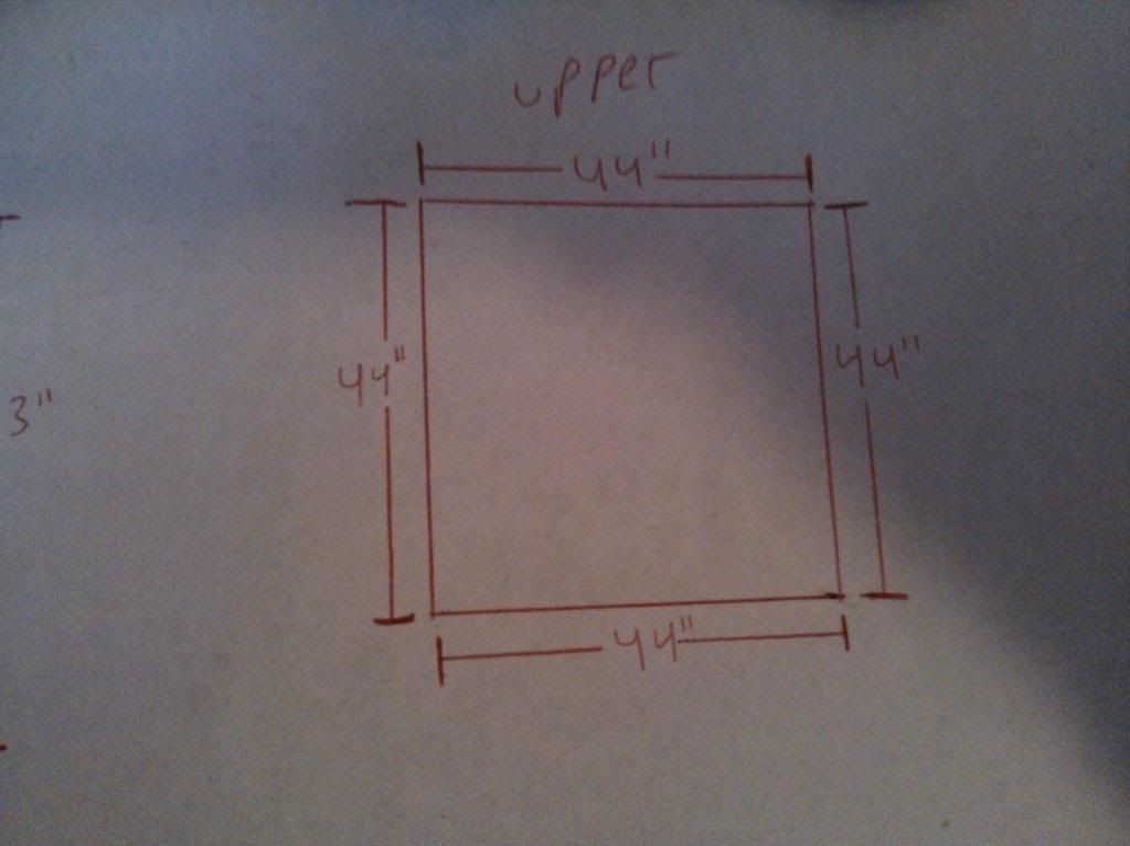

heres some of the drawings i made
bottom part of the frame done

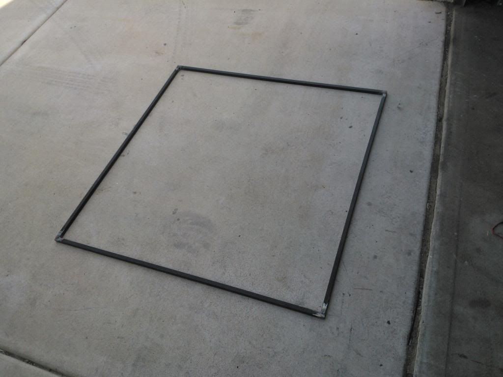

top part done
hopefully ill be able to get that piece of fence from my buddy on monday (hes on vacation this weekend). after i get that, this should be build pretty quick. then ill just have to go to walmart and get some flat black krylon. same paint i used on my wheels, i like it because it dries really really fast (fast enough that when i painted my wheels, i could paint one wheel, paint another one, and go back to the first one for a second coat. just like that, no delay) and it covers really well.

and yeah i know that im my first drawing, 6.5" x8 doesnt equal 53", the cross bars will be slightly more spaced out than 6.5", somewhere around 6.6" is about right. obviously it wont be perfect, since im just kind of eyeballing it.
