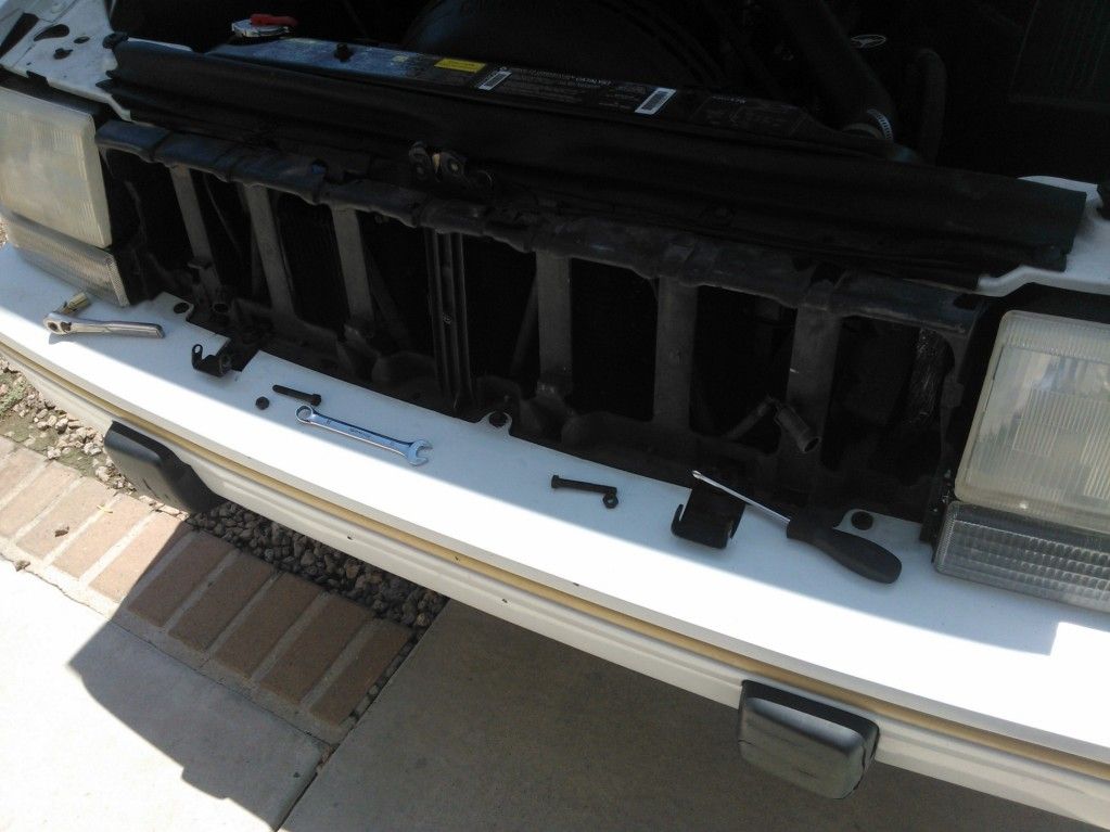

Made a bunch of progress today. I went to Pick n Pull and luckily they had 3 ZJ's to take parts from, two 93 grand wagoneers and a 96 limited.
I was missing the "J" from the front emblem, so I pulled it off the 96 Limited and stuck it in my pocket.
My emblem:
New emblem:
Cleaning off the old tape:

Got some fog lights for it
Wired up with factory connectors
Setting up the brackets
