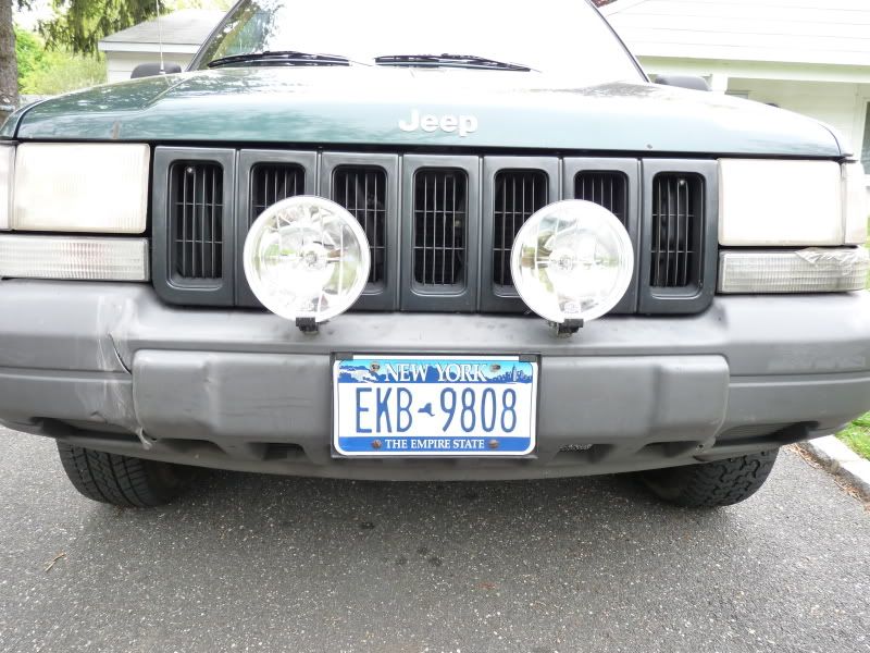

Installed my Hella 700FF lights and took off the side cladding. I got it washed right after I took them off, but it's going to need a good compounding and waxing to come out nice. But still looks a lot better. The lights aren't wired yet, and one thing that I don't like, is thy are REALLLYY wobbly on my bumper, but I'm dealing with it for now.

Wobbly on your bumper? You mounted them to the bumper cover I take it? Take off the cover and make some L brackets and mount them to the steel bumper behind the cover. It only takes a few minutes to take the cover off.
didnt really think of that. and yeah apparently the previous owner didn't like screws. because NOTHING was holding on the bumper cover. I took it off to mount the lights, and there was ONE screw holding the bumper on. other than that, it slid into those bolts on the side of the fenders. I made a few of my own screws on the top of the bumper to make it a little more stable. How would I bolt down the L brackets? I guess I could bolt the bracket to the steel bumper, make the length perfect where the brackets of the lights are, and just bolt it through the cover and onto the L bracket?
thanks for the idea i give you

Stock brackets come up behind and over the bumper cover. Not mounted to it at all so if you the take cover off, the lights stay mounted. But, seeing as you already drilled it, You'd prolly be better off still having them bolt thru the cover. Unless you want to run without the cover or get a new one from a boneyard.

I work for a guy who sells jeep parts. so i'll just end up getting one from him, if i want to. but I'm just going to mount them through the bumper cover so it's definitely not going to fall off the truck lol

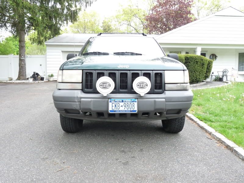

They look nice mounted there! Did your temp increase at all?
I have the same lights mounted on a Safari Bar.
I run the covers on them unless I am going to use them. I am thinking of blacking the covers out though. The white just looks hideous. How do you plan on wiring them? Mine are wired to come on with HB only. Comes in handy for the long stretches of back country roads around here!
