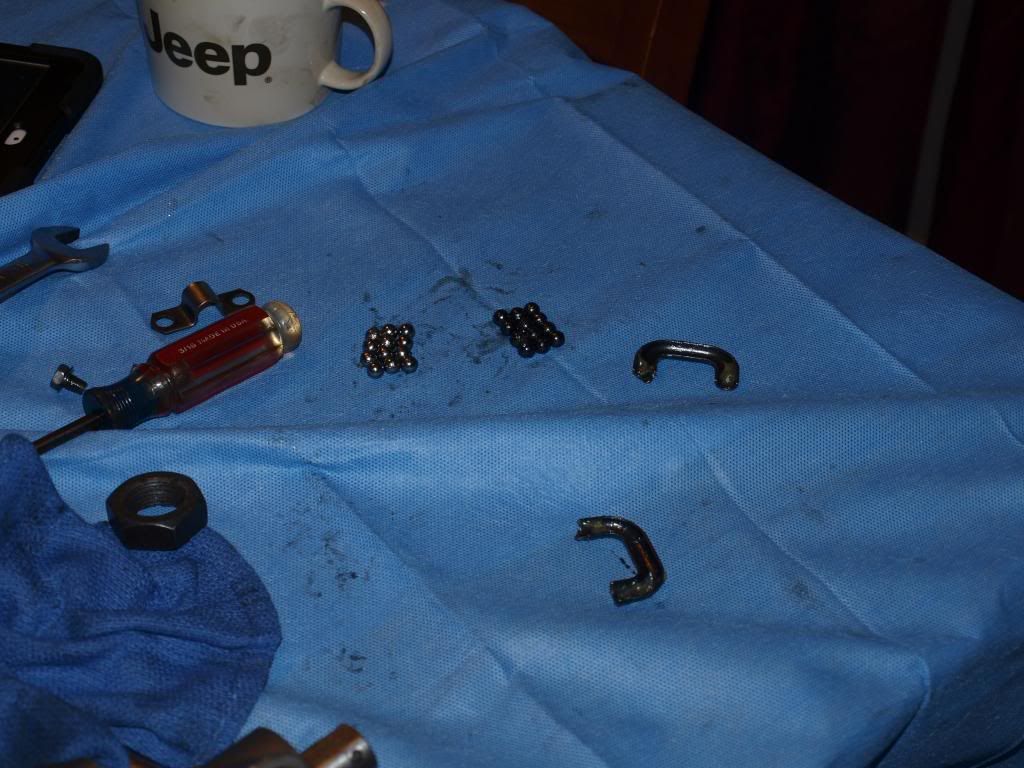

I finally finished rebuilding my steering box and got it back in the jeep.[URL=http://s1234.photobucket.com/user/Ez_pen/media/P6094991.jpg.html][/URL[URL=http://s1234.photobucket.com/user/Ez_pen/media/P6094990.jpg.html][/URL
I had to take out the balls and reset them a couple times, cause you have to set every other color. Having bearing grease helps a lot in putting it all back together. I also had trouble with the main piston seal, make sure you have ps fluid by you during the install.

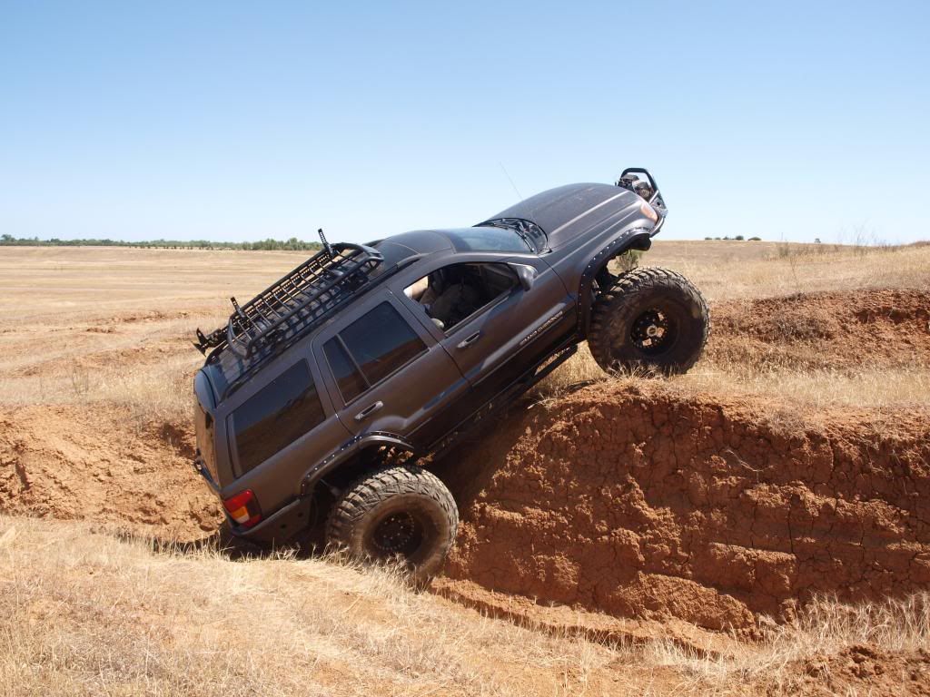

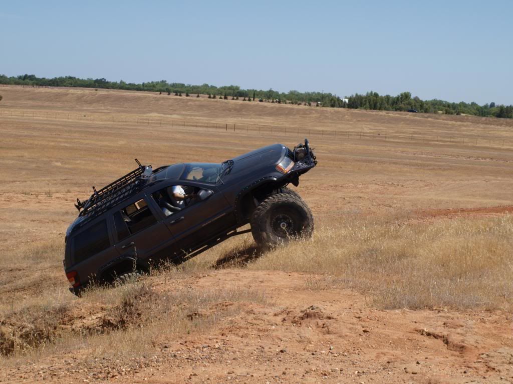

I finally took it off the drive way and played around for a bit. This climb is much steeper than it looks, with loose dirt.
I tried to make this but after my wheel came off the ground my pregnant spotter told me i was done, so i will have to save it for another day.

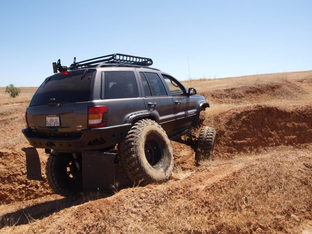

I forgot to take my mud flaps off again. And broke one off again. My back tire tucks a little bit now that i trimmed and put on the flares. Im still happy with the leafs and the steering is working great

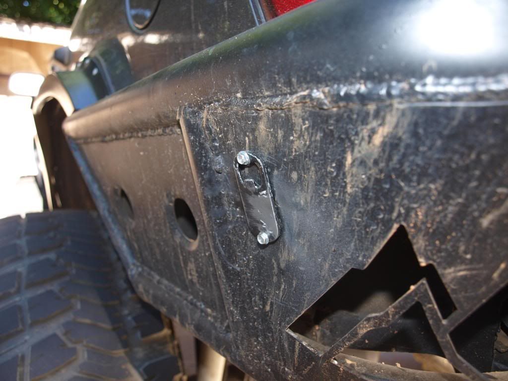

I added this to the rear bumper cause it was easy and very useful.
