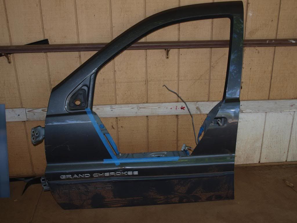

I got a chance to start some half doors. I really need better visibility and like what gcjeeping did with his so heres the start of my version. I would like to do padded arm rest and cup holders. I used pop rivets to put on an inner skin/panel, and i still need to figure out what i wanna do for speakers. I might make the arm rest part removable or hinged so i can use the inside of the door for storage.[URL=http://s1234.photobucket.com/user/Ez_pen/media/P6275247.jpg.html][/URL

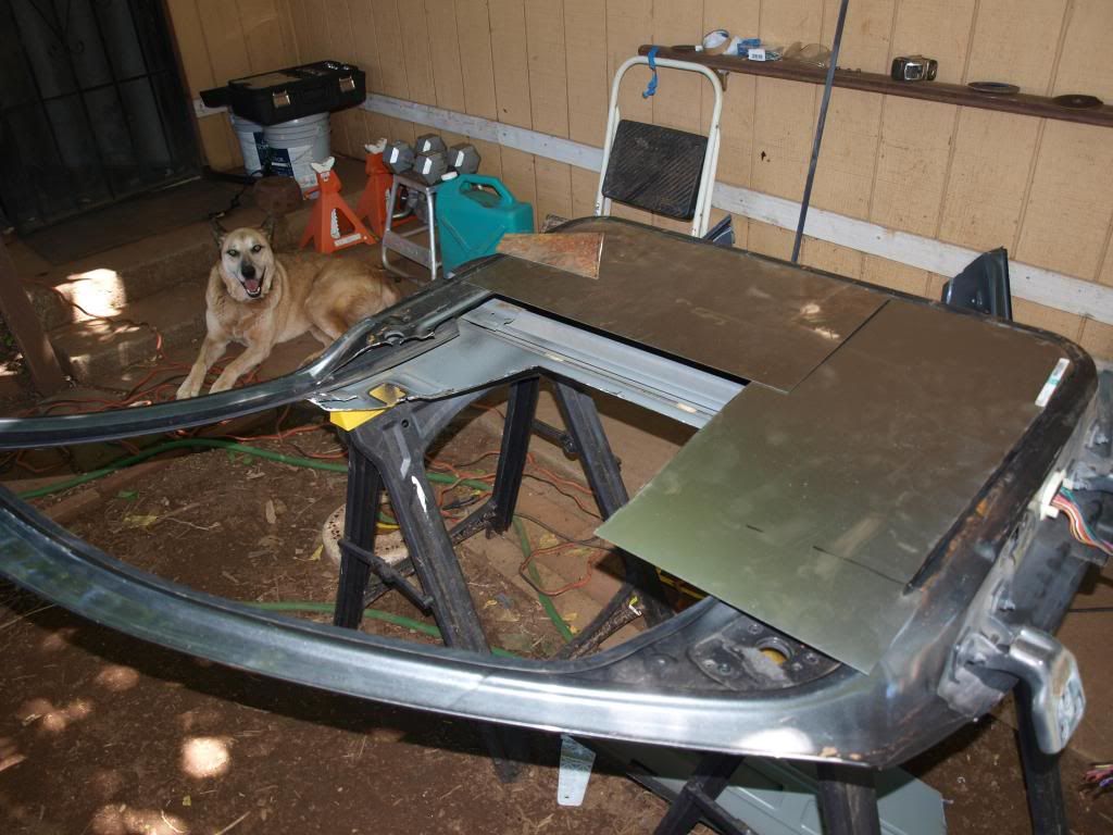

How it sat right before i preped it for welding. Any ideas or suggestions would be appreciated.

Thanks! This project can be done without a welder, and I believe it could look really good with less clean up. Just use pop rivets and/or sheet metal screws.

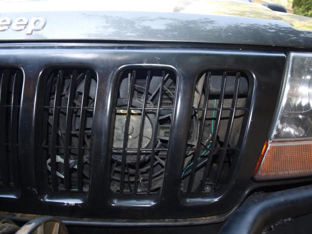

I picked up a small fan from a toyota at the junk yard but after putting it up to the jeep I realized i would have to make alot of changes to my front clip and hood latch and power steering cooler lines. So i took it back to the junk yard to see if i could find a better fan. And i did, its out of a trooper i think, about 10x10x2.5 single speed with lots of power. I installed it last night and wired it this morning before it got too hot. I had to modify the front clip just a little bit. And i wired it to a switch in the cab. Time to go try and over heat[URL=http://s1234.photobucket.com/user/Ez_pen/media/P7015258.jpg.html][/URL

Marc I have a Taurus fan I didn't use, you can have it if you wanna drive to oroville. Is there a fast route from grass valley to LaPort? Cause I will be camping in that area on the 12th, and could bring it with me. On cold days my temp stays a little lower than 210, on hot days it gets up to 220 with the ac on full power. I did about 30 min of freeway driving today and kept the temp around 211 with the ac turned up and 105 out. I'm not sure if that's good or bad for a wj but next I'm adding some hood louvers to get the hot air flowing out of the engine bay.
