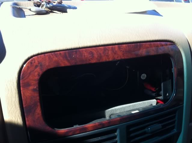

one thing thats always bugged me (ocd) about my WJ is that there was a big panel gap between the radio bezel and the dash... looked like this:

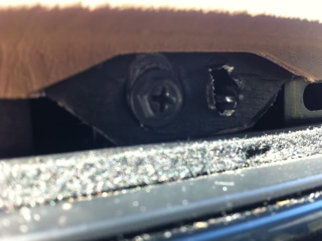

so I pulled the bezel off and found a nice little screw:
and I loosened it and pushed the dash plastic up as high as posible and tightened the screw down tight
which in turn pulled the dash covering down tighter to the bezel. I notice the difference every time I get in my WJ now and it makes me much happier lol

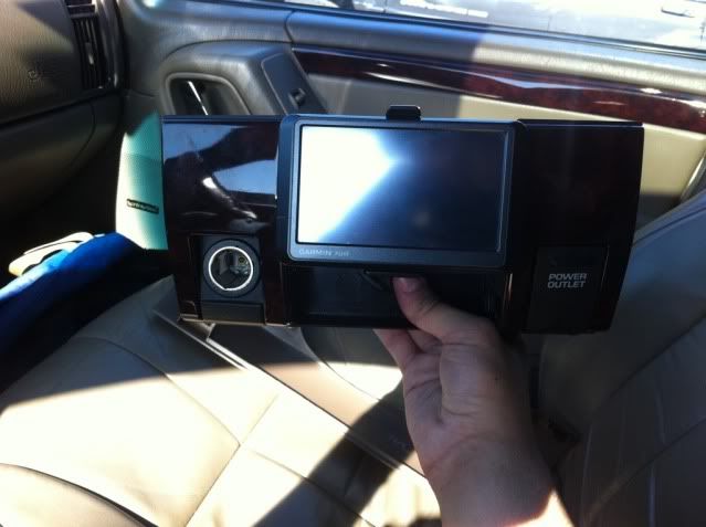

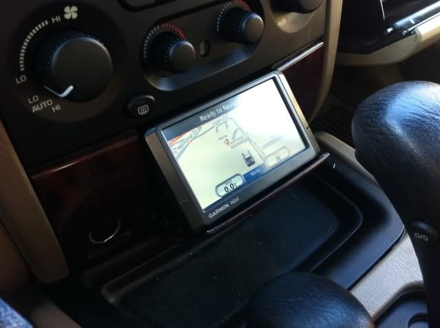

Then I was bored and thought about how useless my ashtray was to me... took it out and thought about mounting my GPS like this...
which looks cool but I found out this was much more practical (I can actually see the screen) and I can still use the ashtray for storage. Pull out the top metal part of the ashtray opening (unscrews with two small torx screws) and the wires can run straight into the dash to a switched ign source

Thats a pretty sweet little setup for your garmin bro!!! I like it!!
