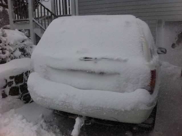

Got alot of snow at home
Gave it a snow mustache
