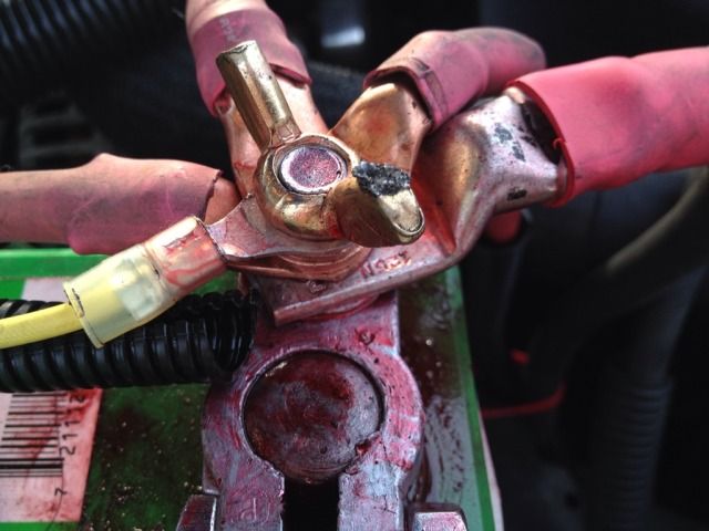

Roommate was doing battery cables so I did too... Ended up completely gutting the factory high current harness and rebuilding it from scratch routing it differently under the battery tray
Edit: alternator now runs to battery with 1/0 was 6awg to PDC. Starter now runs to battery with 2awg was 6awg, PDC now runs to the battery with dual 6awg (temporary till I get home) and the block is still 6awg to the battery. Body ground runs to battery with 1/0 was 6awg. I ran out of wire and have a ton more at home which is why the PDC and block grounds are the way they are. I did duals on the PDC to account for having the alternator going to the battery and not directly to the PDC but that will be replaced with 2ga and the block ground will be 1/0. I eventually wouldn't mind doing the starter to 1/0 but that's a Long run and I had a lot of extra 2ga laying around. Everything professionally crimped and heat shrunken and wire loomed with what I had left ill be cable managing some more lately but rerunning everything under the battery tray cleaned that area up real nicely. Jeep started AWESOME when I tried it out and that was a cold (well hey it was 70* out) so I imagine she's much happier now that old wiring was crap and thick stranded in comparison I used weld cable for the 1/0 and Ancor brand marine tinned copper for the 2ga. Used my portable field crimper and adhesive lined heat shrink everywhere. Very happy with the results. Oh and now both terminals are marine conversion posts I'll be replacing the wing nuts with regular nuts soon

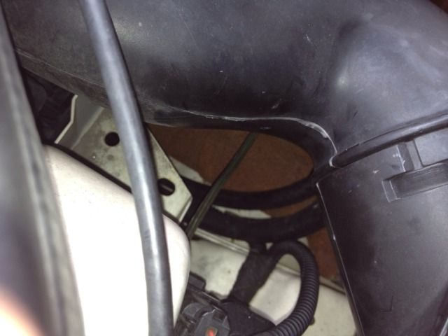

Got my Trans Cooler Installed. plenty of pics for all of y'alls. So I started by pulling off my lower front suspension skidplate, you guys may or may not have this. Then I had PERFECT access to the tranny cooler lines its almost like they were ASKING for me to do this mod because they put a small section of soft line in between two hard lines with easy little constant tension clamps.
So just squeeze the clamps and slide them to the side
Then get a drip pan underneath and get that old soft line outta there. Channel locks and some twisting and elbow grease and they pop right off. Will drip a tiny bit of ATF... Mmm nice fresh red looking ATF
Then get your new cooler set up with hose and everythin hooked up to it. I needed the length of hose it came with (bottom) plus an additional 5 ft from AAP for a couple bucks (top). Hose clamp and tighten well, you dont want this popping off.
I skipped a couple pics but basically take your grille off and maneuver it in between the plastic header panel slats and into place where you want it. If you're having trouble... heck... just snip one of the slats its not going to be a big deal. Then feed both hoses through the side rubber insulating flap towards the air box... they'll come out near the power steering box
Then I slipped some wire loom on the hoses, wrapped in electrical tape, and fed them in front of the power steering box as follows. I did the wire loom for any kind of chafe protection. I strongly suggest this anywhere you can even think of it chafing. You should now be able to reach up near the lower radiator hose and find these lines and pull em down.
Now. The hose coming out from the bottom of your new tranny cooler should hook up to the radiator side of the factory cooling pipe just like this. This will take the fluid after its passed through the factory radiator cooler and then bring it through your aftermarket cooler
Now that the hoses are routed cut off any excess you may have. The hose coming from the top of your new transmission cooler should go to the transmission end of the line you pulled in the beginning. This is the fluid return line to the trans so its being fed nice freshly cooled fluids
I then zip tied the cooler to the center radiator support poles because that seemed like the best feasible location. It'll get good airflow and its not touching the factory radiator or AC condenser.
Now check everything and take the Jeep for a nice test drive and then check the fluid right when you get back... it may have dropped a little bit and need some.
And THEN... during my test drive my Jeep shook and the gauges sweeped and did a reboot and I panicked and upon popping the hood noticed my positive terminal must have bounced up somehow and burnt through the hood insulation and shorted.
So I replaced the tall wingnuts with regular Stainless steel nuts and added an extra strap down for the battery until I get a REAL proper sized battery, y'all may have noticed I have an XJ battery in my WJ... grandmas mechanic put the wrong one in when she had it replaced a couple years back

Edit: Pictures look good on the transmission cooler. Glad you got that installed. I may hold off on mine now since the Factory cooler should be fine for now. =/
Sucks about the wing nut man. But you put one some serious ring terminals! As per your pictures you do not have nearly as many threads as I did on your bolt for the terminal. That must have been why your wing nut hit.
