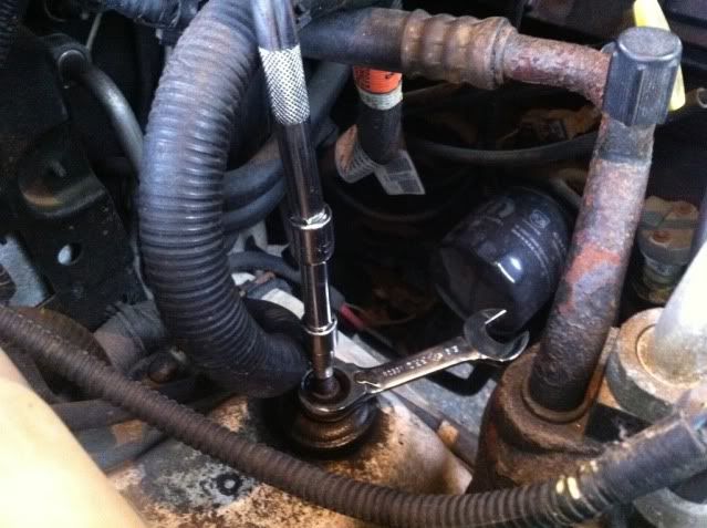

Alright all of you in "What did you do to your WJ today" tempted me to do the fuel filter so I finally did. $30 purolator unit from AAP did the trick. Funny actually the rusty metal fitting gave me the least trouble. I used my panel trim tool as a crowbar and it did a godly job. Dumped a LOT of fuel all over myself though The female fitting on the filter next to the rusty metal one was hella easy too, Just squeezed the plastic tabs and wiggled it out. The last one on the other side was a royal pain and required me holding the tabs with needle noses and using a flathead as a pry bar against the needle nose. It took me a while. Anyways pics... Filter off:
and then the two side by side. The old one was original mopar one so after 100k miles I'd say it needed to be changed
And the new one went in amazing, the quick connect fittings clicked in firmly and I bolted it back up. While I was down here I also noticed one of my evap lines was almost completely disconnected... HMMM. Slipped it back on tight we'll see if my CEL dissapears.
The Jeep runs AMAZING now that I did this. My vibrations at idle are gone, the engine starts much faster, my idle is down to 650ish really smooth and quiet, and the throttle response is amazing! There used to be decent lag between pedal and rev but now its really responsive! Well worth $30. I cant make a big comment on mileage but so far my instant is showing 2mpg better doing 50. I'll tell for sure on my ride home in 2 weeks.

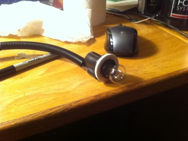

Thanks man, I appreciate the positive feedback. Thanks for reminding me I coulda sworn I did a writeup but I cant find it anywhere so I guess I didnt. I took a bunch of pics so I'll go through the process for ya.

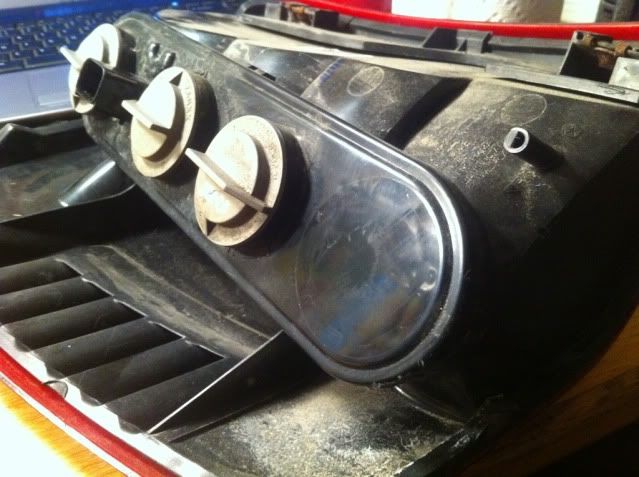

In europe WJs are required to have rear fog lights. This design was implemented into all WJs and our American WJs just have a plastic covering over where the fogs would normally go. So we just buy bulb sockets and new bulbs from auto store, cut a hole, and mount the new light where the euro fog lights would normally go. When you wire them to the brake/tail lights with a dual filament bulb they act as a second set of brake and tail lights. They look unique (sets you apart from the other WJs) and in my eyes its a great safety improvement at night for visibility.
First you get you taillights out of your Jeep:

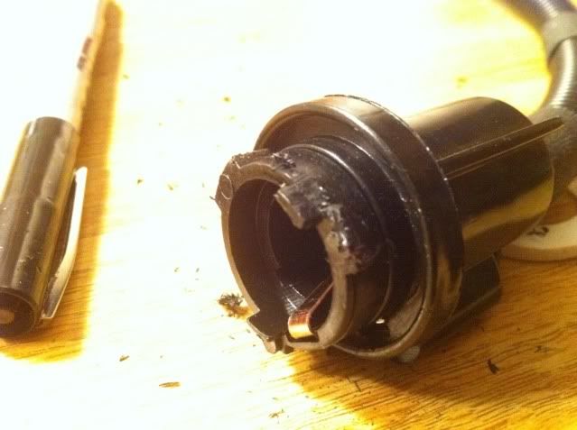

These are the sockets I bought from Autozone. I had to file down a weird tab that was on there. Then I added some wire loom to clean up the wires
Heres what it looks like with the bulb in:

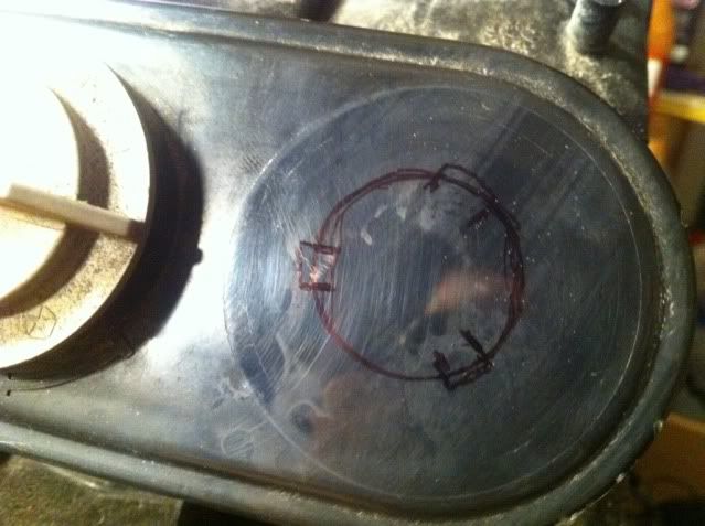

Then use your sockets you buy to make a cutout template and trace it on the bottom of the taillight here:
Carefully cut the lines with a dremel tool

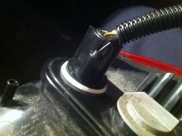

Firmly push the socket in and twist it till it locks in place or is secure
I believe the factory wiring is as follows but Im recalling this off the top of my head so im not positive (bad pun I know) black is ground, white and tan is brake +, and Im pretty sure black and orange is tail +
your socket you buy may vary I thiiink mine was black-gnd, brown-tail, yellow-brake.
Annnnd voila

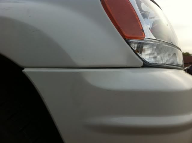

mesanwhile.. I've fixed my front bumper cover, it fits up to the fender nice and tight with my new clip in the right hole

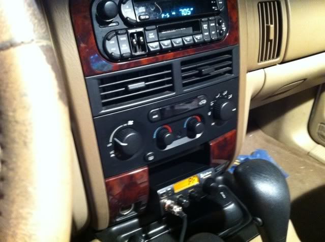

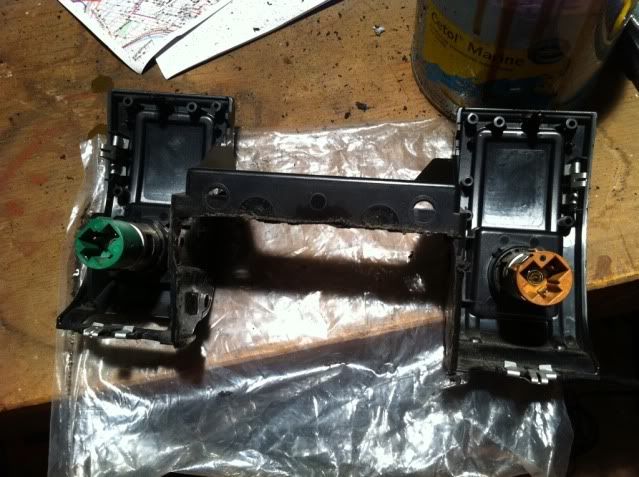

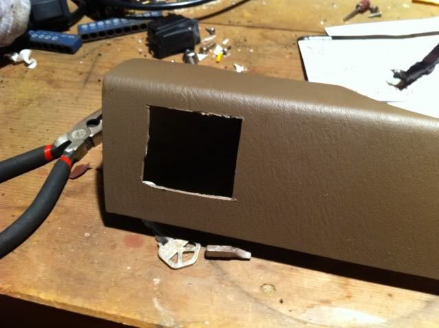

Modified the ashtray trim like so...
To fit in my new cobra 19 I snagged at wal-mart of all places on the CHEAP!
Did some dremeling to my steering wheel/cluster trim
To fit my new contura rocker switches. Perfect location, best I could find, feels very natural to use them. One is a kill for my radar scanner (gets annoying) and the other is for my CB. I'm going to add more eventually as I get more accessories.

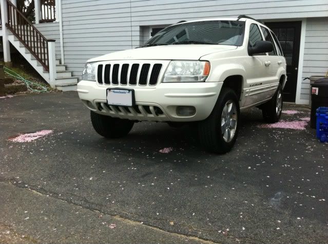

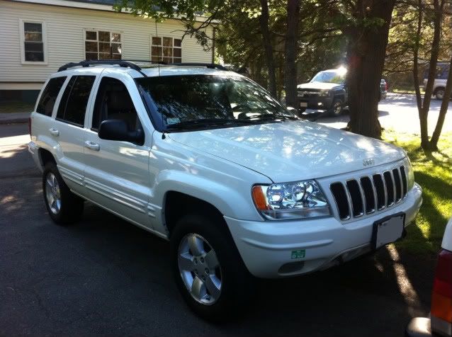

Here are a couple exterior shots
After claybar, polish, and wax:

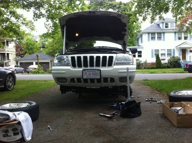

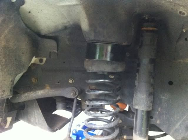

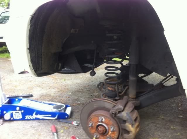

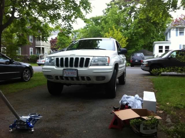

Found some pics on my phone from the lift install:

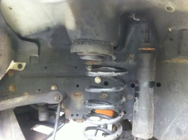

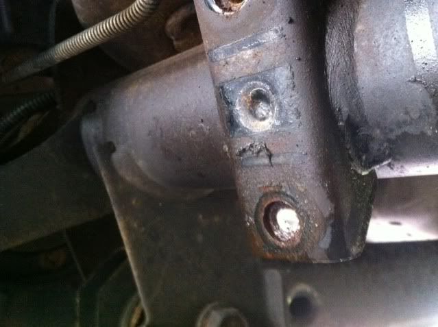

dropping the front spring
closeup
oh noes, where did the wheels go
using a jack and my foot I was able to bring the axle down enough to slip the spacer in
YAY!
this is how I had to undo the shock, it was a complete pain in the royal butt
My racing Jack made childs play of this job
lift done
those are all the pics of the lift I could find, I didnt take as many as I wanted to, oops oh well.

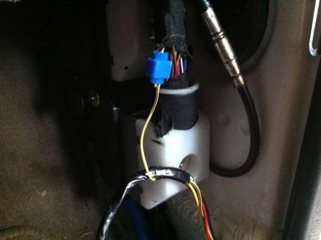

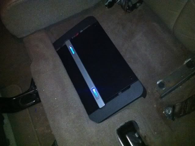

Oh and heres some pics of my sub amp install

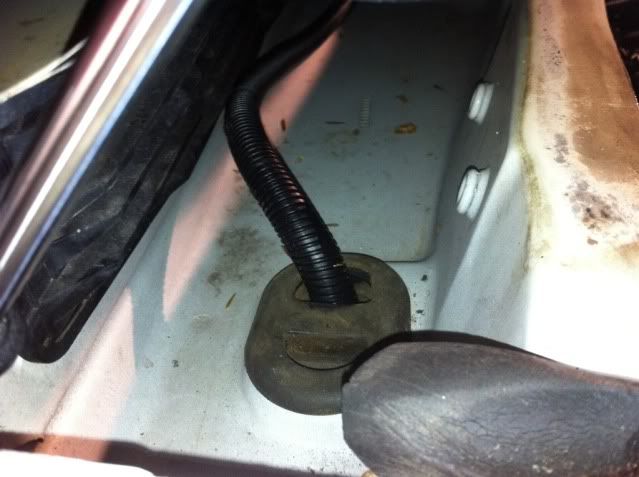

in the engine bay wiring goes up to this grommet
runs across underneath front hood cowling
goes through grommet at other side which drops it behind the ecu
where its then easily routed to the battery
Wires run
Ground to seat bracket
where I tapped factory wiring
my tool of choice for... adjusting, the seat area
what it was
what I made it
how everything looks connected. clean and sleek

Nice! At least your front shock bolts are placed better than mine (one next to the coolant bottle, one under the master cylinder)!
Just don't try changing shocks in a parking lot without any jacks, etc, and you'll be good (takes forever).
